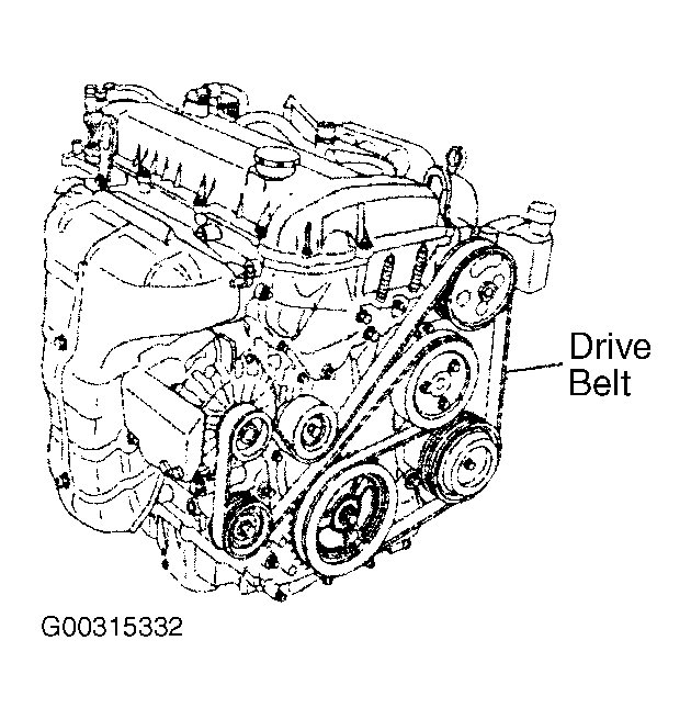

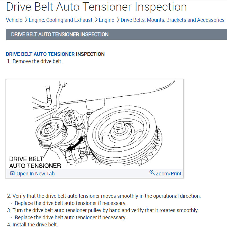

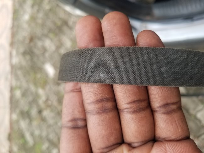

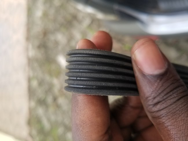

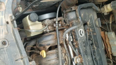

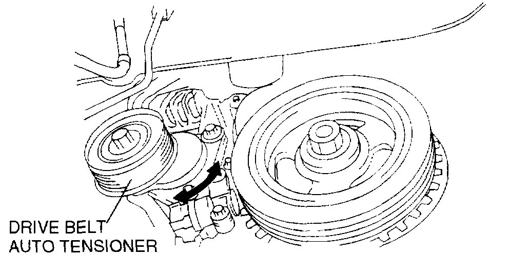

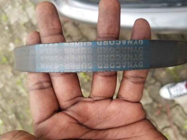

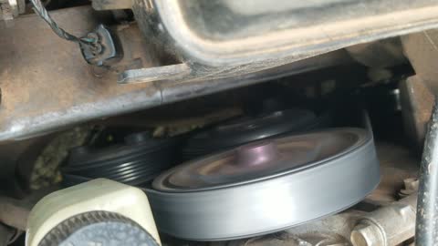

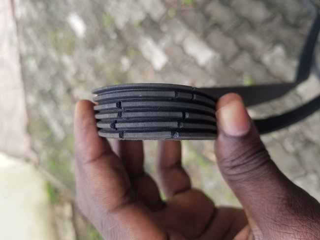

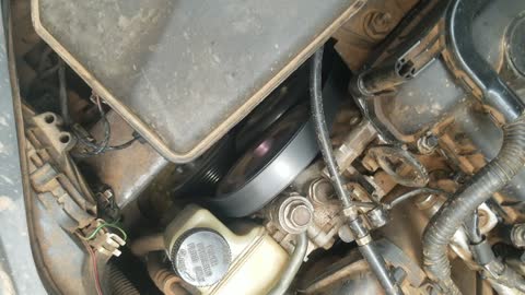

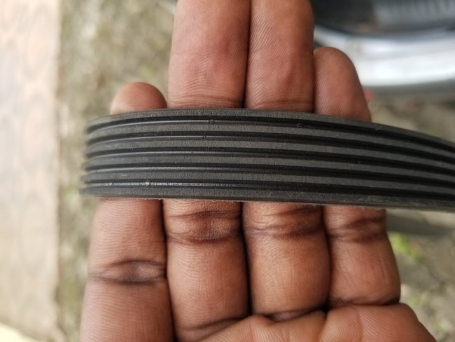

My serpentine belt squeals at startup, it squeals when I put in reverse or drive but stops immediately I start to raver (drive away), when my A/C in turned on it squeals even louder while on idle but stops immediately I start to drive. I have replaced the steering pump, water pump and tried a different alternator and a different A/C, i have also replace the bearing for the pulleys of the idle pulley and tension, I replaces the belt on the car which was measured to be 6PK2275, I tried a smaller size 6PK2265, i went as far as trying another smaller belt 6PK2260 which was too tight.
Like I have mentioned above, I have all mentioned. Please help me. what could really be the problem?
