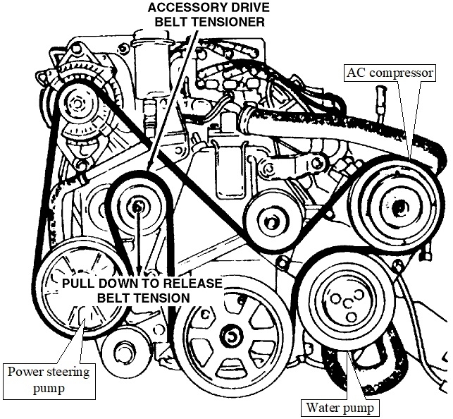

There's no practical way to bypass the compressor because that would also eliminate the water pump. You would have to design and build some type of substitute pulley and mounting bracket, but I wouldn't trust that any further than you're willing to walk back home.
The only way the AC pulley will cause the belt to be thrown off is if the bearings inside it are worn or broken apart. You'll see that as severe wobbling when you spin it by hand. If those bearings were to lock up, that would simply cause the compressor to run all the time the engine is running. It would never cycle off periodically. If the compressor itself is locked up, you'll hear horrendous screeching when the clutch cycles on. The belt might slip over that pulley, but more likely the clutch will slip and get real hot. That would only occur when the AC or defrost functions are selected. To prevent the clutch from engaging a locked-up compressor, just unplug the two-wire connector behind the clutch / pulley assembly. You could also unplug the compressor relay in the under-hood fuse box, but the Engine Computer will see that and set a diagnostic fault code. That should not be an emissions-related problem, so it shouldn't turn on the Check Engine light, but if it does, since it will always be on, you'll never know if a potentially more serious defect is detected. Often minor defects turn into expensive problems if they're unwittingly ignored by a Check Engine light that's always on.
By far the more common suspect is the belt tensioner, as your seller suggested. They rarely lose their tension on the belt. It's more common for the pivot to wear, then the arm and pulley sits at an angle. It's no longer perfectly parallel to the belt and the other pulleys. When that is not too severe yet, that will set up a belt squeal because the belt is sliding across that pulley as it goes around it or the next one in line.
The way to identify a worn tensioner assembly is with the new belt installed and the engine running, sight down from on top, through all of the pulleys. You should not see the belt peeking out to one side on any of the lower pulleys. When the tensioner is worn, you'll typically see as much as 1/8" of the belt, or about one groove worth, out further compared to where it has just left the top of the alternator pulley. That is proof of the wear, and that will allow the assembly to vibrate at certain engine speeds. That's what throws the belt off, then it can get tangled in any of the other pulleys.

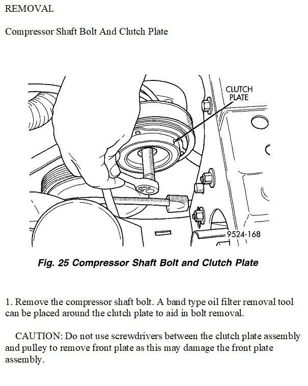

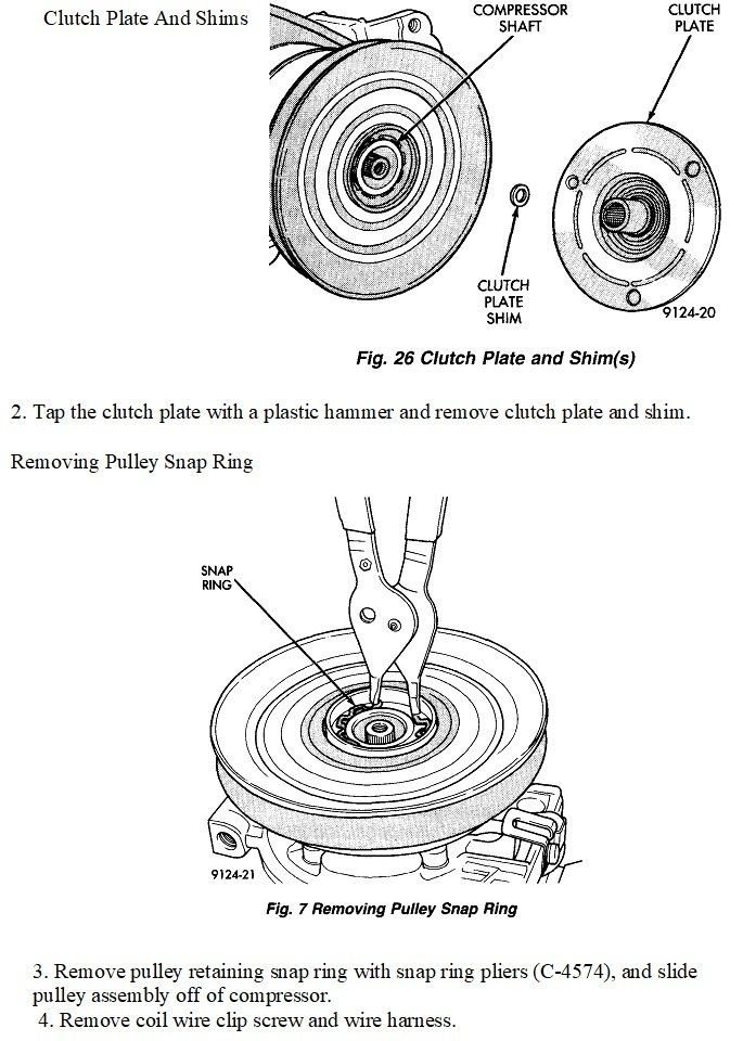

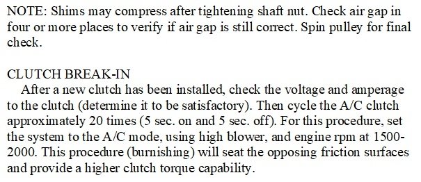

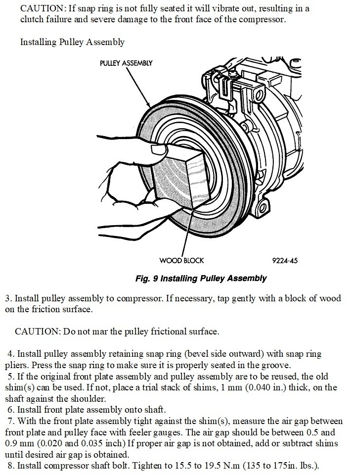

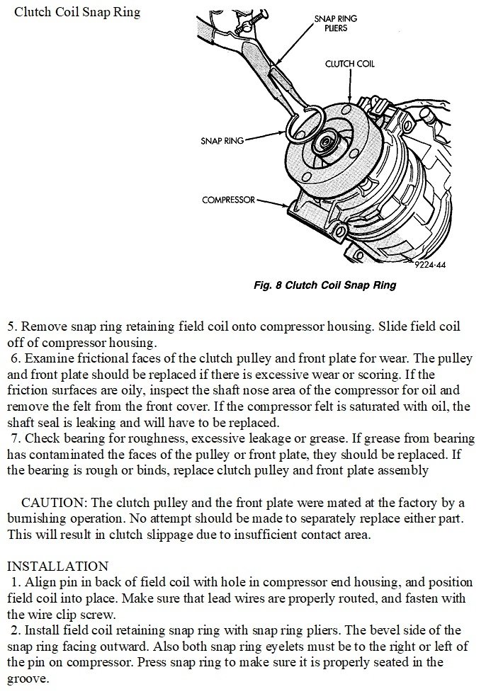

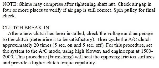

There's no instructions listed for just the compressor pulley. I did find these for the clutch coil. You may be able to use the pertinent parts of this. If you need special tools, you can often find them at auto parts stores that rent or borrow tools. In my city they make you buy the tool, then you get a full refund when you take it back. If you choose to keep a tool, you still return it, then they give or order you a brand new one.
If you need to replace the tensioner, it will make more sense if you have the new one to look at first. It's held on with a stud with a 15mm nut on the back side of the mounting bracket. I do know that on my Dynasty with a 3.3L engine, that nut can be accessed from over the top of the bracket while leaning over the right fender. You may need to get at yours from underneath because the engine sits back further. Also, you may need two different wrenches. There's a limited amount of room to swing the wrench. You might not get it to turn far enough to get another bite on it with the same wrench. To do these at the dealership, I used a Craftsman box wrench and a borrowed Snapon box wrench. They were different enough to turn the nut about one turn to loosen it, then it can be spin off with your fingers.
You'll see a tab on the backing plate on the assembly that must sit in a hole on the mounting bracket. Be sure that drops into place so the assembly sits flat on the bracket. This is actually a much easier job than first appears, but getting to the nut might be difficult if the van isn't up on a hoist.
