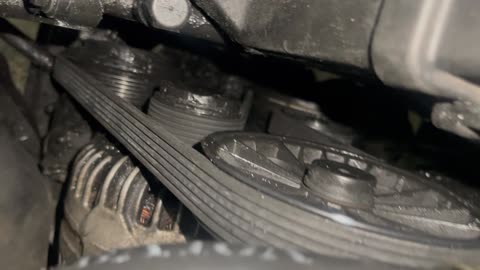

I had a smooth drive home on my vehicle listed above 2.5t and i rev up the car on park only for the car to shut off and all the lights on dash boards came on, it gave a whining roll and won’t start back on, stepped out to check, found out the serpentine belt cut and got shredded. I changed the serpentine belt but still the car won’t start, keeping giving a whining sound. Everything connected on the serpentine belt turns also the timing belt rolls. I am not sure what the issue might be. Check the compression electrically its reading 120-160, the fuel supply is good.

From the description it sounds like the engine does turn over when you turn the key, but it doesn't actually start and run? If that is the case and the accessory belt had shredded, I would look for damaged wiring around the area where the belt runs. It would be easy for a small of belt to have pulled some wiring free as it flailed around. If you find some, repair it and see if it now runs.

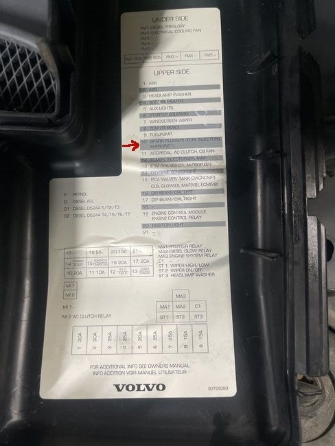

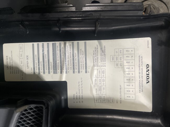

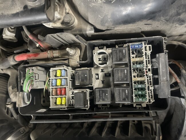

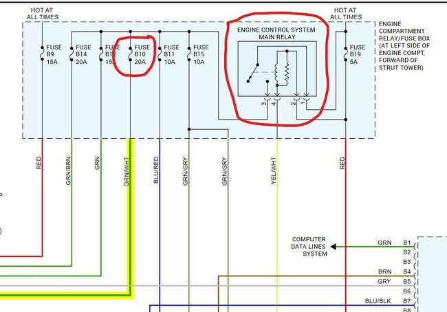

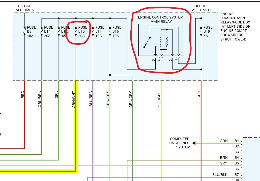

Yes, that would cause a problem. I would take a test light and use it to check the fuses and relay that powers the coils and more. Fuse B10 is the power fuse for the coils. The relay that powers it all is there under the hood on the left shock tower.

IFE D
  • 13 POSTS
Which is it?
Jun 11, 2024 at 4:06 PM
IFE D
  • 13 POSTS
Picture.
Jun 11, 2024 at 4:09 PM
STEVE W.
  • 15,113 POSTS
That is the fuse.

IFE D
  • 13 POSTS
I don’t have a tester but i look at all the fuse but none looks blown.
Jun 11, 2024 at 4:42 PM
STEVE W.
  • 15,113 POSTS
Just looking at them doesn't tell you if there is power at them though, that is the idea behind using a test light. You can make one easy enough, a replacement light socket with extended wiring to use as a test light.
Jun 11, 2024 at 5:46 PM
IFE D
  • 13 POSTS
I have checked it all and there is power in the fuses. I don’t know where else to look or what else to do?

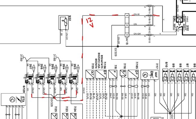

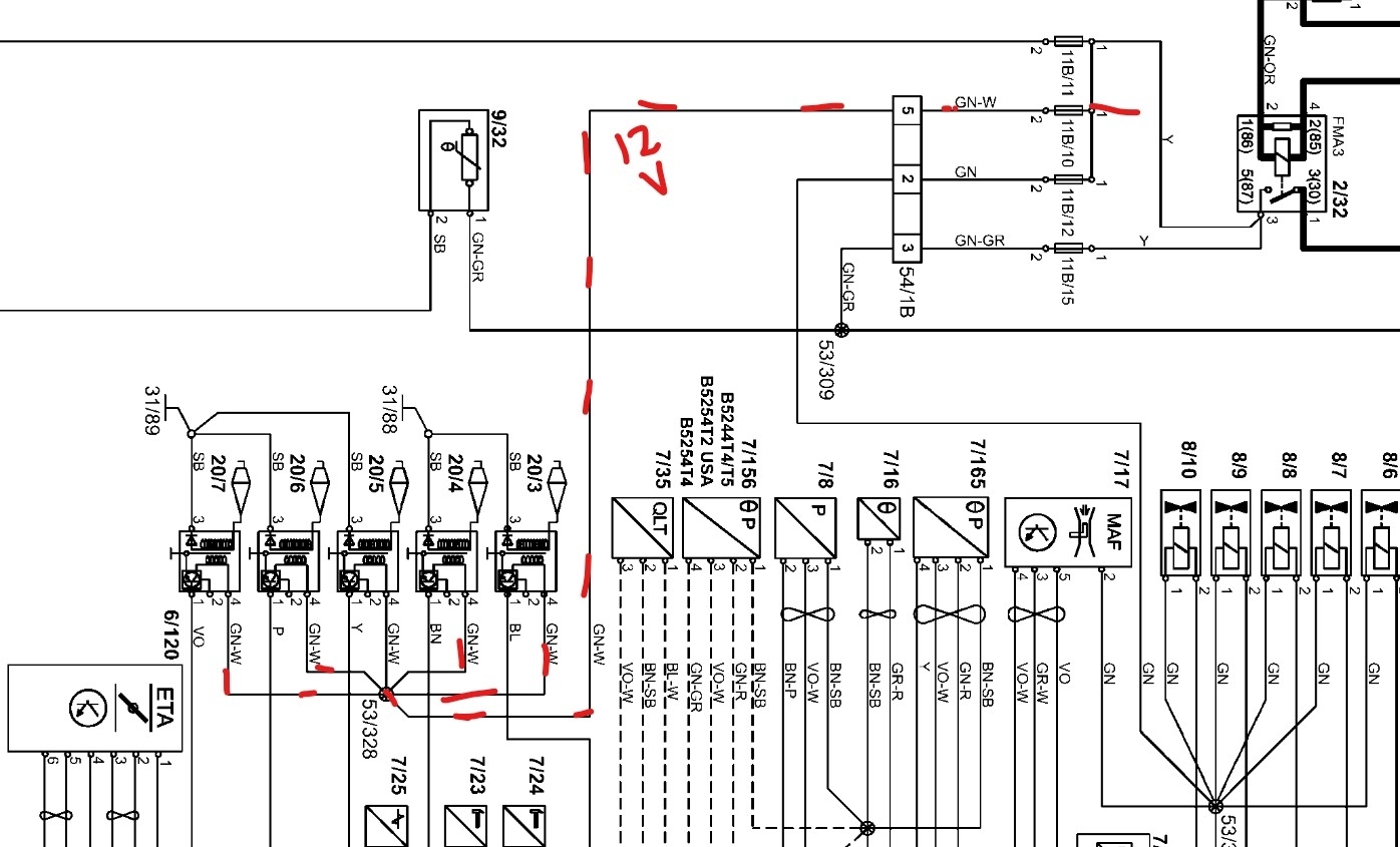

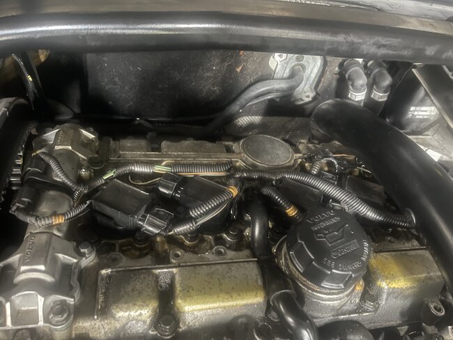

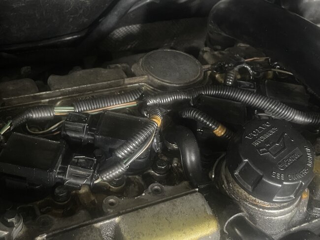

Okay, turn on the key and check at one of the green with white wires at any of the coils, is there power there? If yes then the mechanic was mistaken, if there is no power to those wires then you will need to trace that wire back to the fuse box as it's broken. Or if you want to see for sure, just connect a jumper wire between one of the green with white wires and battery positive. If it now starts you know it's in that wire between the splice and the fuse box. The diagram shows the power feed with red noting the path That is the green with white wire.

IFE D
  • 13 POSTS
Which is the green and white?
Jun 13, 2024 at 10:04 AM
IFE D
  • 13 POSTS
STEVE W.
  • 15,113 POSTS
You need to remove the plastic loom to get to the actual wires under it.
