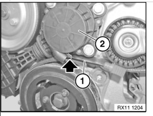

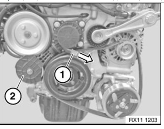

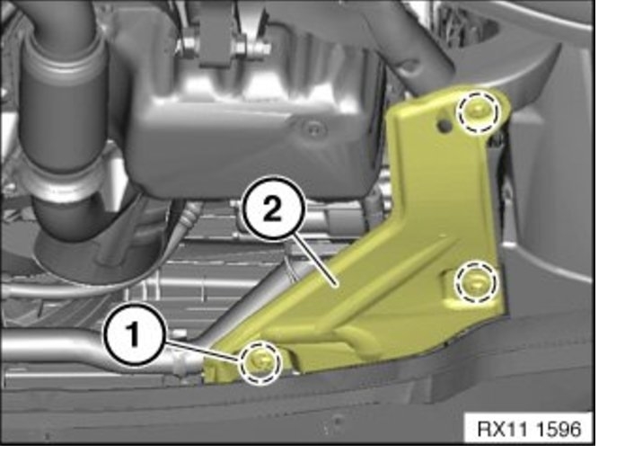

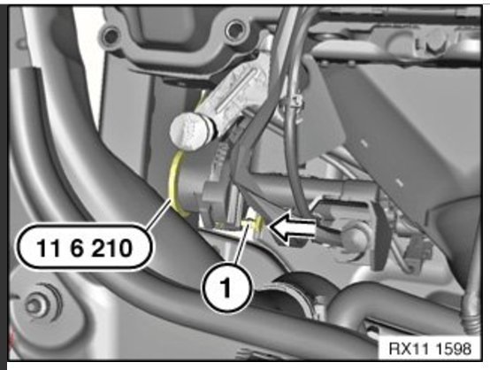

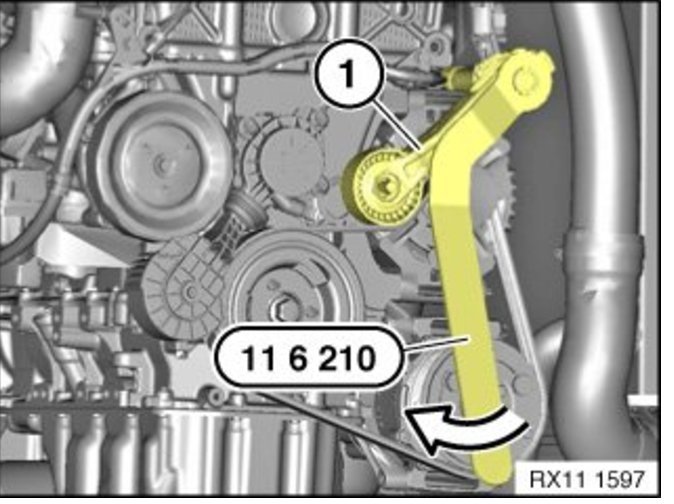

Here are some diagrams on what its like on your car. (below)
It says you need a special tool but it looks like a 1/2 inch ratchet will work.
