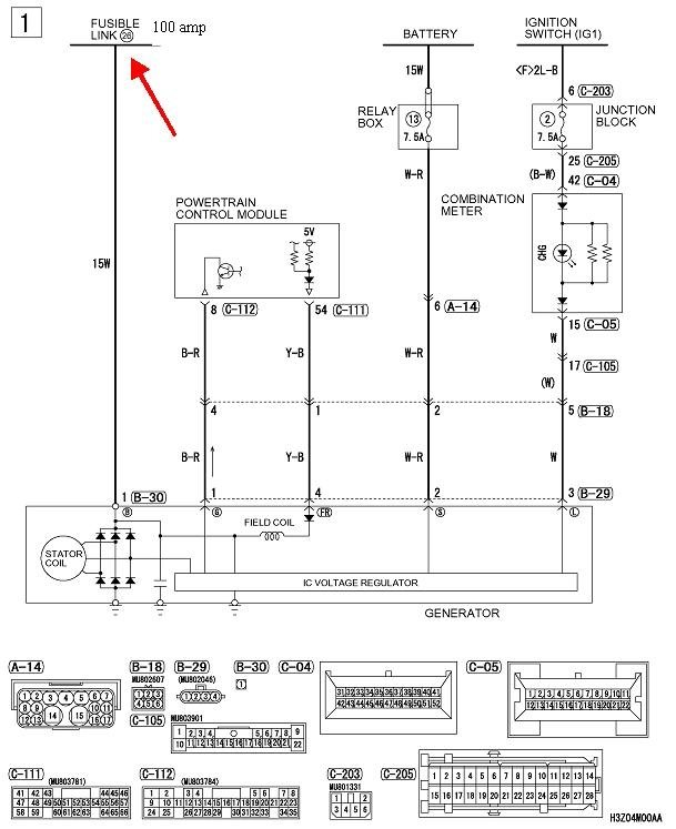

Wire # 15W in this diagram is of a large enough gauge to handle 110 amps intermittently, so it will also be fine with a 90-amp generator. It will not handle 180 amps. If you were to replace the 100-amp fuse with a 200-amp fuse, that will not protect that wire 15W.
All AC generators have at least six internal "diodes" which are one-way valves for electrical current flow. They are in two sets of three diodes. Those appear backward in the circuit when the engine is not running, and they are what blocks current flow and prevents the battery from discharging through the generator. It is not uncommon for one of those diodes to short. That will cut the generator's maximum output capacity to exactly one third of its rated current, but there will still be the diodes in the other set to prevent current flow. Most of the time there are symptoms that lead to the replacement of the generator, but if it goes undiagnosed or ignored, it is possible for a diode in the second set to short too. That would result in a dead short across the battery, and really high current flow through that 15W wire. The wire would burn up and start a fire before the fuse would blow. When doing this type of modification, that wire has to changed as well as the size of the fuse protecting it.
