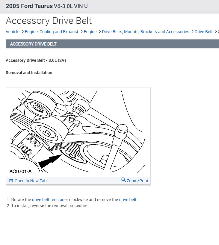

Serpentine belt installation.
Aug 10, 2022 at 4:22 PM
SQM
CERTIFIED EXPERT
6,383 POSTS

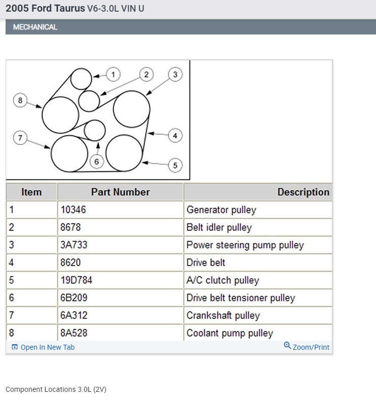

See attached for the belt diagram and replacement steps.
Here is a helpful guide:
https://www.2carpros.com/articles/replace-serpentine-belt
Let us know of any questions.
