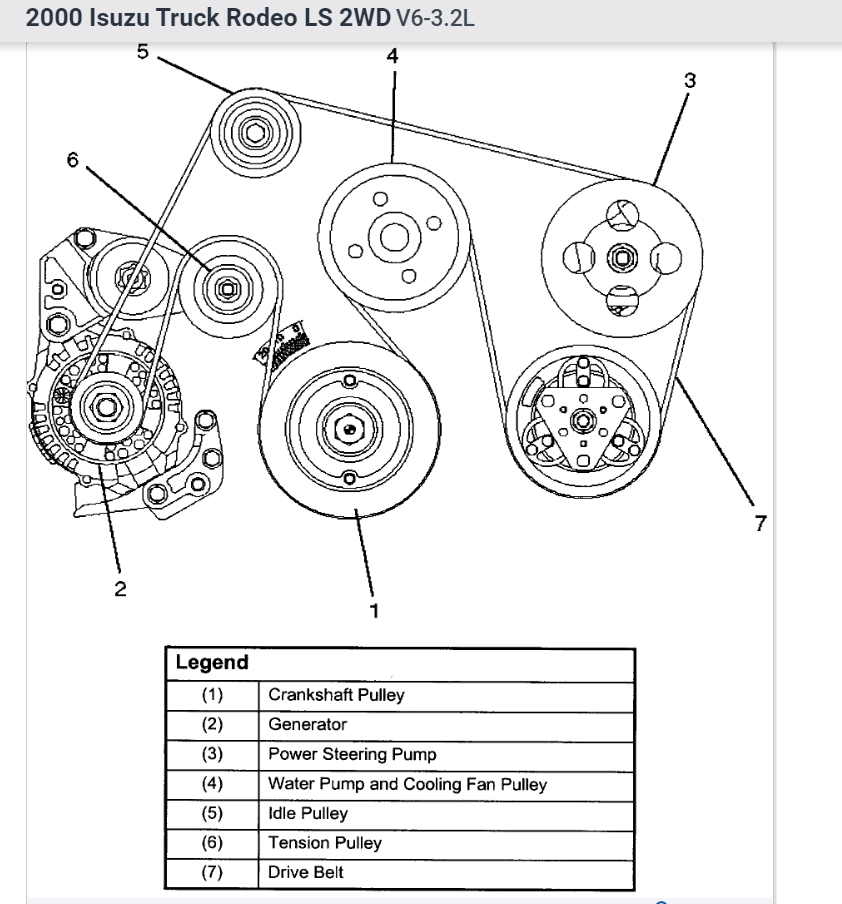

looking for a serpentine belt routing diagram for my vehicle listed above, just can't seem to find the right layout.

Here is a generic guide to help you change the serpentine belt out with the belt diagrams and routing in the images below:
https://www.2carpros.com/articles/replace-serpentine-belt
Check out the diagrams (below). Please let us know if you need anything else to get the problem fixed.

thank you so much, that's perfect. :)
