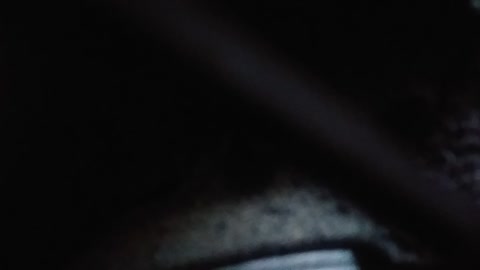

Okay, they look okay. Here is a video:
Jul 5, 2018 at 6:22 AM
Okay, thanks.
Can you take a video with it running?
Jul 5, 2018 at 6:34 AM

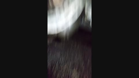

I would but I tried starting it last night and it sounded bad so I hurried up and shut it off. I cannot really explain noise.

I know the drive pulley was wobbling.

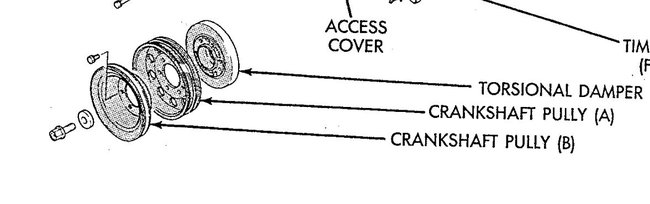

If it runs and the pulley is not turning, it may be the pin in the pulleys that has broken. My question is why? The pulley may be loose.
You are going to need to remove the belts and then remove the four bolts for the pulleys and then the center bolt for the balancer.

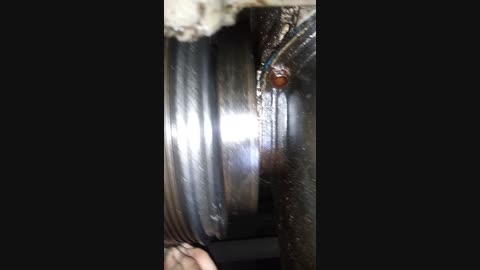

Both belts are off all pulleys are okay, except for the crankshaft pulley. It is wobbling and loose and there are six bolts. Also, there is a screw that looks like a pin would go in it. Here is a video to belts still look good too.

Here is video:
Jul 6, 2018 at 6:30 AM
The six bolts hold the balancer to the timing gear. The timing belt runs behind that. The center bolt will release the balancer when you remove it.
That loose pulley is my concern. Cannot see it to well.
Jul 6, 2018 at 9:35 AM
