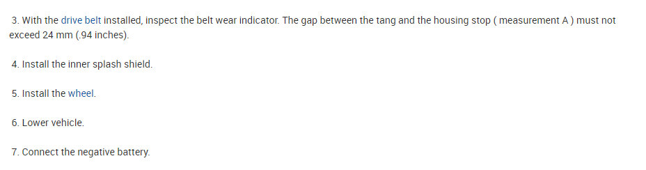

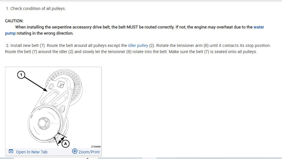

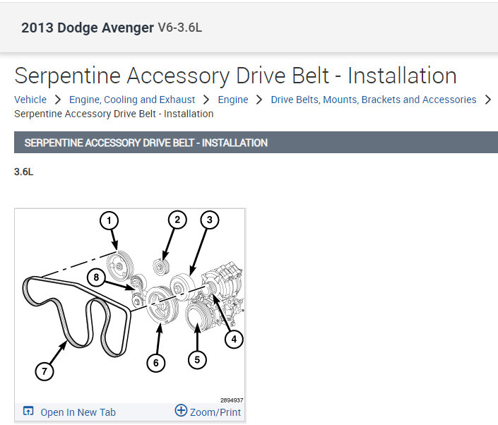

If you look below, I included the manufacturer's directions for installing it.
Let me know if this helps or if you have questions.
See pics below.
