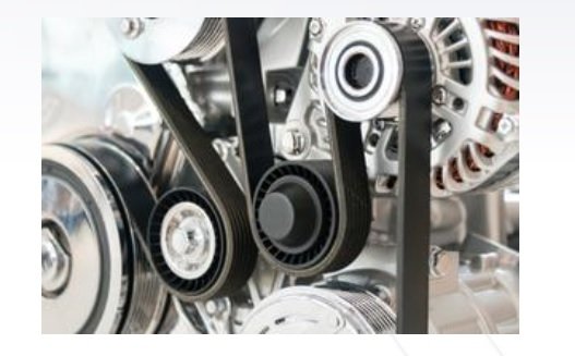

You should be able to handle it. Do you have a belt routing diagram? You use the proper socket with long handle ratchet or break-over. I hope the picture is accurate? You see the pulley with bolt in the middle, you put the socket there and pull, loosens tension on belt, then take belt off accessory. That tensioner spring may be stout, a long handle will probably help. If your going to work on your own vehicles, you need a tool set, sockets and wrenches, standard and metric sizes. I do not know the bolt size on the tensioner. The tensioner should be close to crankshaft.
