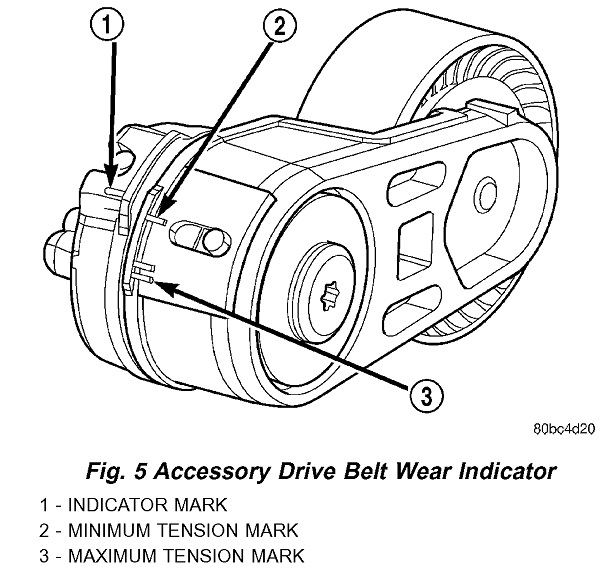

DIAGRAM 1
2. Rotate belt tensioner until it contacts its stop. Remove belt, then slowly rotate the tensioner into the freearm position. (Fig. 4).

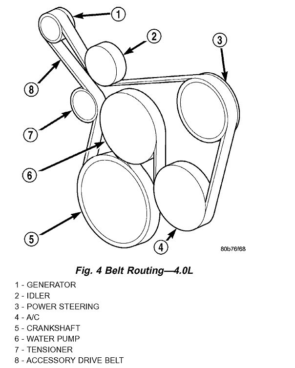

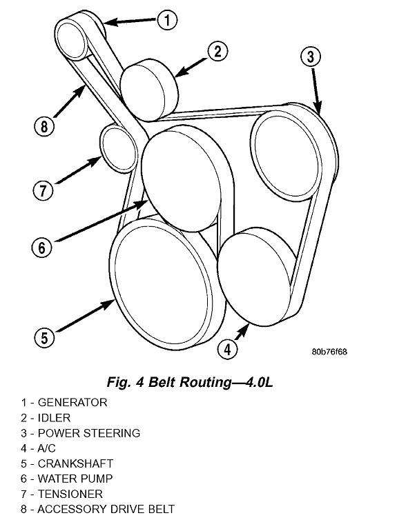

CAUTION: When installing the serpentine accessory drive belt, the belt MUST be routed correctly. If not, the engine may overheat due to the water pump rotating in the wrong direction (Fig. 4).
2. Install new belt (Fig. 4). Route the belt around all pulleys except the idler pulley. Rotate the tensioner arm until it contacts its stop position. Route the belt around the idler and slowly let the tensioner rotate into the belt. Make sure the belt is seated onto all pulleys.
DIAGRAM 2
3. With the drive belt installed, inspect the belt wear indicator (Fig. 5). On 4.0L Engines, the indicator mark must be between the minimum and maximum marks. If the measurement exceeds this specification replace the serpentine accessory drive belt.
