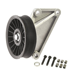

The AC went out now the car will not start. Can the serpentine belt be bought in a smaller size to bypass the AC? If so what size belt should be bought?

In all honesty, chances are you cannot eliminate it and then determine a good way to route it. What I suggest is to get an AC bypass pulley. Basically, it takes the place of the compressor and the same belt is used and routed the same way.
I attached a picture of one I got online for you to see. These can be purchased at most parts stores. A company called Dorman is one of the most widely known aftermarket manufacturers and they do make one for your car. If you call a parts store, just ask for an AC bypass pulley for your specific vehicle. Please do not quote me, but I think the Dorman part number may be 34190. Please confirm that is the one for your vehicle before ordering.
I hope this is helpful. Let me know if you have other questions.
