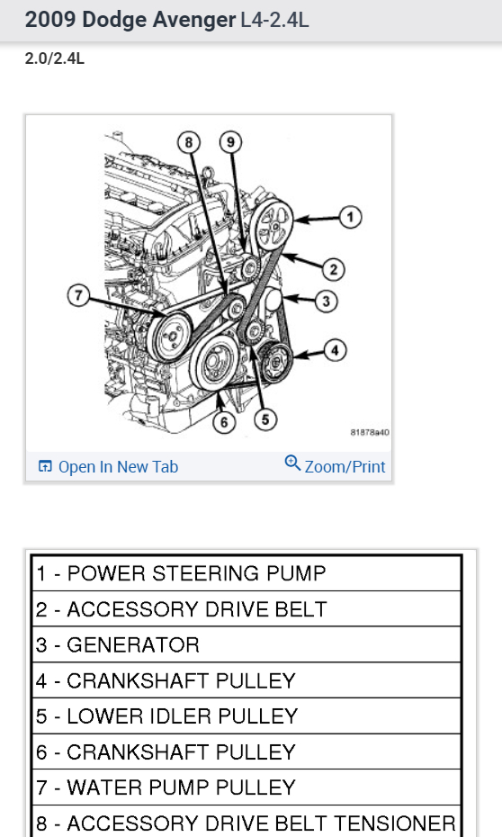

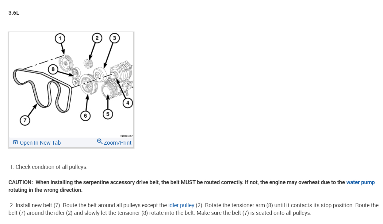

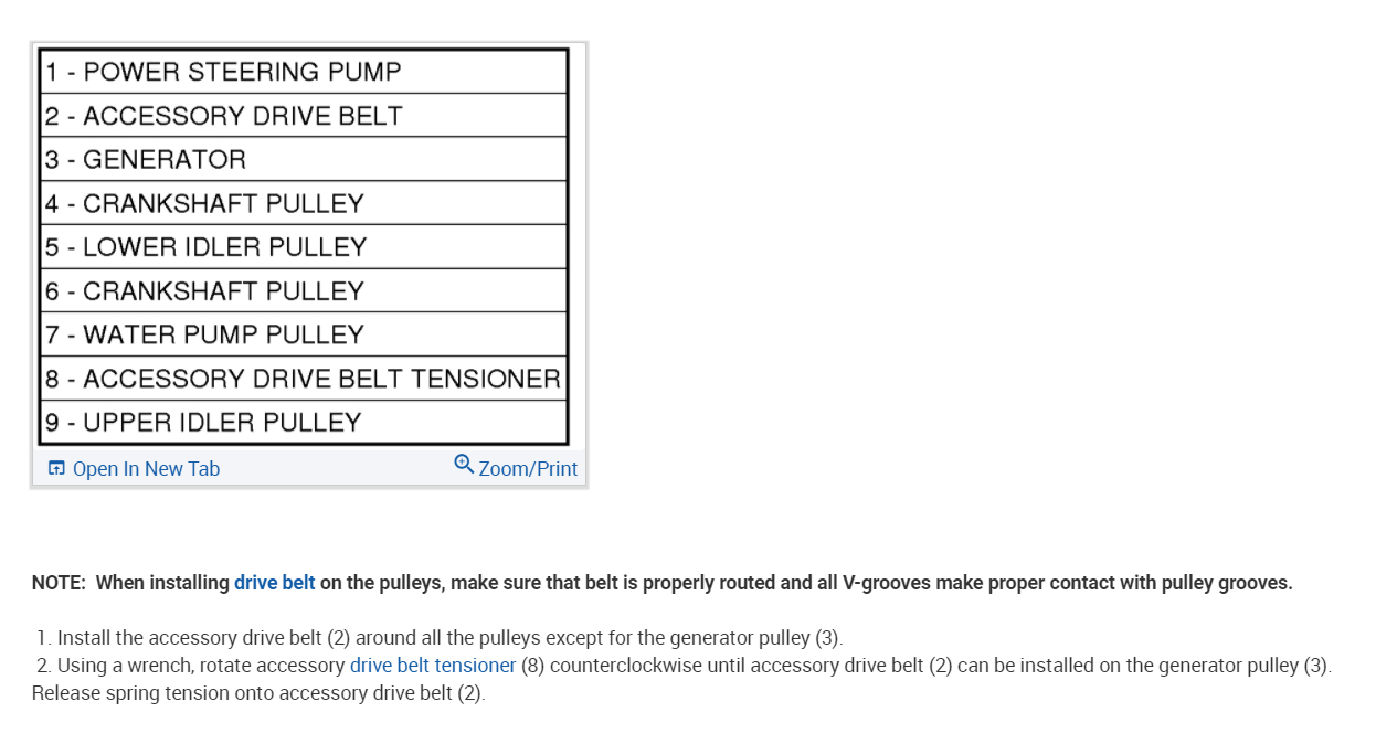

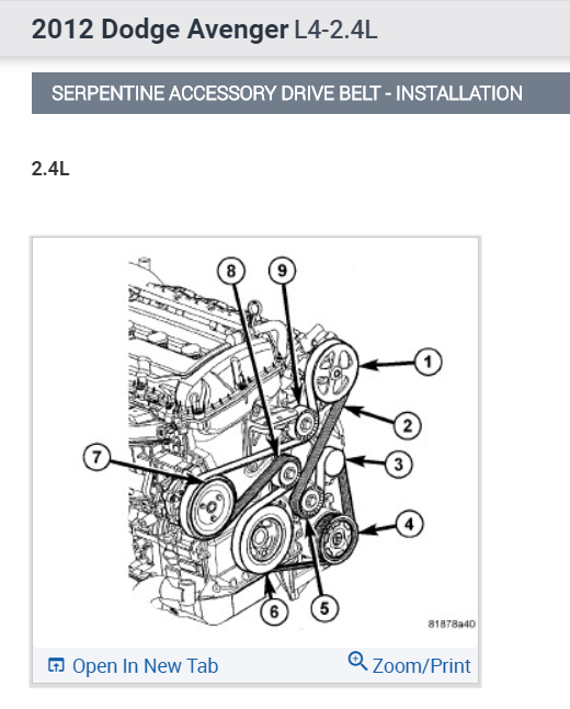

How to put one back on after replacing the alternator?
Mar 6, 2018 at 9:42 AM
Good afternoon. Here are the instructions and belt routing diagrams below (Both engines) Check out the diagrams (Below). Please let us know if you need anything else to get the problem fixed.

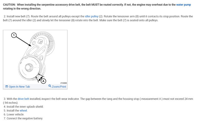

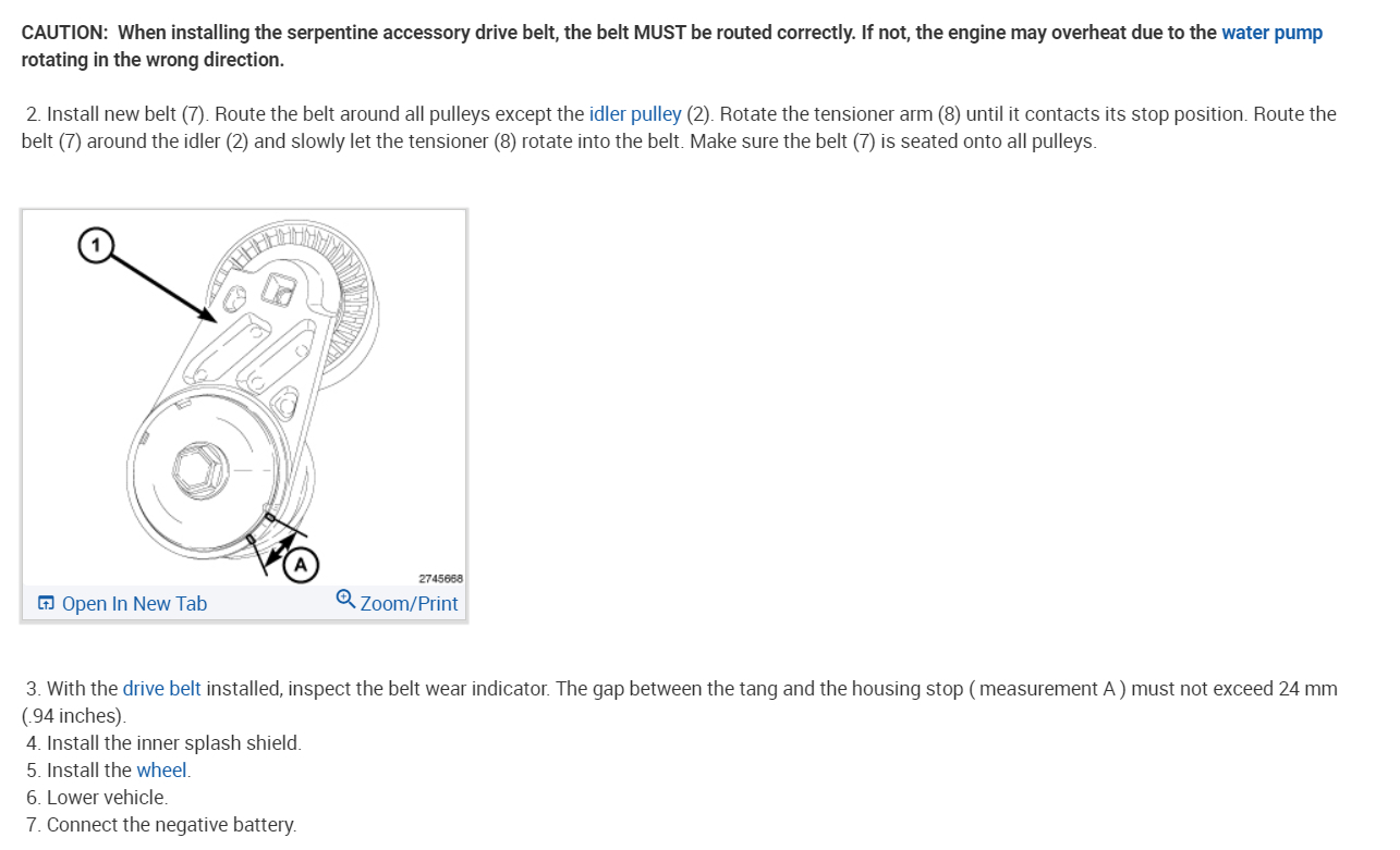

Here is a guide to help you step by step on replacing the belt and diagrams below to show you how the belts goes. I included all engines just incase.
https://www.2carpros.com/articles/replace-serpentine-belt
