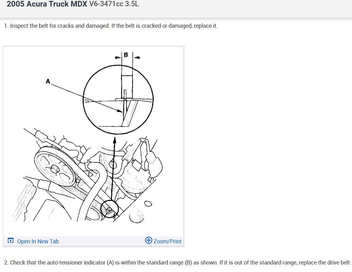

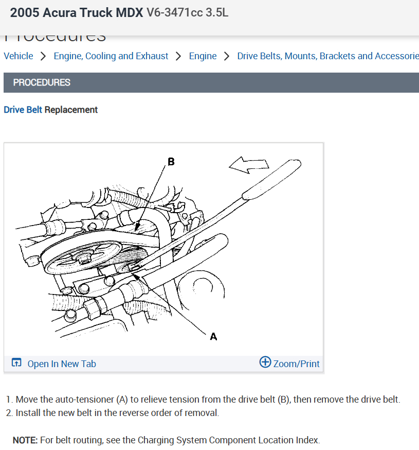

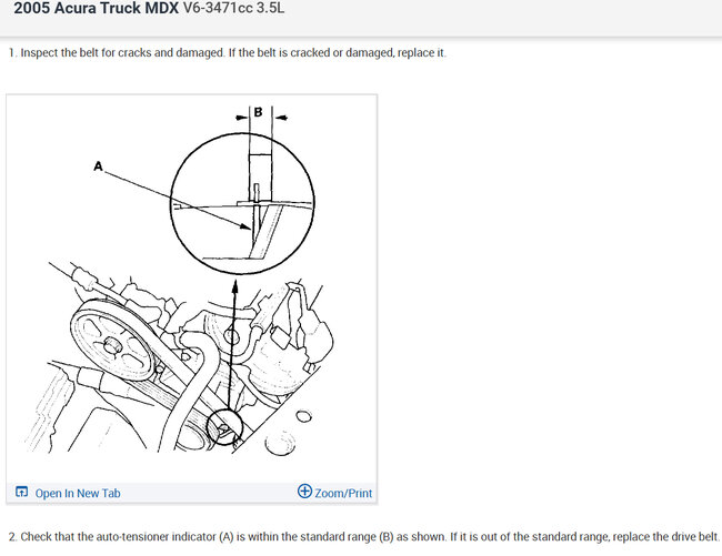

Here is how to replace the serpentine belt in case you need it. Check out the images (below). Let us know if you need anything else.
