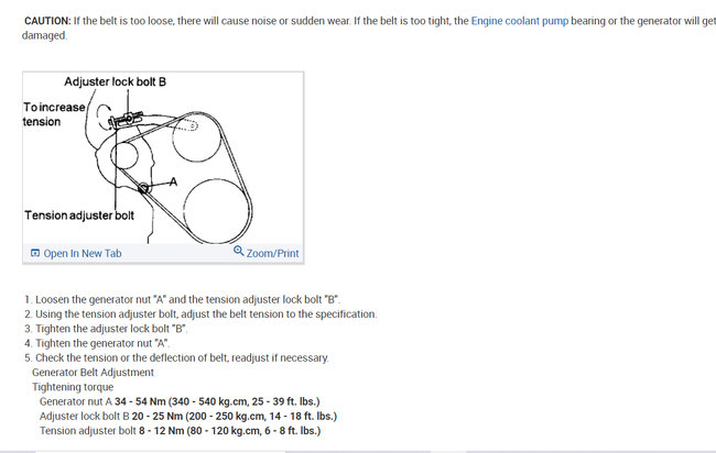

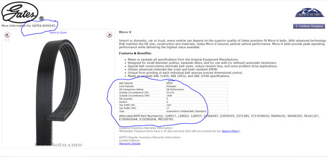

What size serpentine belt do need I tried a 13/16 x 79 1/2 20mm x 2018mm.
Jun 1, 2021 at 8:09 PM
Good morning,
I attached the specification for you of the belt required for your car.
https://www.2carpros.com/articles/replace-serpentine-belt
I would use a Gates belt as they are the best and most reliable.
