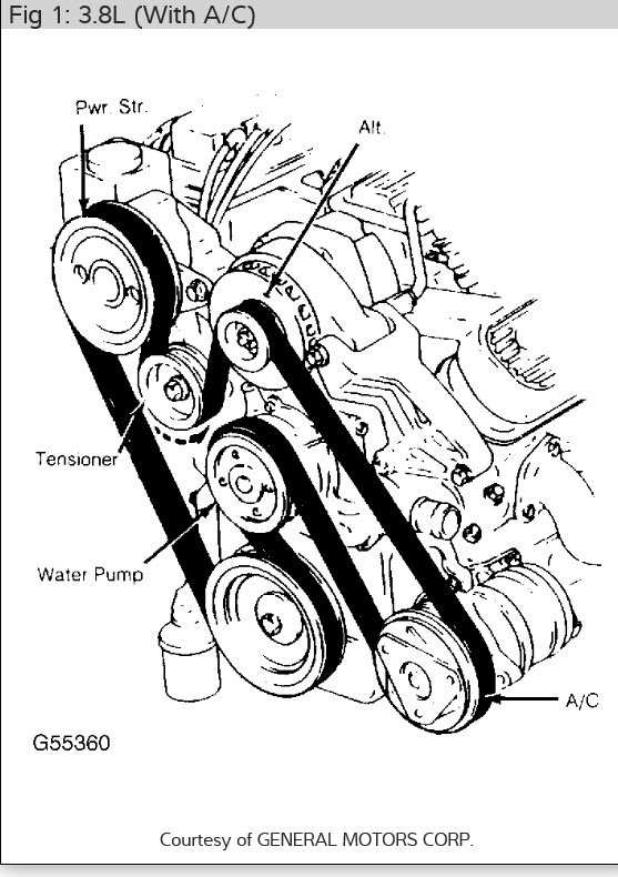

the serpentine belt slipped off and I need diagram to put back on. The specs are listed above.

i am not sure about the liter It is a V6 front wheel drive.

if belt came off check for a worn tensioner and component out of alignment like one of pulleys. tensioner should be replaced when belt is see picture.
Image (Click to enlarge)
