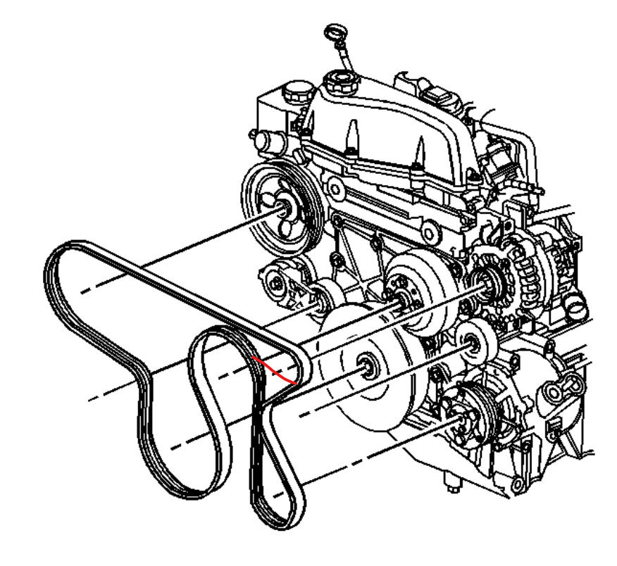

Can I get the belt number to bypass the A/C compressor?
2007 GMC ENVOY
200,000 MILES • 4.2L • 6 CYL • 4WD • AUTOMATIC
ROBERT RIDDLE
I want to bypass the A/C compressor, and I need a part # for a belt that will work on a 2007 4200 vortex inline 6.
Sep 22, 2024 at 6:16 PM
They don't give us a part number for the shorter belt unfortunately, but you can go to the auto parts store and see if they have a listing for your engine without A/C, if not it will be trial and error. I would get three belts starting at 23 inches shorter and then return the ones that don't work. Check out the images (below). Let us know what you find.
