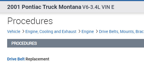

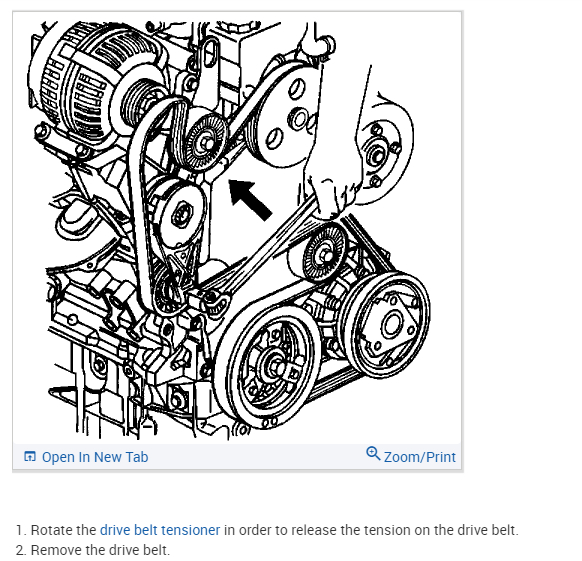

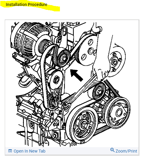

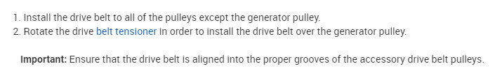

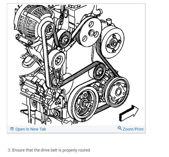

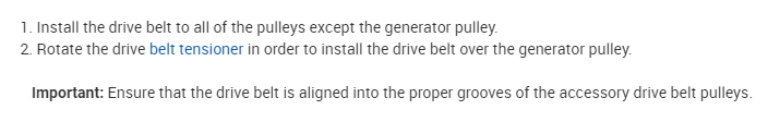

I attached the directions for removing and installing the serpentine belt. See pics below

Take a look through the directions and let me know if you have questions.
