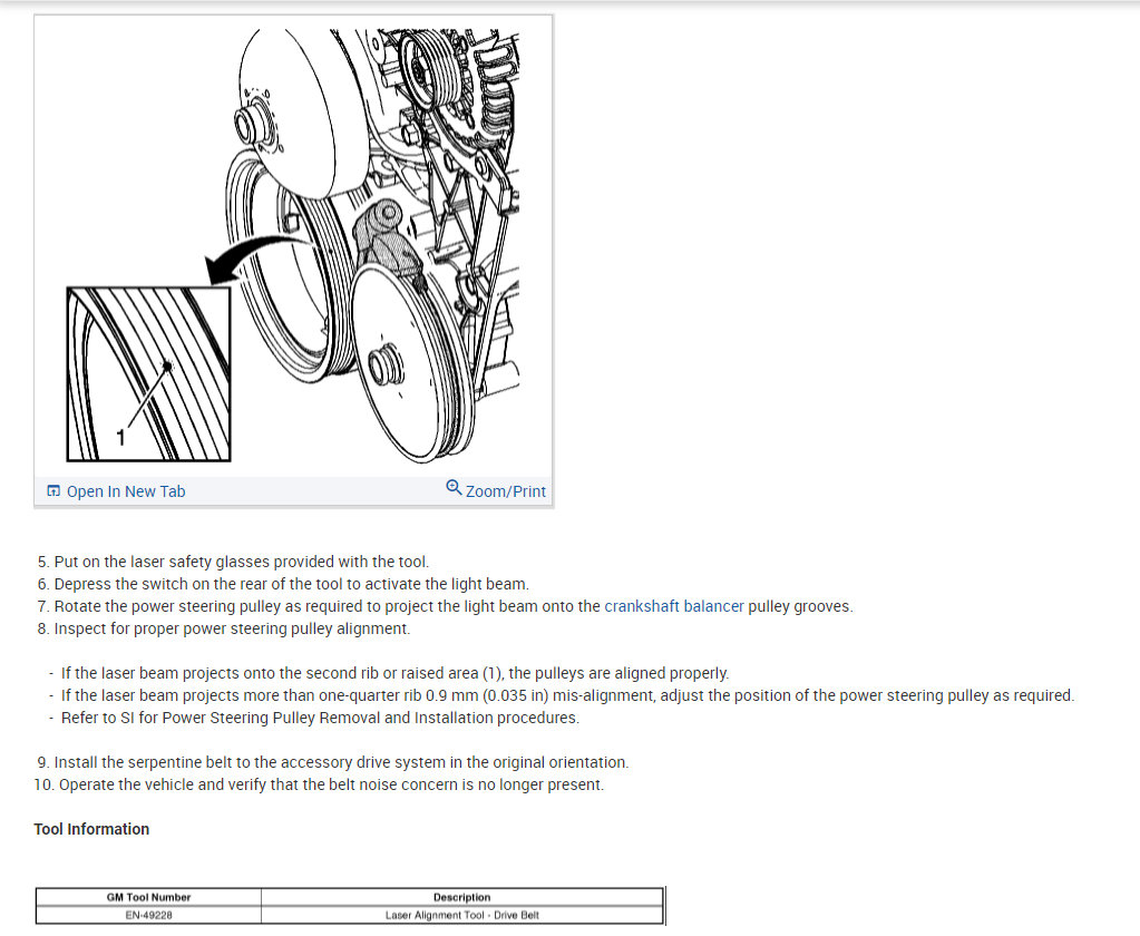

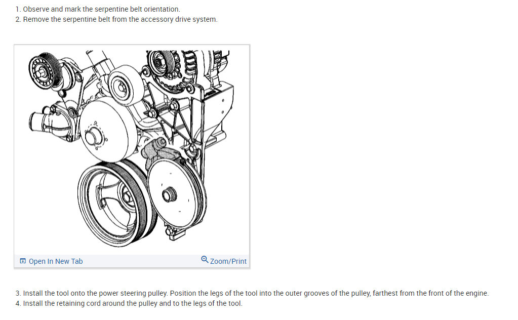

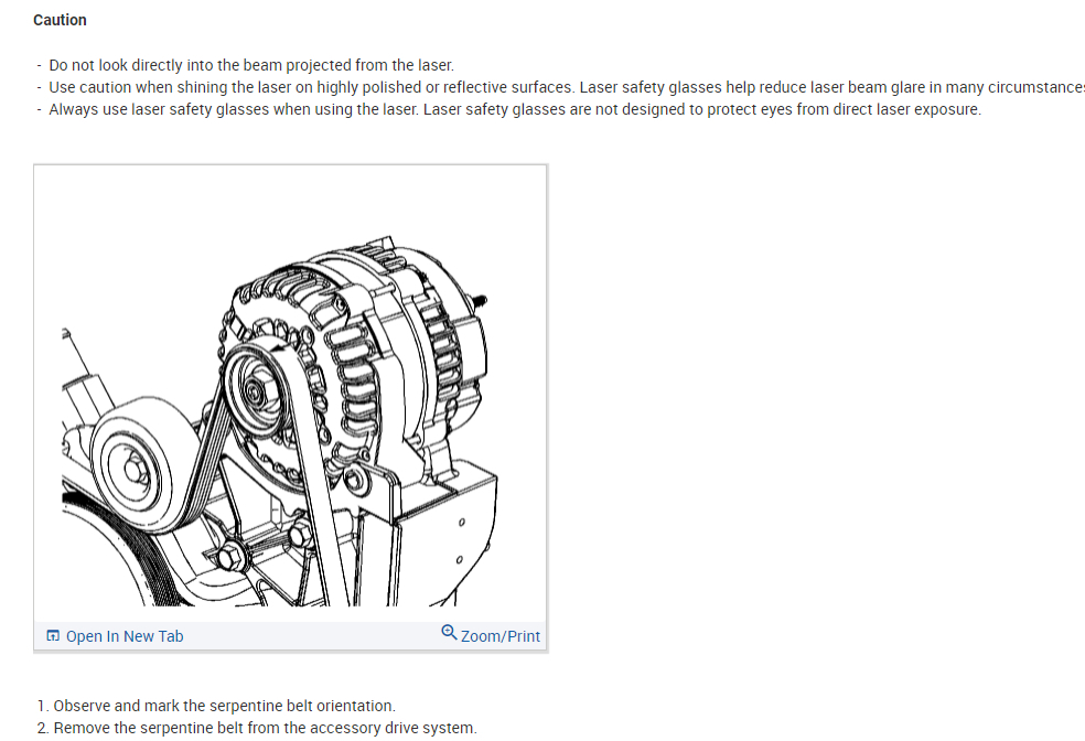

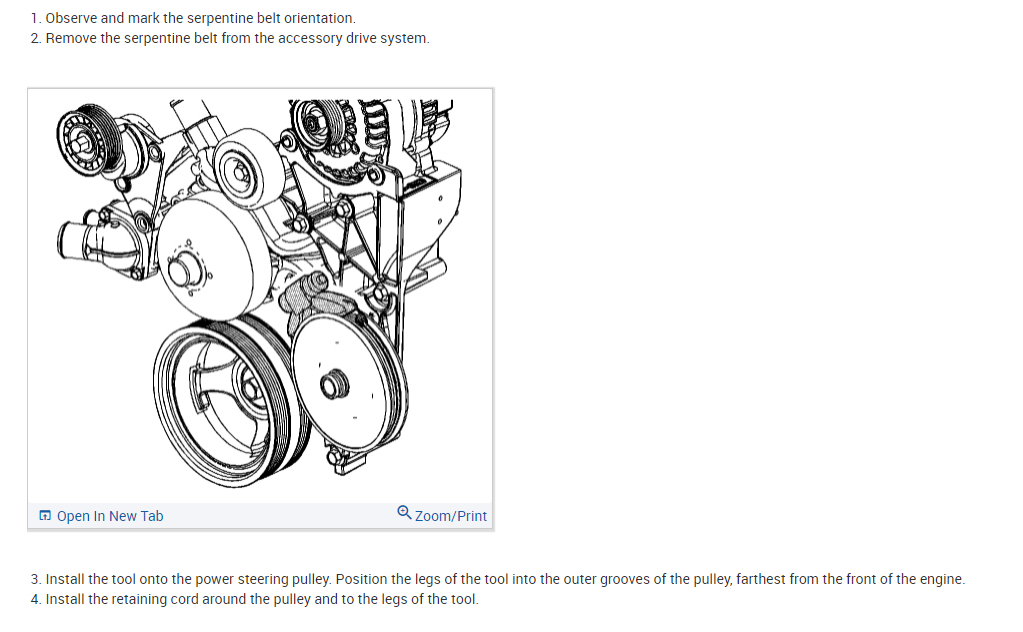

how do i change the serpentine belt?
Dec 19, 2016 at 4:58 AM
CERTIFIED EXPERT
52,796 POSTS
Good evening,
I attached the drive belt diagram for you to view. You need a long wrench to contact the tensioner and then turn it clockwise to release the belt.
https://www.2carpros.com/articles/how-a-serpentine-belt-tensioner-works
https://www.2carpros.com/articles/replace-serpentine-belt
