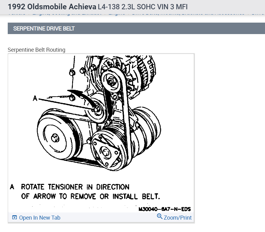

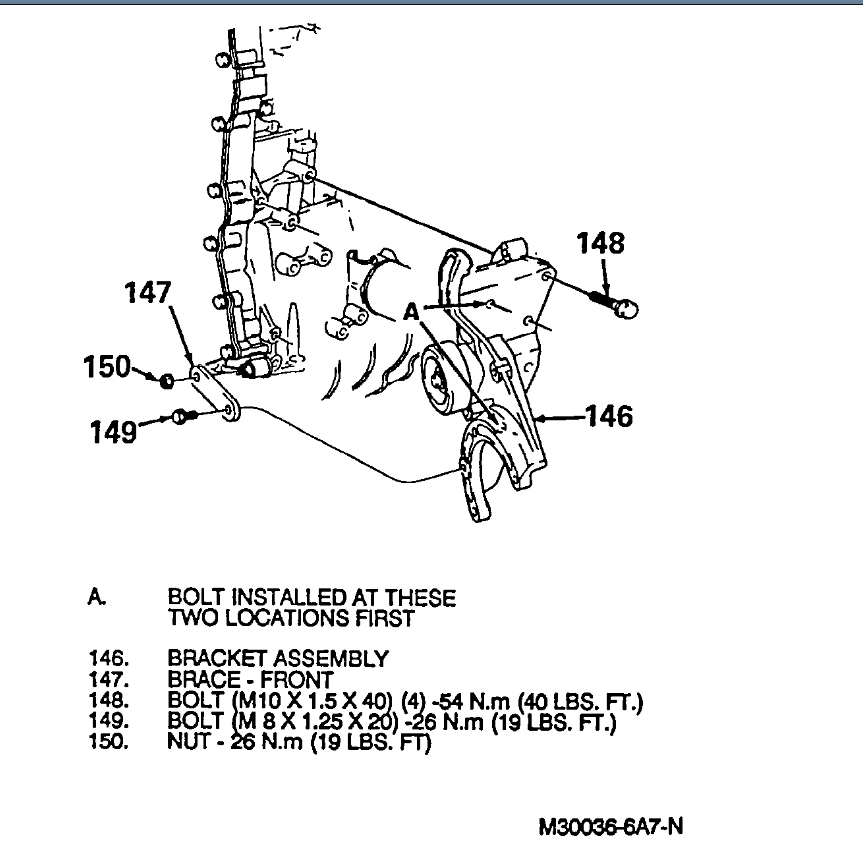

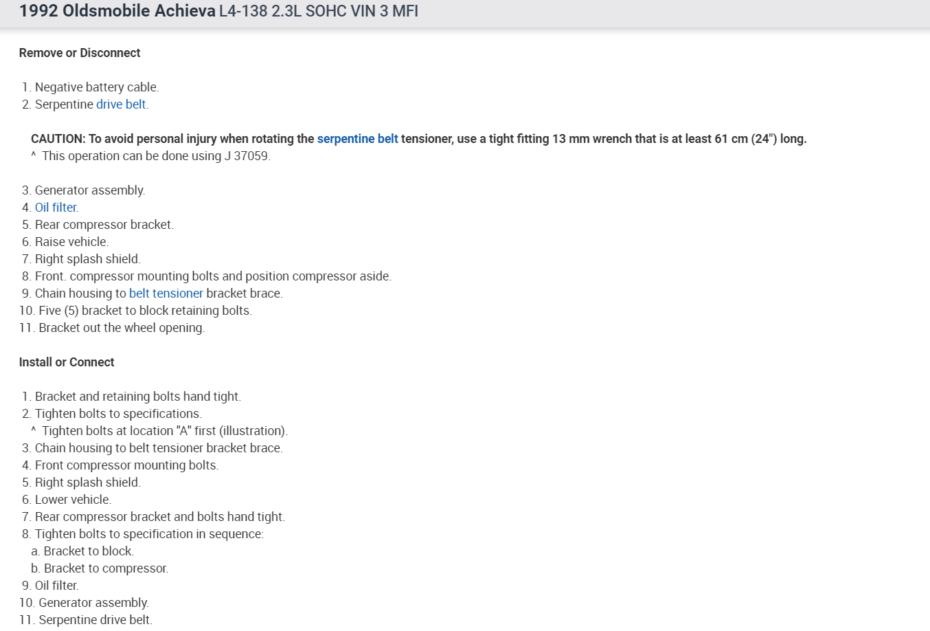

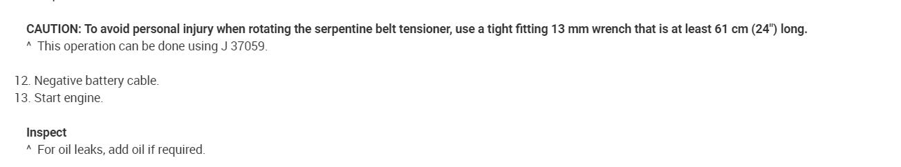

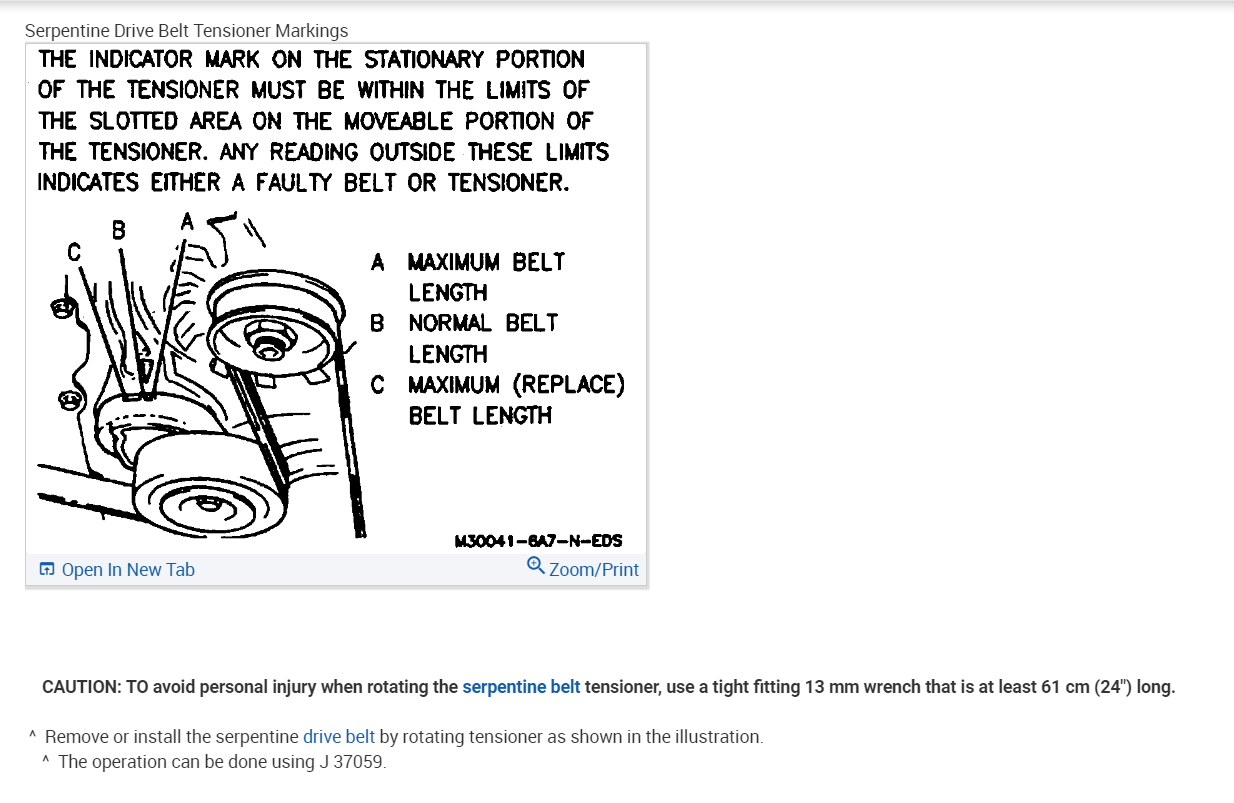

Sure, these are instructions on how to replace the serpentine belt and the belt tensioner. I have also included this guide to help walk you through the steps:
https://www.2carpros.com/articles/serpentine-belt-tensioner-replacement
Check out the images (below). Please let us know if you need anything else to get the problem fixed.
