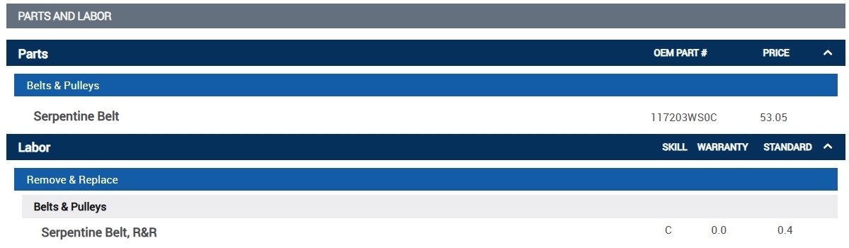

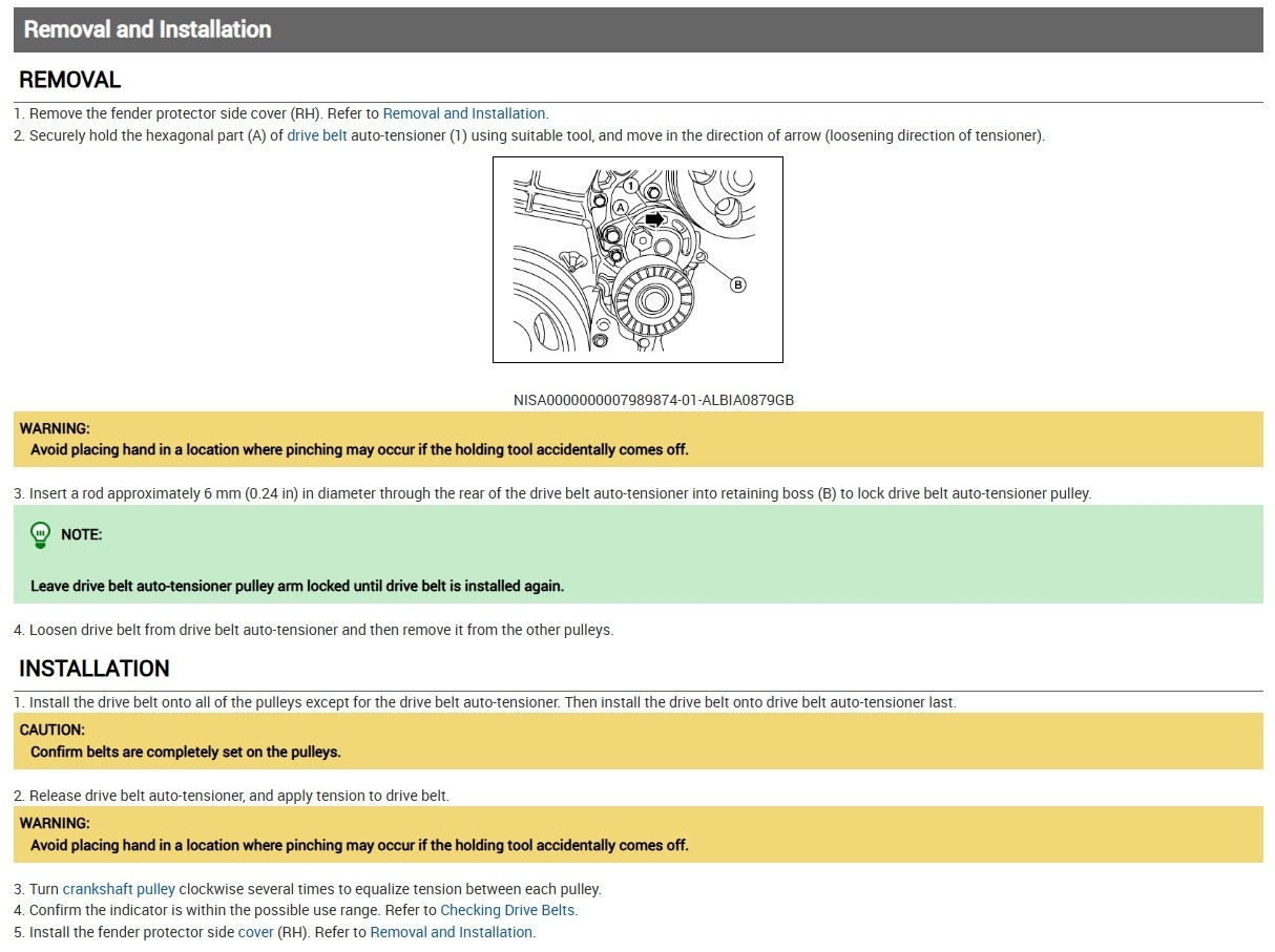

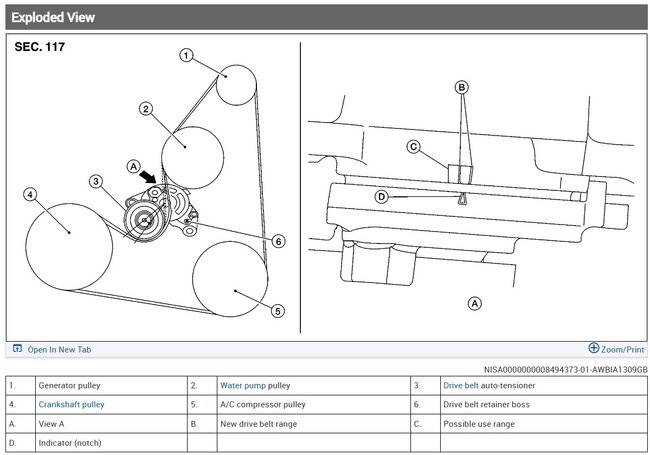

Hello, you're including the tensioner pulley in at 5 I assume? We have the belt number and diagram right here, I'll post it for you.
Nov 22, 2024 at 8:43 AM
AL514
  • 5,465 POSTS
The OEM part number is in the first diagram.
