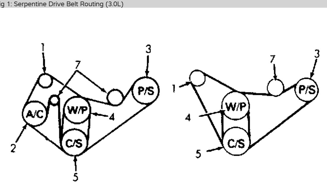

I need to replace the serpentine and other belt, but I need to see a picture of how both are supposed to be placed.
Mar 15, 2016 at 4:16 PM
HMAC300
  • 48,601 POSTS
The manual shows a 2.9L, but for some reason is not listed. This is a 3.0ln picture. if you have an automatic tensioner/s replace that as well.
