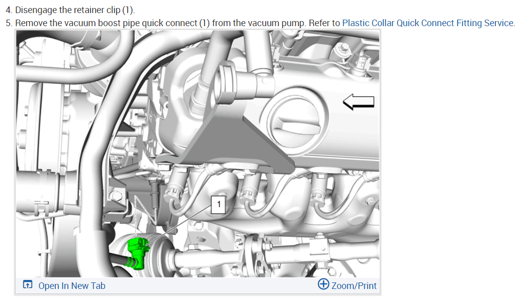

The vacuum belt helps the power brakes, I can tell you to drive it because it is a safety issue and the brakes will be harder to push which in turn will be more difficult to stop the truck. The problem is I don't see a vacuum pump on the 6.2 liter for the 2016, there is one for the 2017 though.
Vacuum Generation: The vacuum pump generates the vacuum needed for power brake assistance.

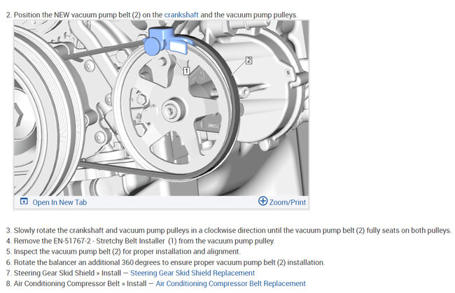

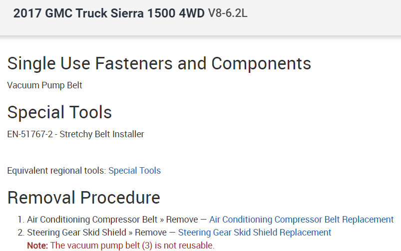

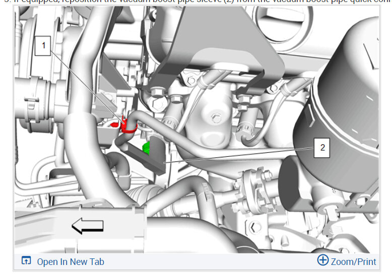

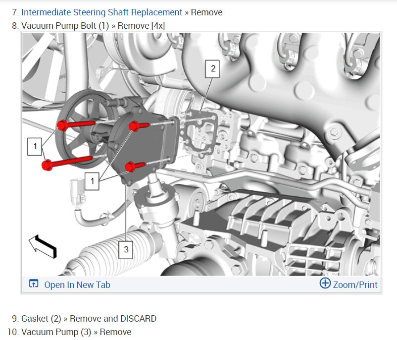

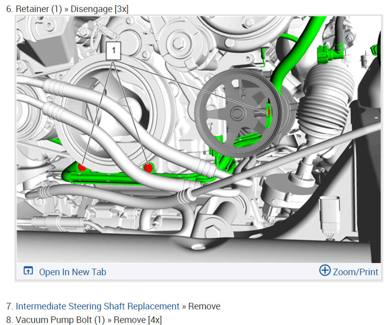

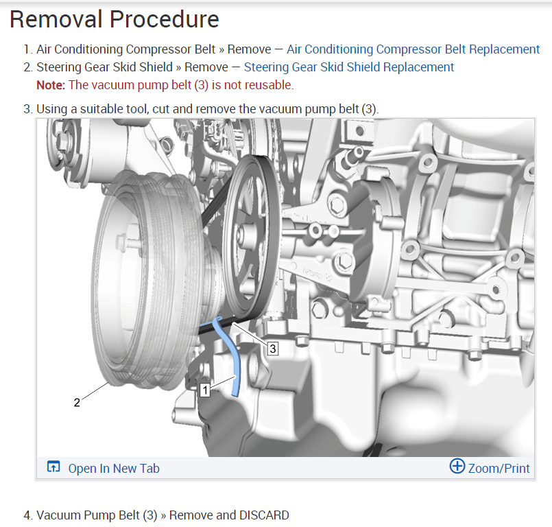

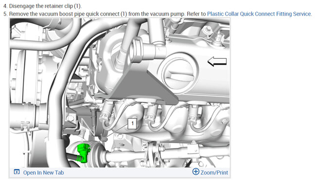

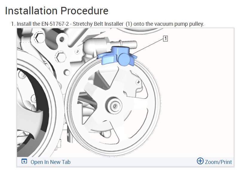

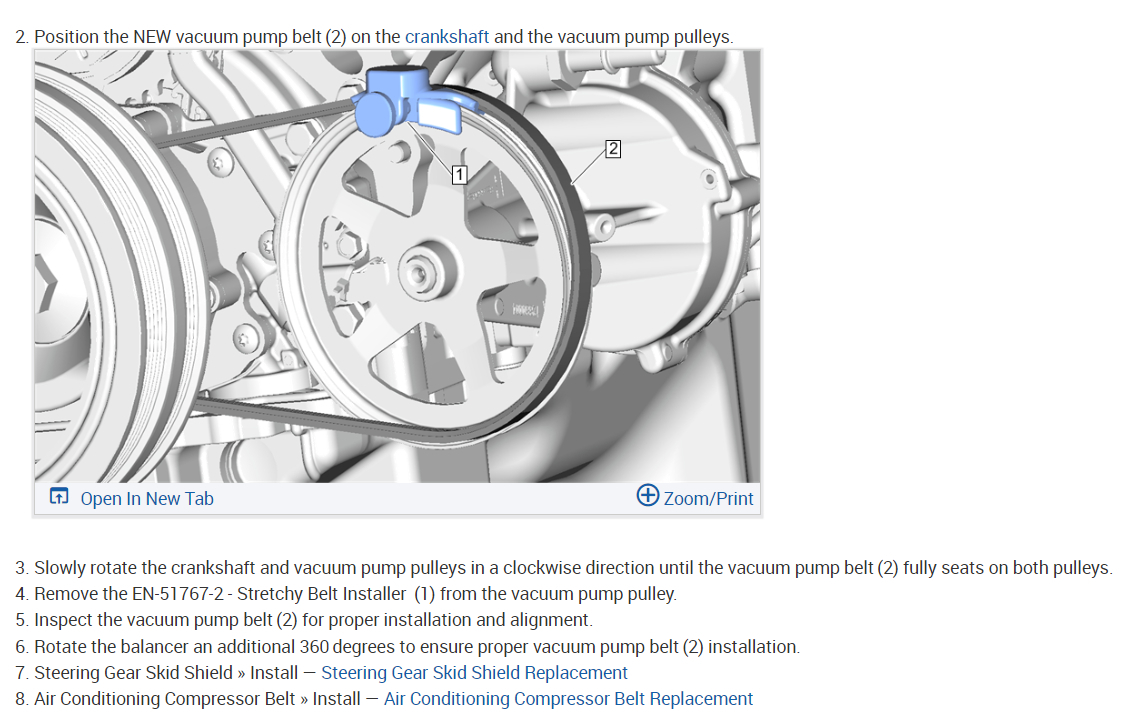

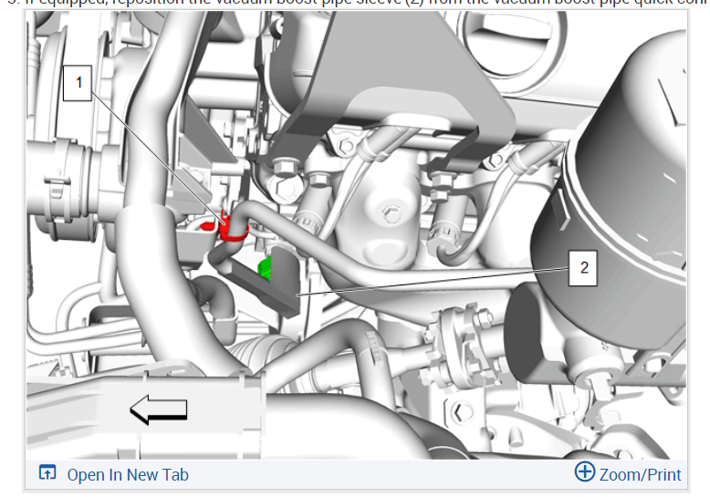

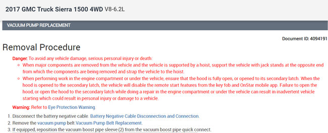

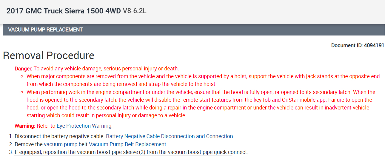

I would reach down to see if the pump turns because i could have locked up which kicked the belt off. Here is how to install the belt and the vacuum pump in case you need it. Check out the images (below). Please upload pictures or videos in your response of any problems so we can see what to help you with.
