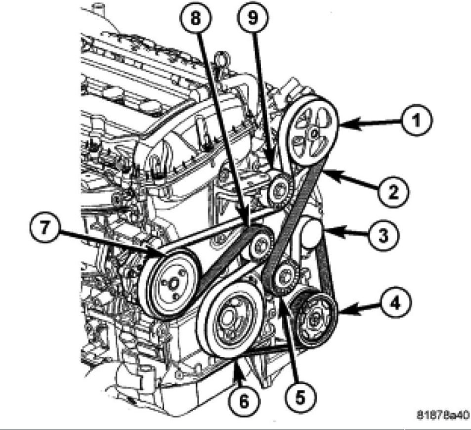

Need a diagram on how to replace a serpentine belt on the car listed above 20 engine.
Sep 8, 2018 at 12:11 PM
CJ MEDEVAC
CERTIFIED EXPERT
11,004 POSTS
Here is the serpentine belt routing diagrams to help you step by step with instructions in the diagrams below to show you how on your car. Check out the diagrams (Below). Please let us know if you need anything else to get the problem fixed.

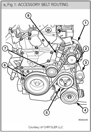

I had to replace the alternator plus put a new battery because the alternator drained it, the car don't have a diagram on the car to put the serpentine belt back on and I didn't pay attention when I took it off,please send me the diagram please

Here's the diagram for your serpentine belt.. Its a good idea to draw it on a clean flat spot under the hood with a sharpie if the decal is missing. Check out the diagrams (Below). Please let us know if you need anything else to get the problem fixed.

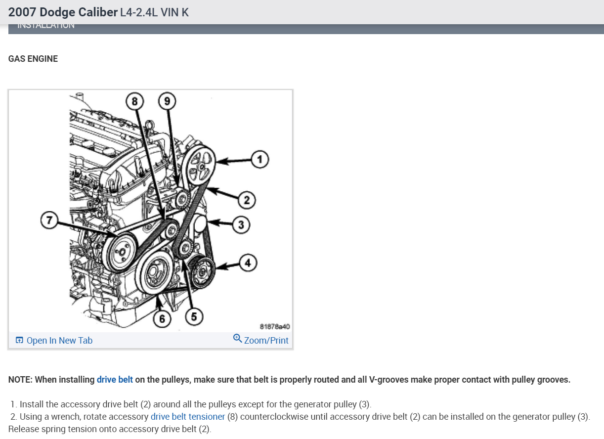

where can i get a routing diagram for the drive belt car has a/c

Here is the serpentine belt diagrams below with a guide that will help walk you through he steps of replacement.

I need to know the exact name of the pulley #3and#8 so I can go to the store to buy it
