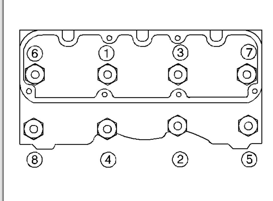

I just need torque sequence and specs for head bolts and rocker arms for my car it is a GTP supercharged.

11 ft lbs on rocker bolts with new bolts ( no exceptions). New bolts on cylinder heads in sequence in picture 37 ft lbs then 120 degrees.
