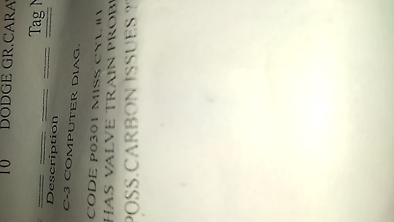

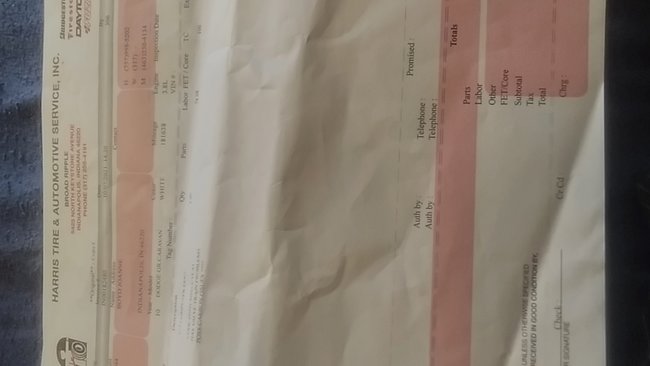

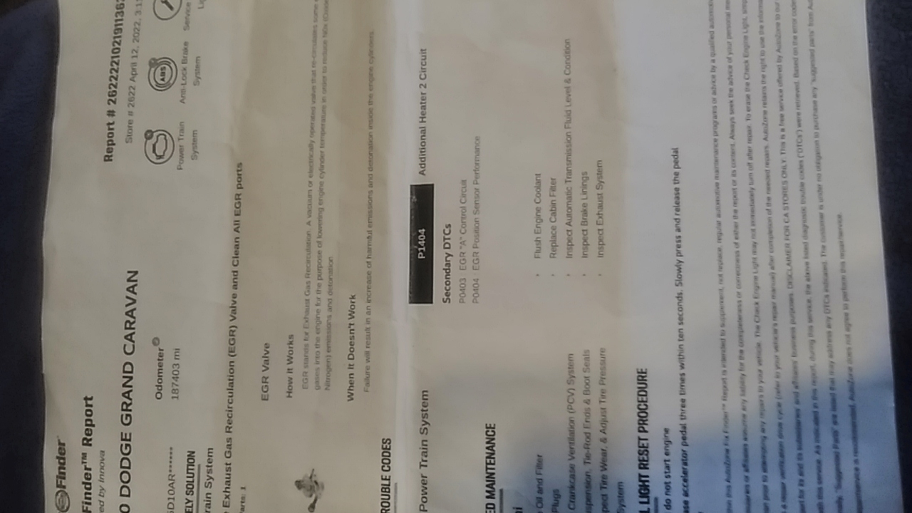

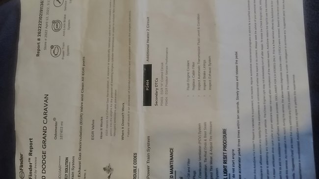

Okay, I'm having a little bit of trouble with what you're saying, but that's okay. So, it sounds like you took it to AutoZone first? I know they can tell you what the codes are in the computer. And are you saying that you have purchased those components already, the PCM, crankshaft position sensor, EGR valve, and fuel injectors? All I can see on the picture is " Computer Diag, Has Valvetrain problem, and something about carbon build up. If you could get a better picture of that so I can see the whole thing. Sometimes picture from customers don't come out to well over the internet, but your question about the "valve train" is. The valve train is the upper parts on top of the cylinder head under the valve cover. So, this will include the camshaft, the intake and exhaust valves, valve springs, and rocker arms which open the valves. And I think what he was saying on there is a build up of carbon deposits on these components will affect the performance. Carbon build up on the intake and exhaust valves for example can cause them to not open fully and/or hang open when they should be closed. You may hear a lot of ticking type of noises with valve issues.
Also, a lot of carbon build up under the valve cover (same area) can restrict the flow of oil to those components preventing them from being properly lubricated causing extreme heat build up and other problems.
As for where to take the vehicle, for one the people at AutoZone are not mechanics. They can only tell you what codes you have, and usually they will just sell you the part there is a code for. This is not the correct way to diagnose an issue. A code only tells you what the engine computer is detecting as a potential fault.
The dealership is going to be the most expensive option. And you are correct, it is difficult to find an honest shop. I don't think you need to replace the PCM, I think these other issues just need to be addressed first.
The carbon build issue is probably what is causing the most of the problems. It will cause cylinder misfires, EGR valve issues, etc. If you can get a better picture of that invoice up there that would help.

So, try to post a better invoice picture and we'll go from there. You can go to a couple of different shops and show them the invoice as well and get different quotes. You will notice a difference for sure doing it that way.
