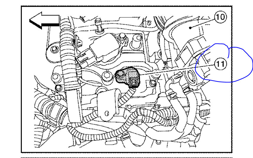

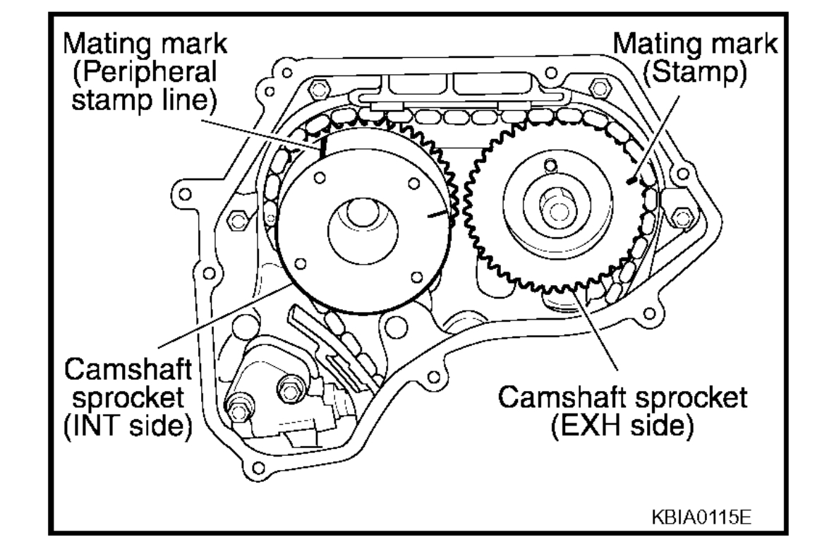

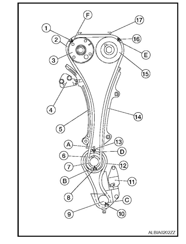

After overhauling the cylinder head including changing valves , timing chain kit and injectors and turbo charger.

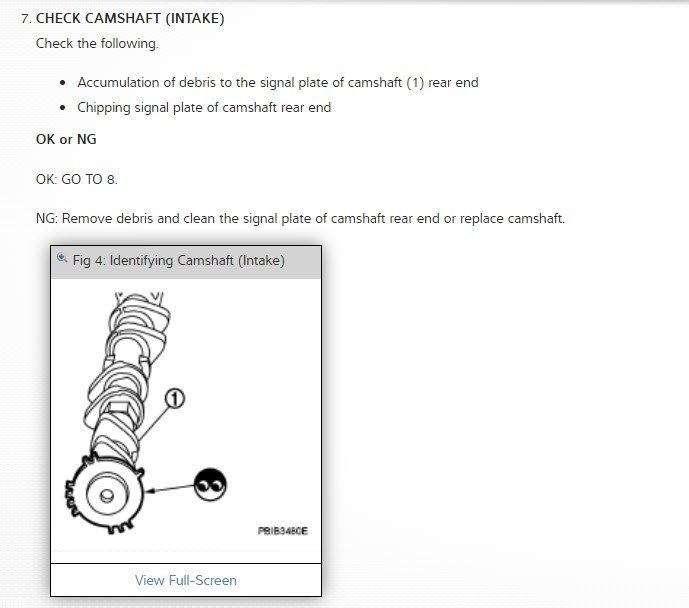

the engine turns over but does not fire up unless you pull the cam censor out 2mm then it fires up, but the engine management light remains on. i have also checked and changed the Cam shaft and Crank shaft censor. the diagnostics keeps coming up as Sensor correlation.
