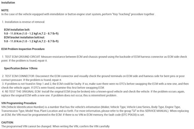

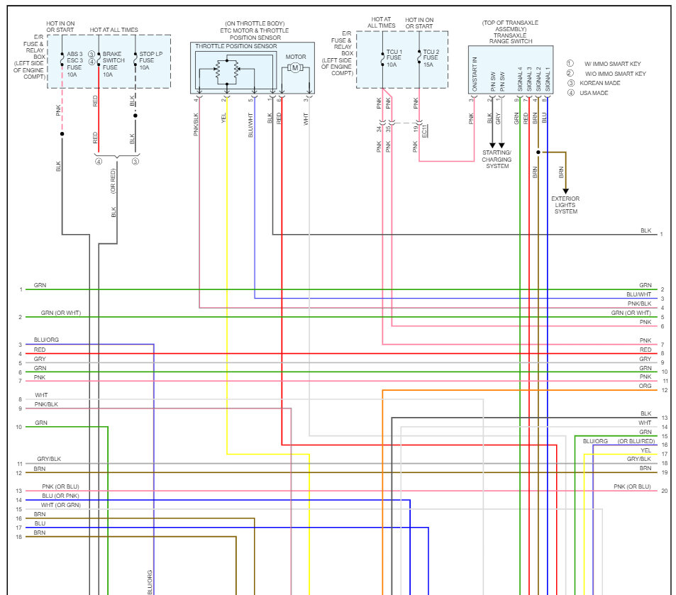

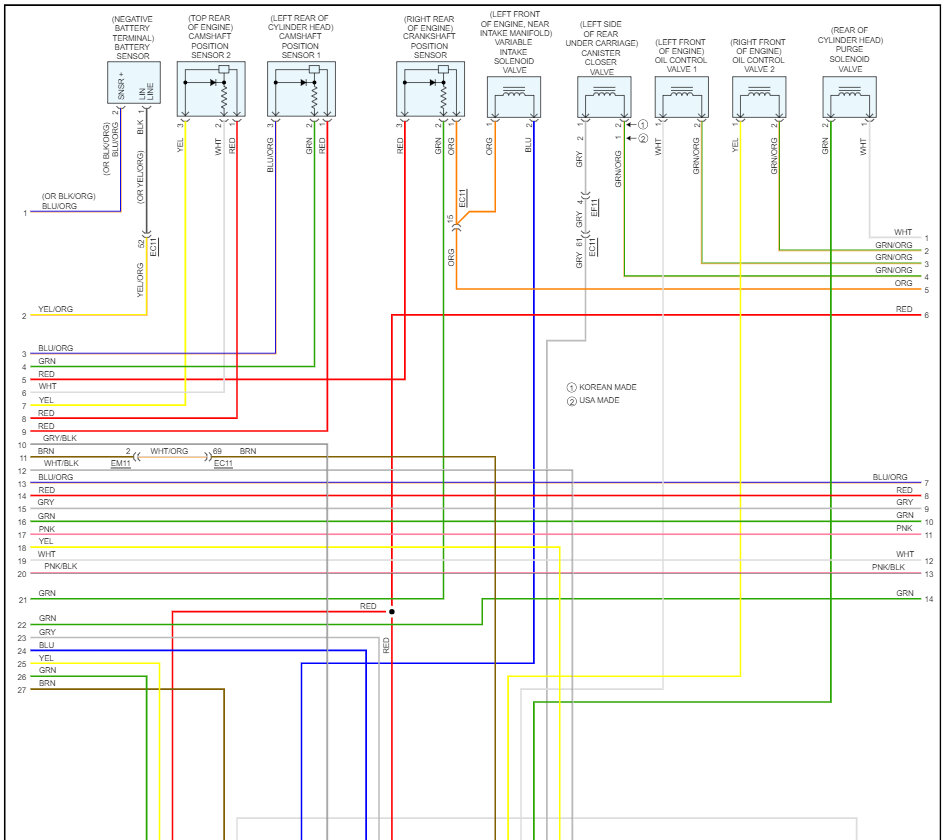

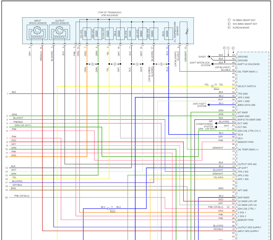

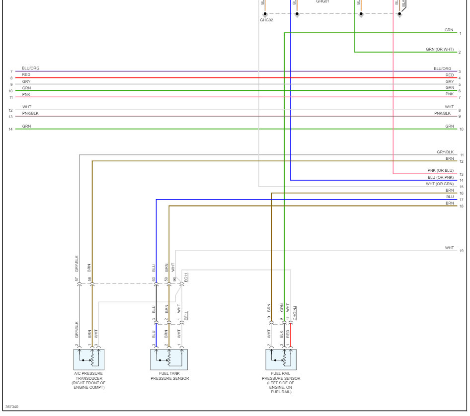

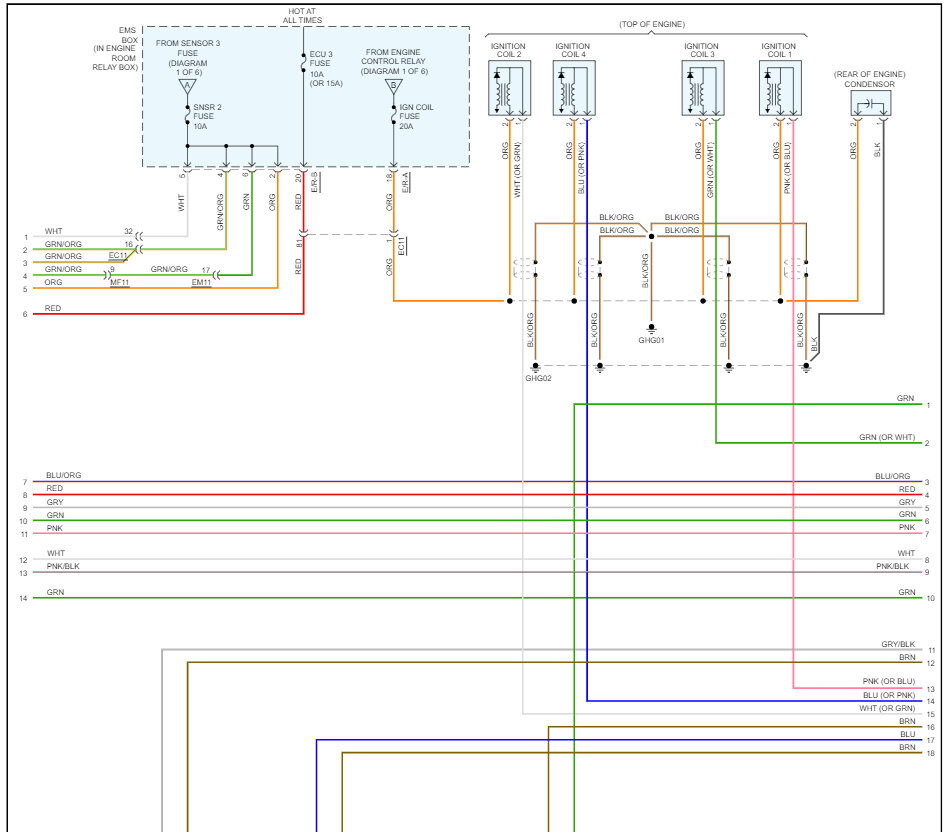

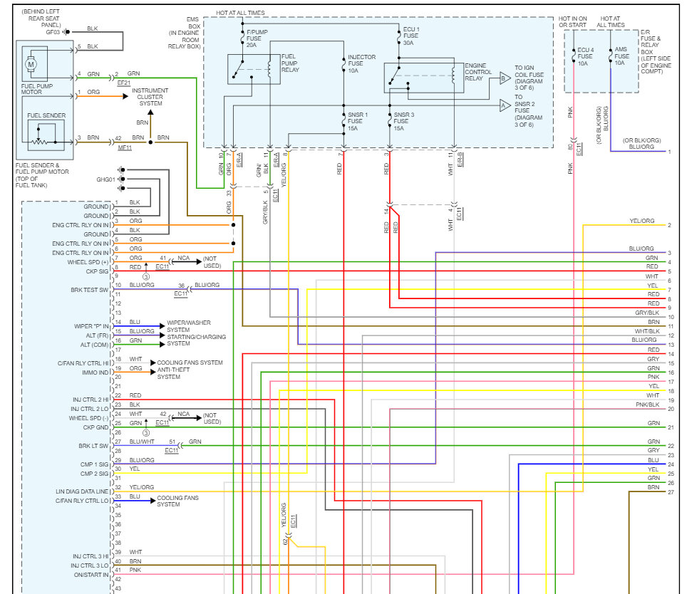

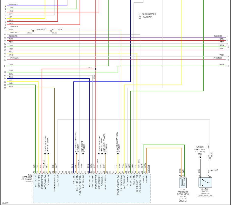

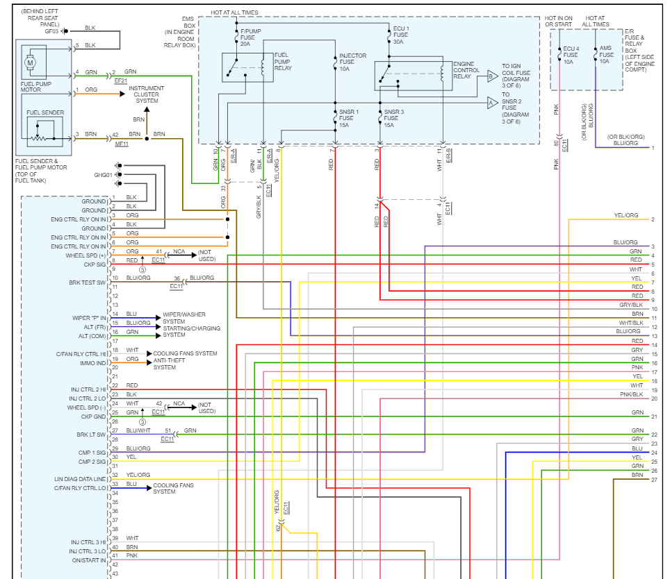

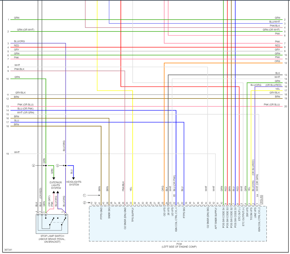

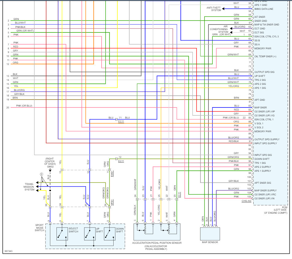

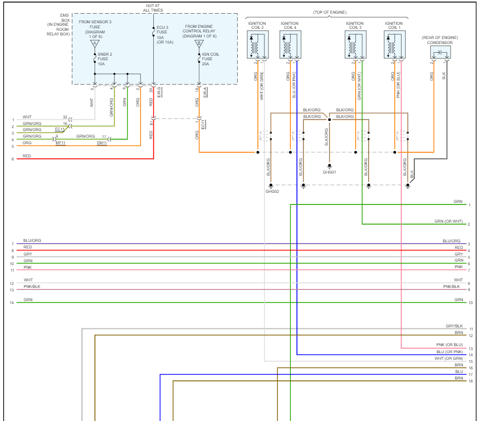

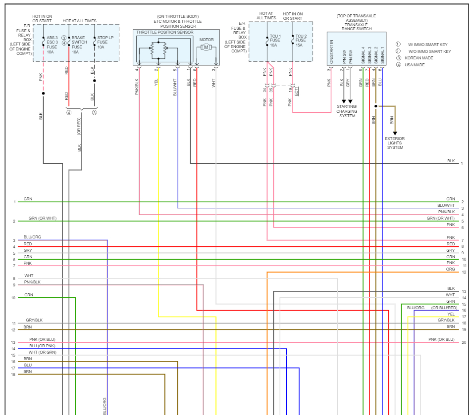

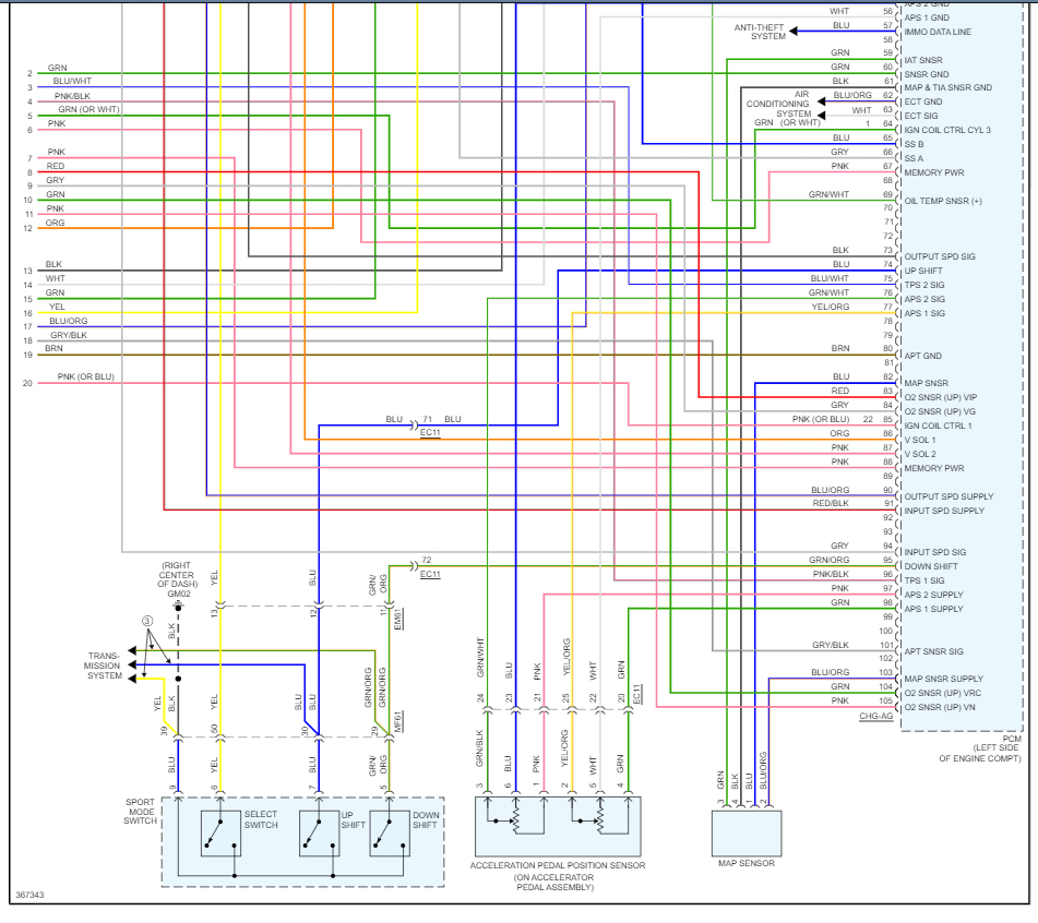

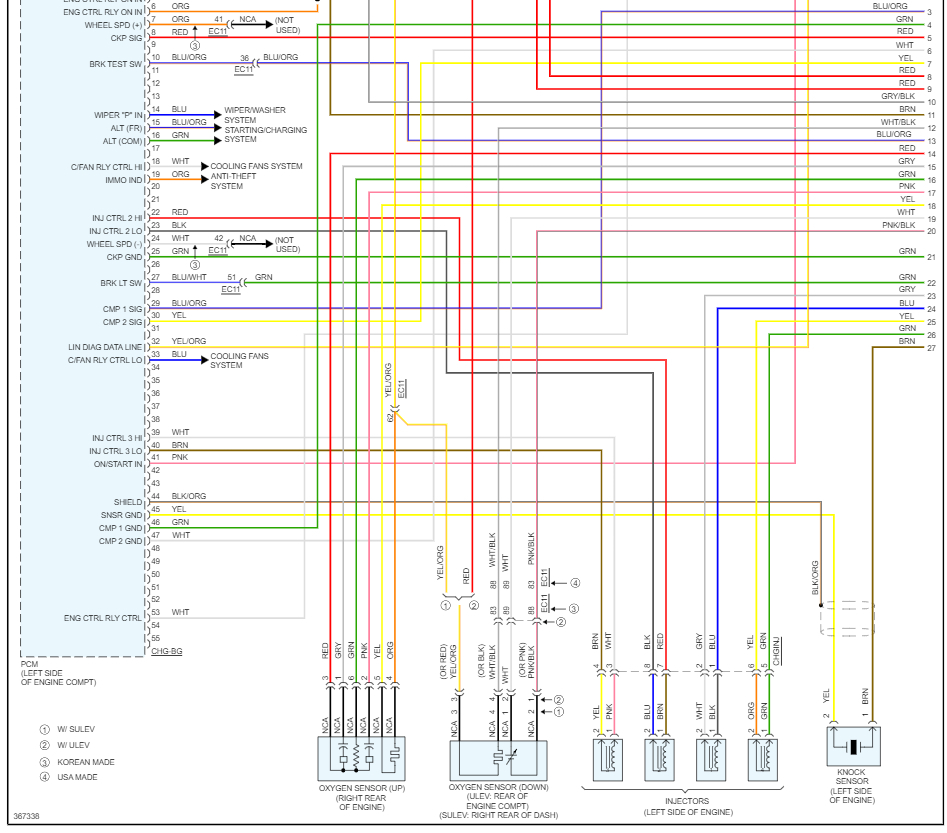

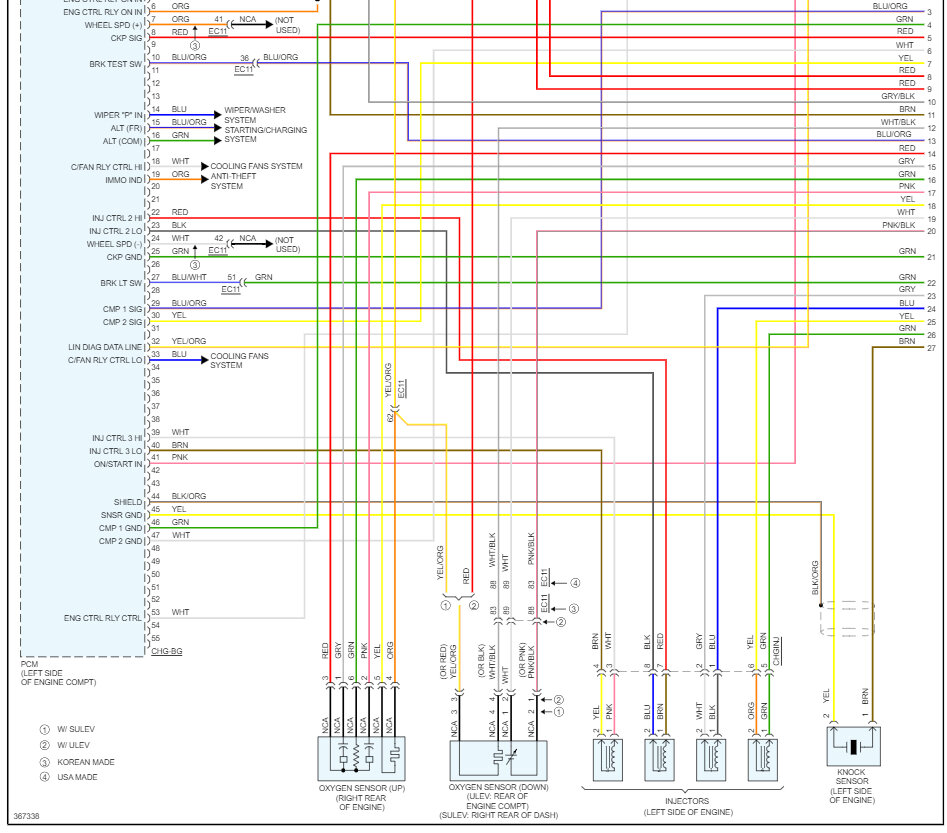

This is a circuit code so you may have a broken wire to the PCM. This guide can help you check, and I have included the engine and oxygen sensor wiring diagrams so you can see which wires to test and how the system works.

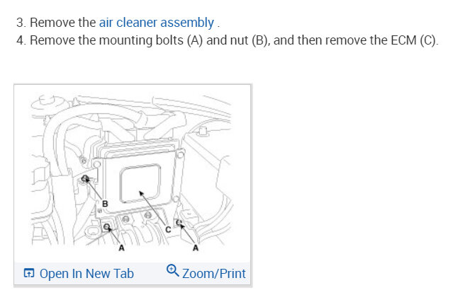

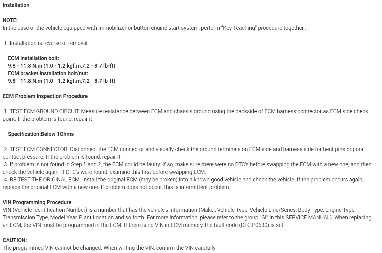

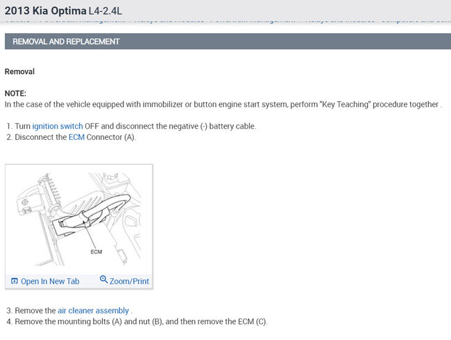

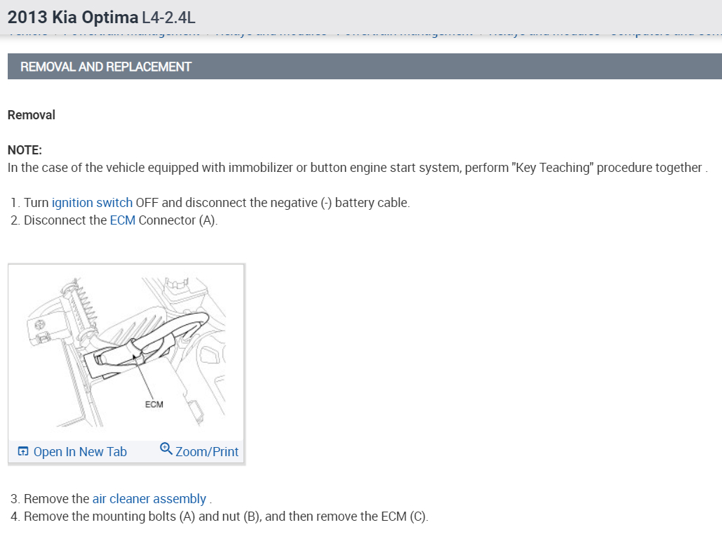

If the connections are good, you have a bad PCM, you can get a preprogrammed unit by searching Google or Ebay. I have included the instructions on how to change that out as well. Check out the images (below). Please let us know what you find.
