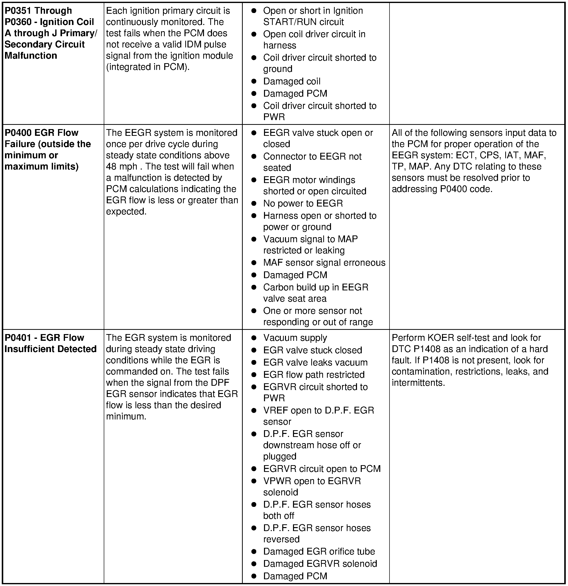

Based on the code, the DPFE could be bad, it could be disconnected or have a hose leak, a hose could be plugged...
Since you have already done so much, reconfirm there is no damage to the hoses to it. Also, I attached a list of components which will set this code. Read through them and see if it helps.

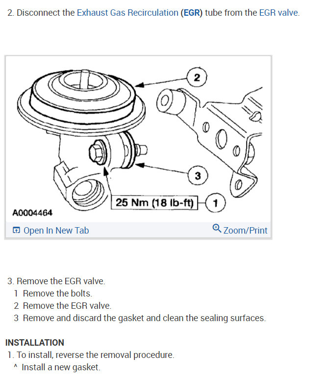

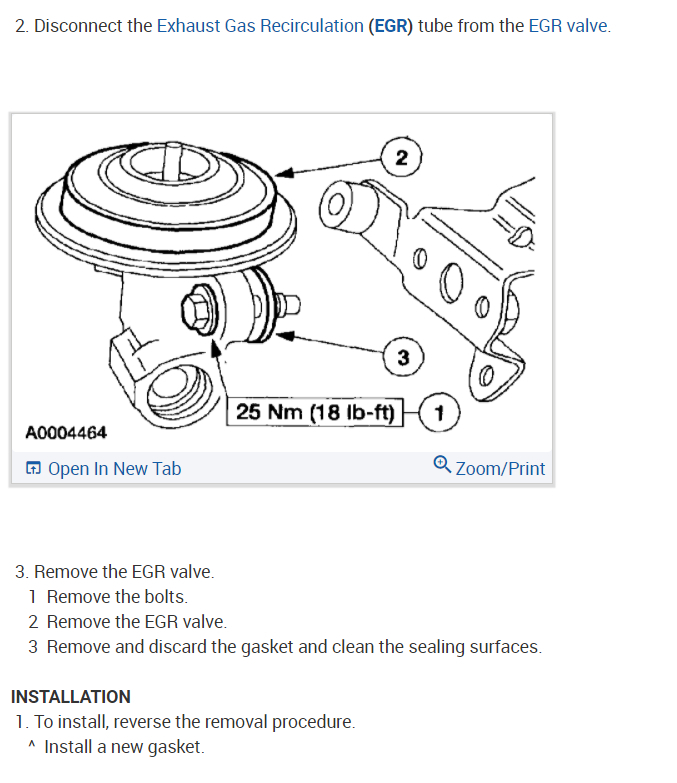

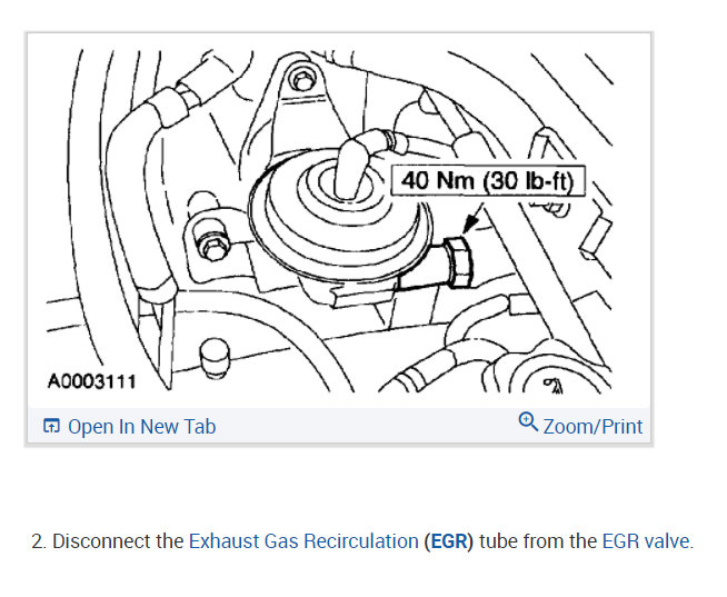

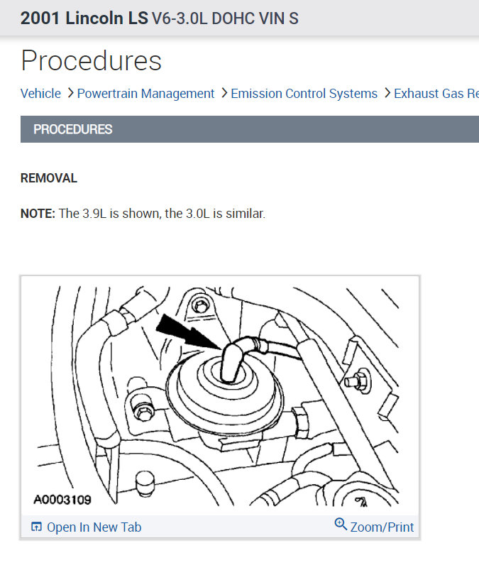

These cars had a problem clogging up the EGR exhaust passages. I would remove the valve to inspect to confirm the issue. Here are diagrams below to show you how. EGR test video:

Can you please shoot a quick video with your phone so we can see what's going on? that would be great. You can upload it here with your response. Check out the diagrams (below). Please let us know what happens.

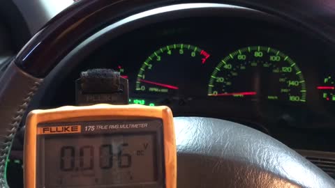

Yes, I’m leaning on tubes carbonized but there’s enough flow to shut off the engine at idle when adding vacuum to EGR valve. Not sure why this time around it didn’t shut off on the test just shaking the engine real bad. This video is power braking when ramping up idle and you can see the voltage follows.

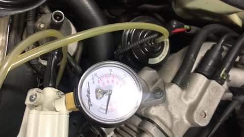

Here’s video of test to EGR valve. This time doesn’t shut off. Maybe carbon building worsened?
