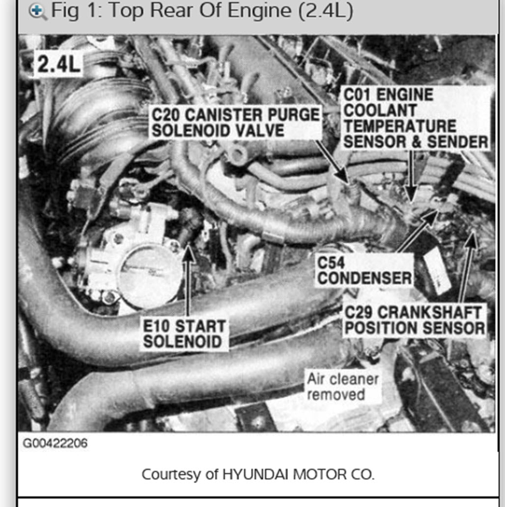

How do you install crankshaft sensor?
Sep 19, 2016 at 1:11 PM
HMAC300
  • 48,601 POSTS
undo bolt that holds it in and electrical connection twist and pull old one out. lube new sensor o ring then put back in and carefully hook electrical back up. do this with engine shut off.
