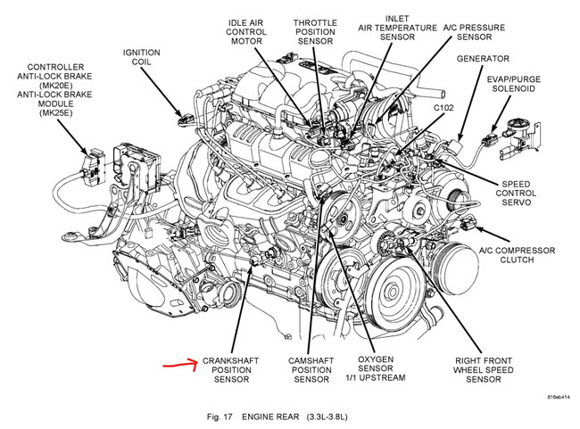

Having an issue with locating the crankshaft positioning sensor, 3.8L.

Yep, it is hidden on the right side of the engine block down low. Check out the images (below). Let us know if you need anything else.
