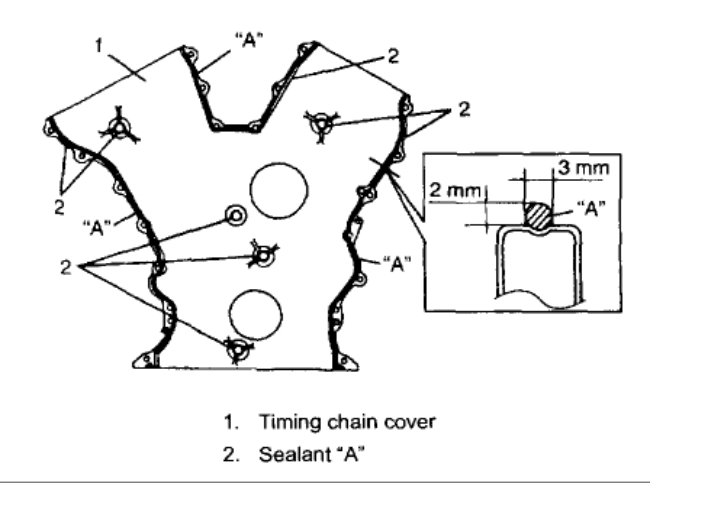

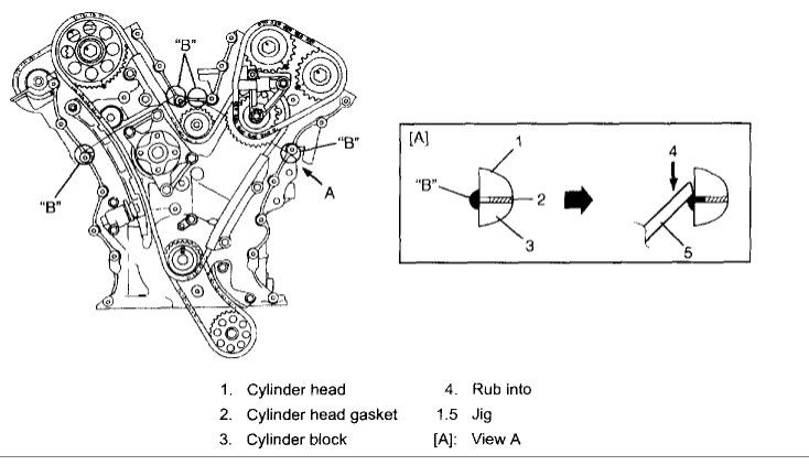

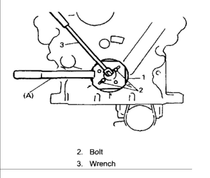

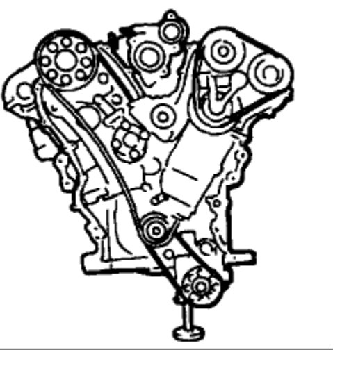

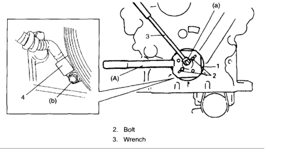

You are not going to believe this but it is under the timing cover near the crankshaft. Here are some diagrams of what you need to do to get to the crank position sensor. (below)

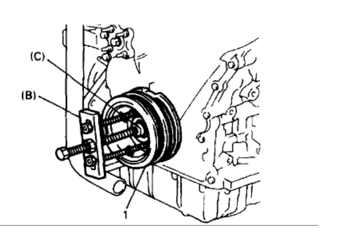

Here is how to remove the balancer
https://www.2carpros.com/articles/how-a-harmonic-balancer-works
