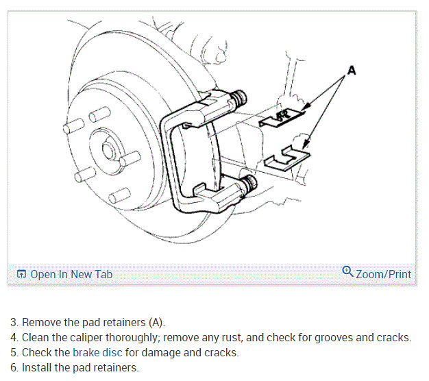

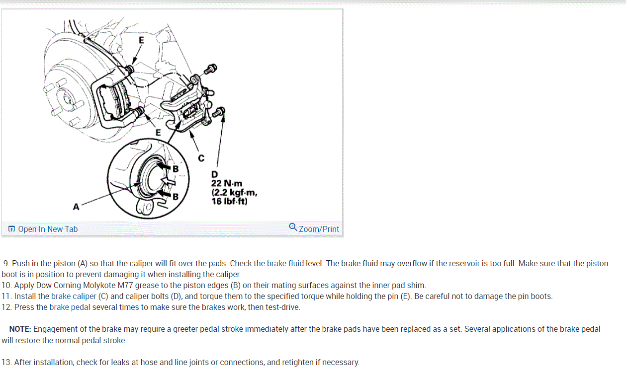

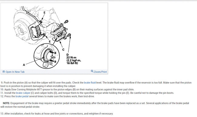

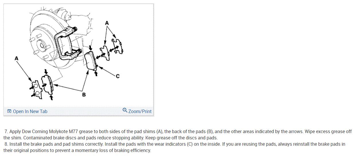

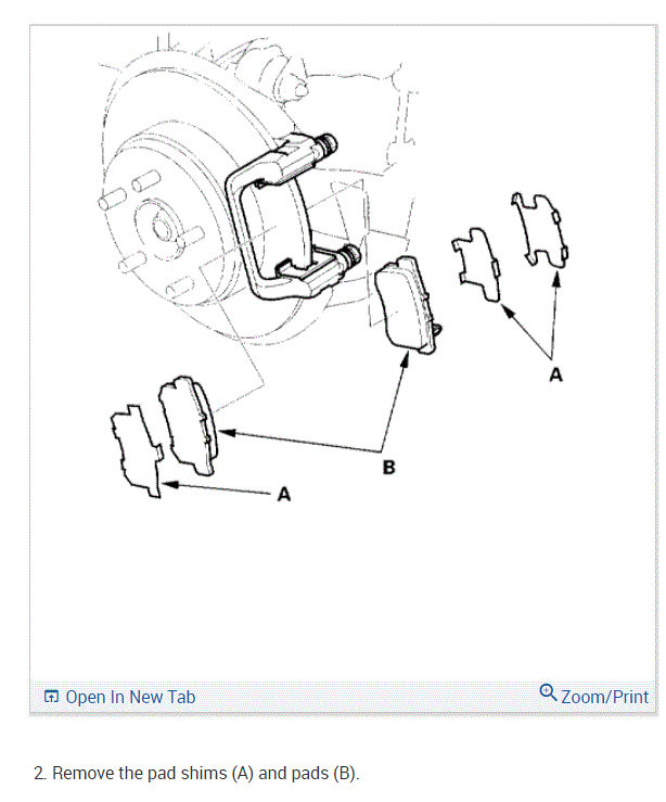

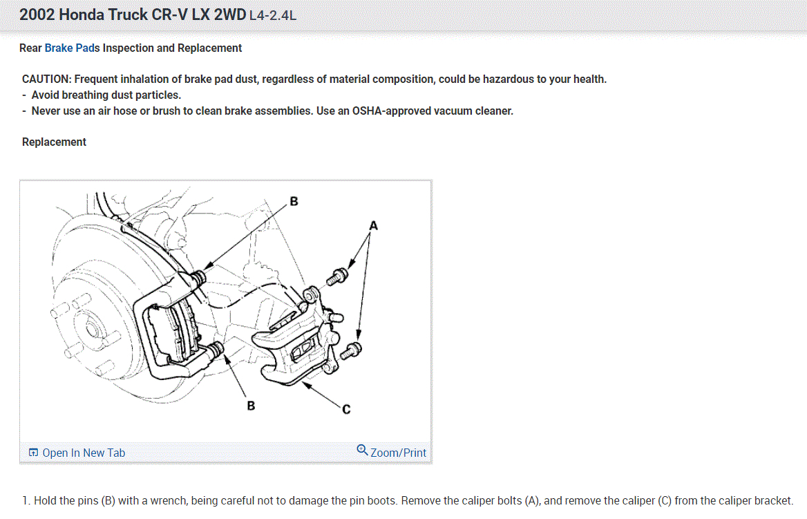

If you look at the attachments below, they include the directions for removal and replacement and inspection of the rear brakes. These are specific to your vehicle. Take a look through them and see if anything helps.
Something is allowing the pads to hang up. Make sure everything is moving freely including the pads.
