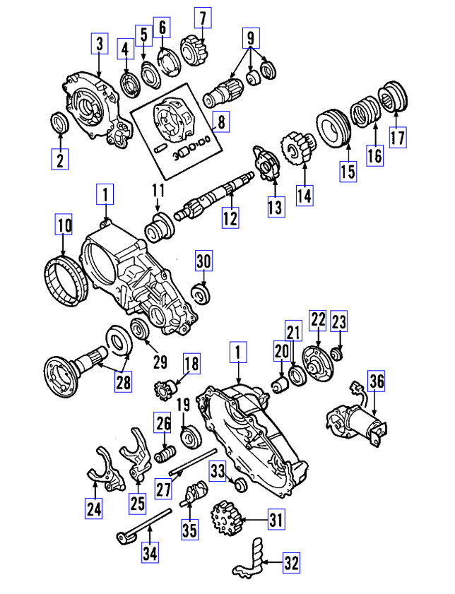

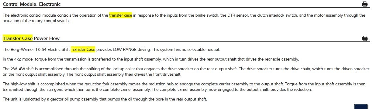

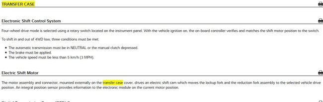

Yours is the live axle assembly. Basically, the connect/disconnect is done at the transfer case, instead of at the hub, which means that you do not have to manually lock and unlock the hubs.

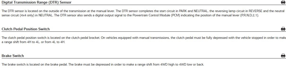

The images below describe how the transfer case works.
You might try simply unplugging the 4x4 switch and see if anything changes. I have seen 4x4 problems (such as unwanted operation) to simply be a short in the switch. If it stops when the switch is out, then we can (1) look into further testing of the switch or (2) simply get one from eBay or the local salvage yard.

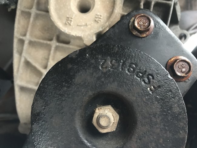

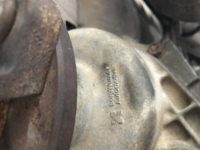

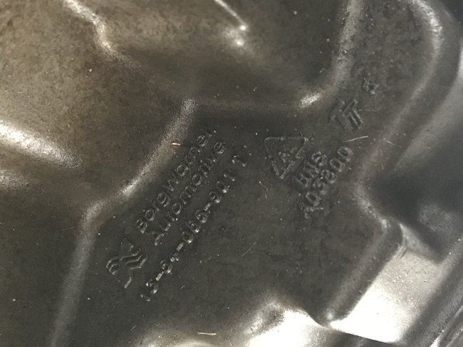

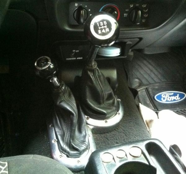

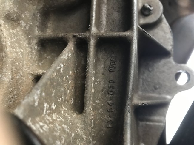

2002 4.0L V6 Fx4 Off Road model. The linkages look fine to me and the hardware that secures it is tight. It shifts through all the gears fine so I do not think that it needs greased. I do not have a VIN on it I believe. It is a Borgwarner model 13-54. Here is the rest of the numbers that are on the transfer case.

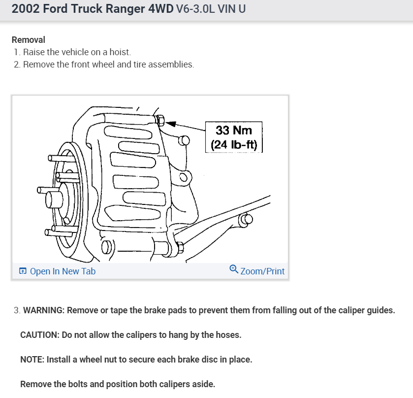

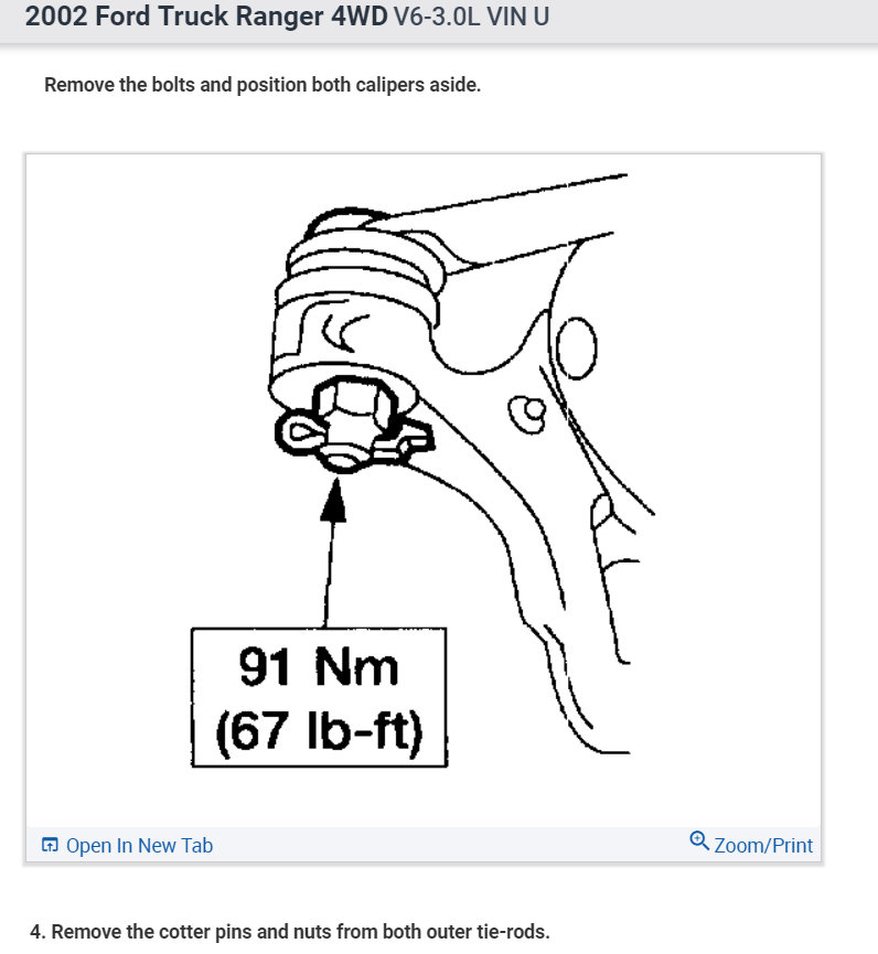

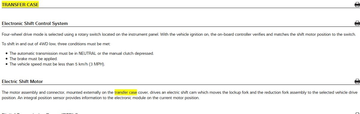

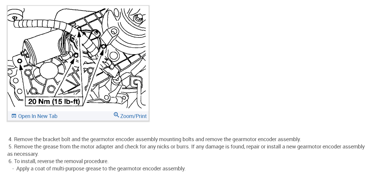

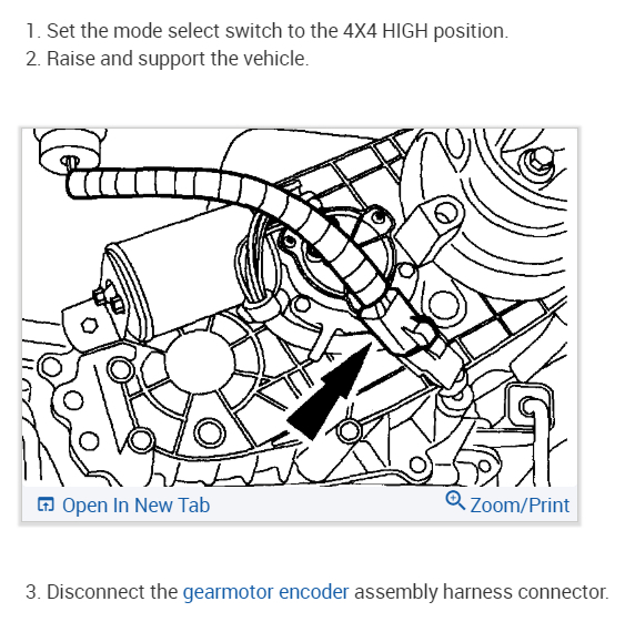

It sounds like the encoder motor is not pushing the transfer case all the way into gear. I would start by changing it. Here are diagrams to help you see how the system works and how to change the actuator. Check out the diagrams (below). Please let us know what happens.

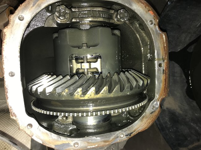

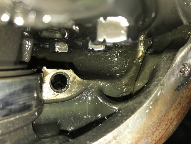

Okay, so new diagnosis. The front differential is out of the question now. I took off the front drive shaft and drove my truck around and the problem is still there. While it may still be the transfer case I am leaning towards more the rear axle is messed up. Took off the cover and there was quite a bit of shavings and metal chunks inside. Only saw some minor damage to one gear. The pencil sharpener style gears is what i’s on the inside but they have a cover around them which is what “The Medic” was talking about. Going to look up what could or might be causing my problem and see about taking the differential apart further. (Yes I did take off the bracket on the left side)

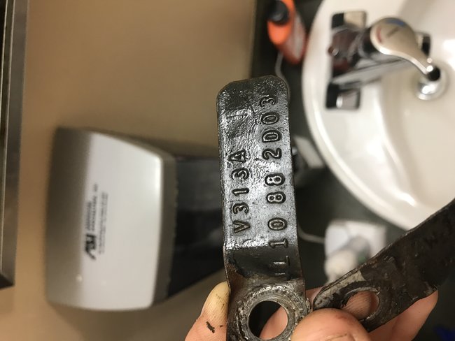

V313A
4L10 88 2D03
Nov 30, 2018 at 6:07 PM
CJ MEDEVAC
  • 11,004 POSTS
That is the tag on the outside, probably the original set-up.
I am guessing this is not original innards? Anything stamped on the big ole spindle on the inside (edges or the flat parts)?
Surely they were proud enough to put their name on it somewhere.
The Medic

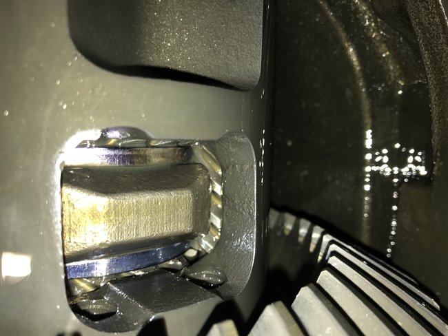

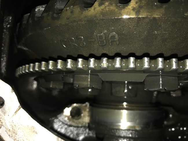

CR3-BA is stamped on the big gear in the differential.
Nov 30, 2018 at 6:49 PM

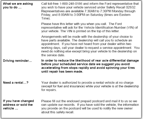

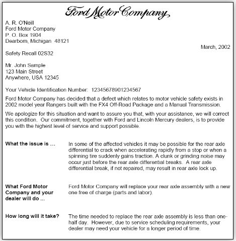

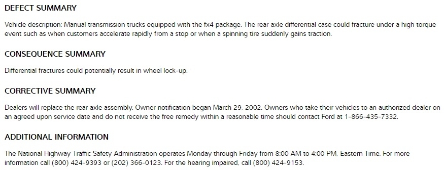

I did find this a few minutes ago.
I do not know if it will help you now.
The Medic
Dec 1, 2018 at 6:17 PM
CJ MEDEVAC
  • 11,004 POSTS

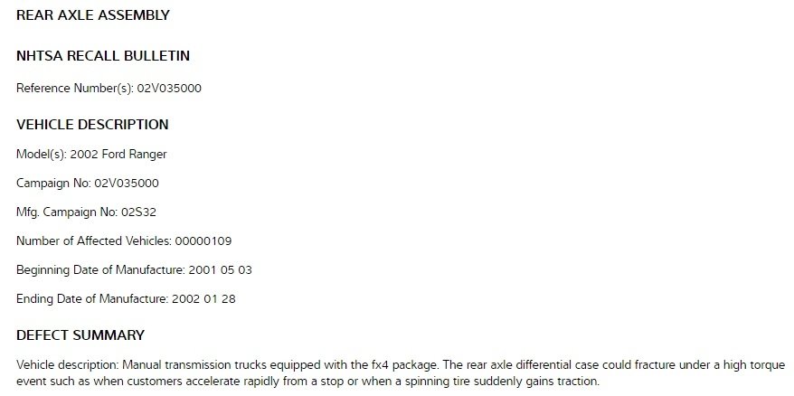

This is probably the same thing.
The Medic

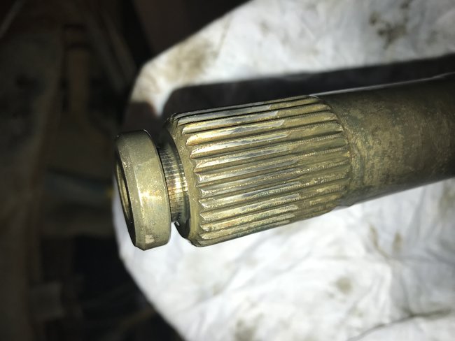

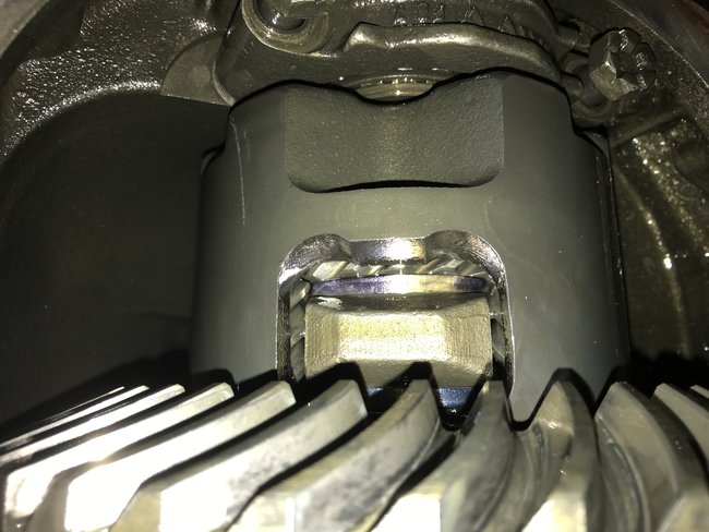

Anyway I can still get that deficiency corrected? I opened up my differential further and there is quite a bit of shredded metal in there. Here is one of the axle shafts I pulled. Do not have enough experience to know if it is bad or not.
Dec 1, 2018 at 6:26 PM
CJ MEDEVAC
  • 11,004 POSTS
If there are no chunks missing, the splines I can see in your picture look just fine.
I believe your problem is in the differential itself, so far I have not found an exploded view or anything except that recall that might shed some light on exactly what might go wrong with the differential.
Maybe one of those phone numbers or some homework might, at minimum, hook you up to a Ford tech guy that might tell you what their solution was (rebuild, replace, replace with a different unit).
It would be nice if it was still considered an issue and they might take care of it.

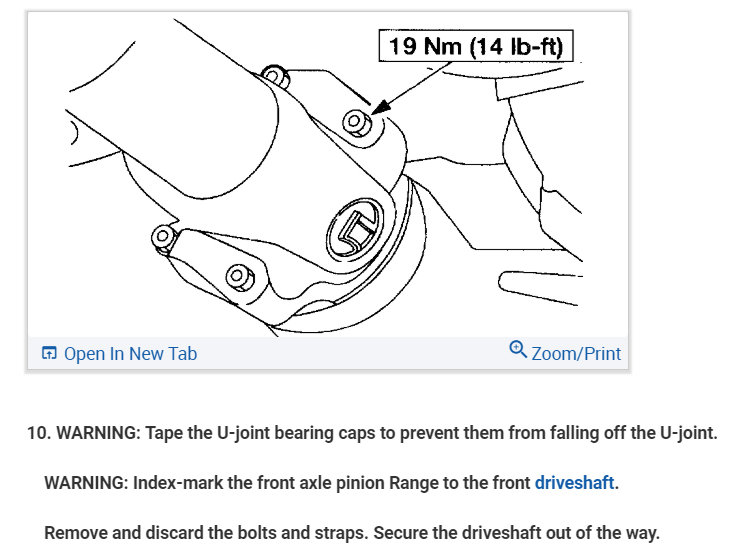

Dec 5, 2018 at 6:54 AM

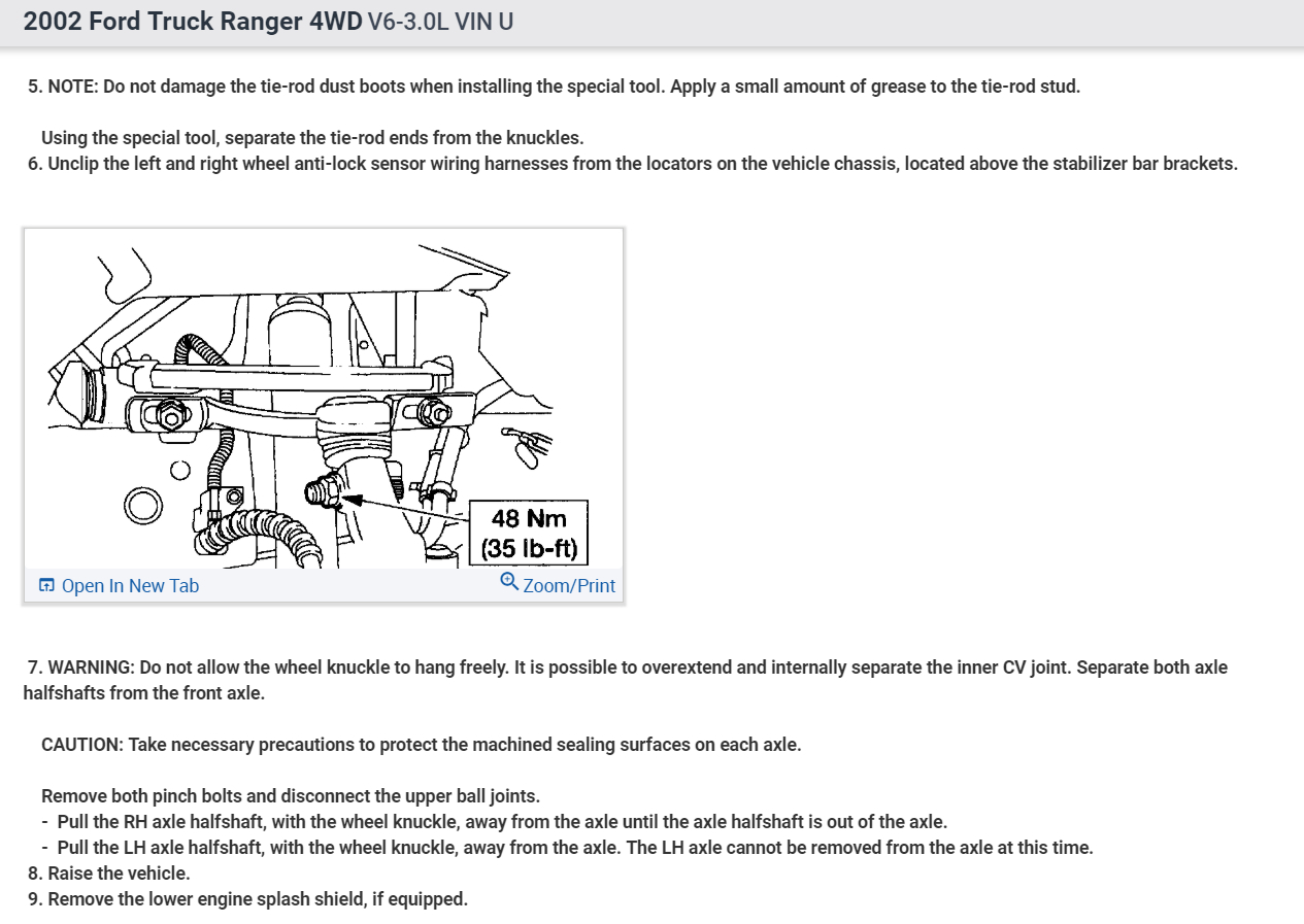

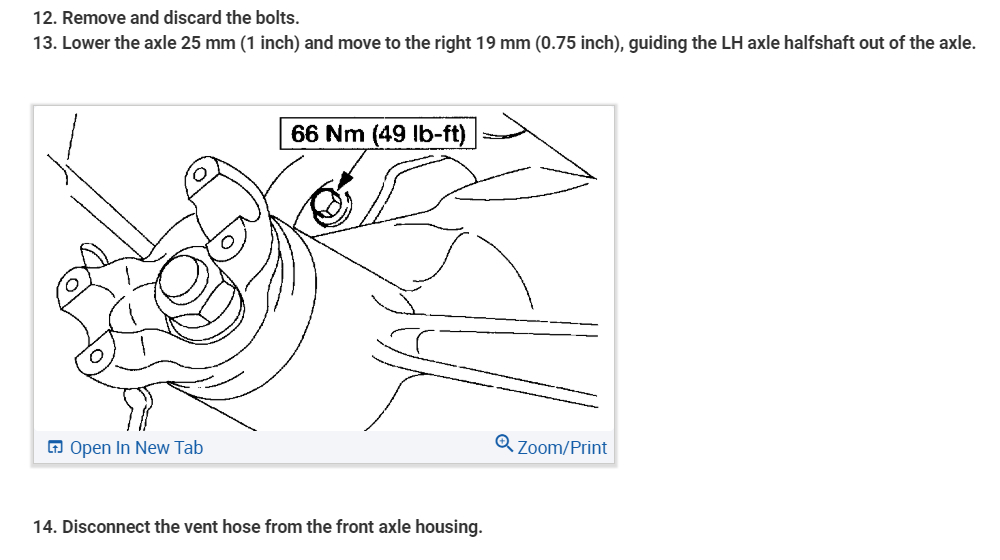

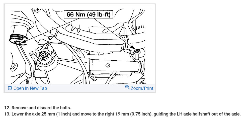

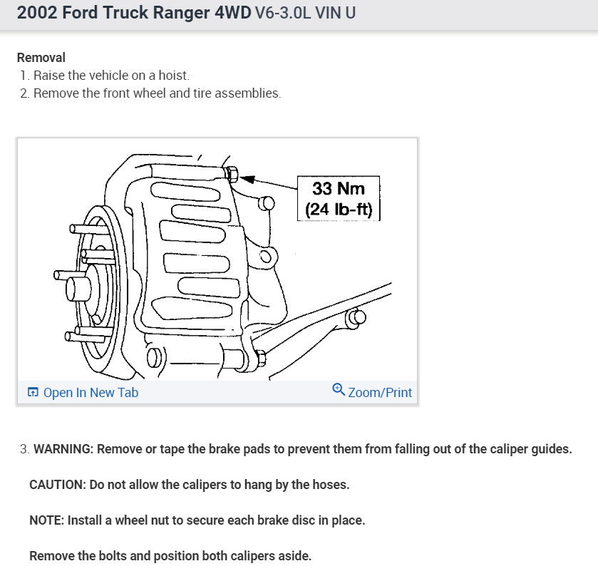

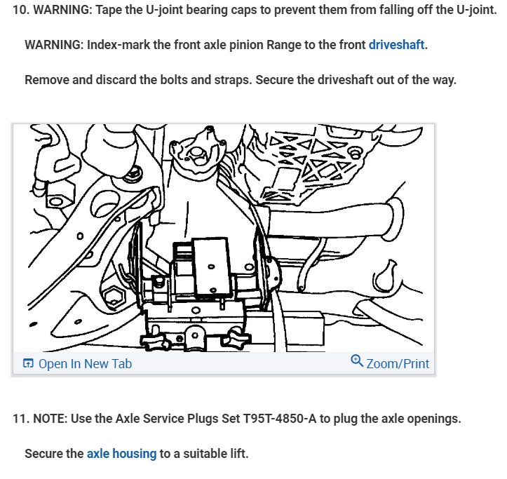

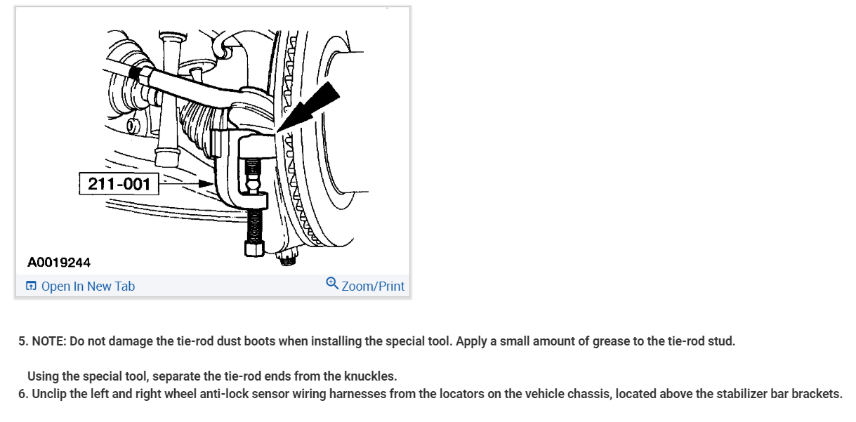

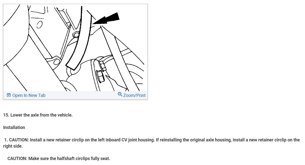

Yep, you are headed in the right direction. Here are diagrams and instructions to help show you how to remove the front differential:
