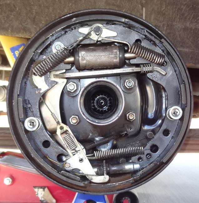

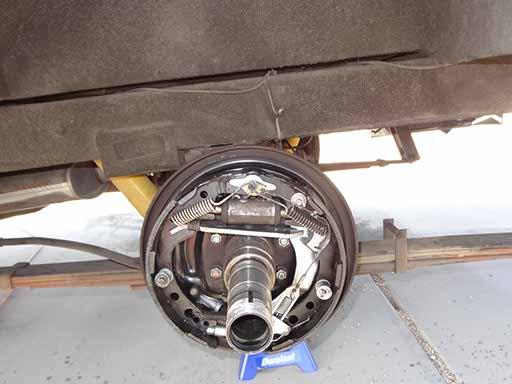

See photo: are the rear drum brake springs in the correct positions?
1985 TOYOTA PICKUP
75,000 MILES
PCMENTOR29
  • 177 POSTS
This is from a 1985 Toyota Motorhome. My rear brake shoes went down to metal after less than 5000 miles. I am wonderning if they were put on incorrectly. I am doing this myself. In the picture I included you can see the lower spring is touching the self adjuster wheel. This doesn't seem right. Can you please send me a diagram or picture of a correctly done job? With the springs and parts in the right place? The Haynes and Chilton only show for half-ton and these are a 1 ton full floating axle which replaced the original axle on this motorhome. These axles were sent by Toyota to National RV who made this motorhome. Thanks

This is a common Chrysler brake and I see two things that are noteworthy. First of all, you're right about that lower spring. It is supposed to be in the largest hole on the right side; one hole higher. Chrysler is famous for making parts that interchange and / or have multiple uses. In this case that hole the spring is in now would be used to pound in the pin for the adjuster lever when new linings are bonded on and that frame is used for a rear shoe.
This should be the right rear brake. The lining on the right which should be the front of the vehicle should be the shorter lining, and the left one, what's left of it, should be longer.
The second thing is the parking brake lever hanging down behind and from the left shoe. That lever is supposed to be all the way back. That lever is held forward like it is in your photo when the cable gets rusted tight in the applied position. There's two things to verify that is what caused the linings to wear so quickly. First look at where the two shoes contact the large anchor pin on top. If either one is being held away from that pin the front shoe will grab too easily and commonly cause easy rear wheel lockup under light braking.
The next thing to look at is the parking brake strut bar running right under the wheel cylinder. With your thumb you should be able to push that bar forward a good 1/8" against the pressure of the anti-rattle spring on the right. You'll find your bar is tight between the two shoes because the parking brake lever is being held forward. That lever should be pried rearward to create the 1/8" play in the strut bar.
It's a little hard to see for sure but it looks like the front shoe is being held away from that top anchor pin. Also, look at that Chevy bow tie-looking metal bar on the anchor between the two shoes and the two return springs. It looks like the hole is not centered on the anchor and it's too far away from the shoes. That needs to be lifted up so it snaps closer to the shoes. That will let the return springs seat fully and it will prevent the shoes from moving 1/8" away from the backing plate and chattering when they don't hit the drum squarely.

Thanks for your expert reply. I am going to work on it in a couple days. I will post what I find. I printed out your reply and will check each thing you suggested. You are right, it's the passenger side rear wheel in the picture. Thanks

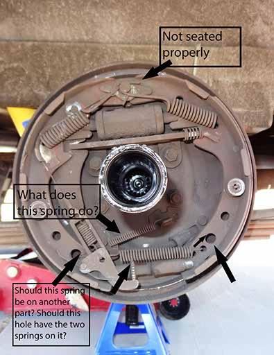

Hi, I am waiting for the new brake drums to get here. I had more questions though about the springs. Please see the attached photo. Can you tell me what the small, long spring is that anchors to the backing plate and the rear shoe? Should it be in another place? What is it for? Thanks

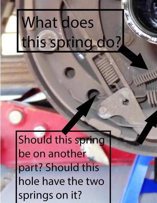

Here's a closeup crop of the two spring hooks.

What I have learned is this is a duoservo type brake and has a backup adjuster vs the parking brake activated. Am I right here? From the Toyota EPC diagram(Village Toyo site) that extra spring seems to be just an extra secondary shoe tightener attached to the backing plate. It may work with the movement to allow the adjuster to function. Can you input on this? Thanks

Sorry for taking so long. Went to a friend's body shop to help with two smashed vehicles. He specializes in rebuilding one and two-year-old Chrysler products.
That spring of which you speak is not standard Chrysler issue and I don't have an answer. That tab is spot welded to the backing plate which suggests it was a Toyota modification with a specific purpose, but my only guess is it was to prevent a moan or chatter. It's going to pull both shoes forward. Logic would say that is going to make the front shoe rub on the drum, but I'm sure the engineers had something in mind.
I'll keep looking for a better answer.
May 8, 2013 at 10:11 PM
CARADIODOC
  • 34,307 POSTS
Yup, it's a duo servo brake. The front piston pushes the top of the front shoe into the drum which rotates and pushes the bottom of the rear shoe into the drum through the adjuster. The rear piston pushes the top of the rear shoe into the drum. Those two forces acting on the rear shoe makes it a duo servo brake. That's also why the rear lining is longer. It does the stopping.
The shoes do adjust when backing up. Very few designs use the parking brake to adjust drum brakes. When backing up the two shoes switch jobs. The rear shoe gets pushed out on top and the cable guide pulls on the adjuster cable to raise the lever. I can't see any way for that extra spring to affect the adjuster mechanism.

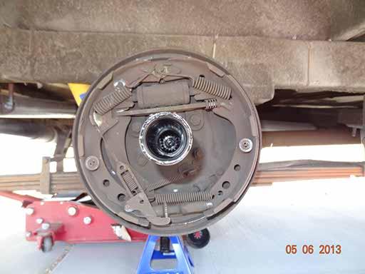

Hi I had a local mechanic put the passenger side brakes back together today at my house. $60. But it was like a puzzle. I took a picture of the barkes when he was done. Can you see any problems with it? What do you think a fair price for the otherside would be? Thanks

The only thing I see is the top metal bar needs to be pushed up a little. It should be centered on the large anchor pin, then it will pop back another 1/8" and the two return springs will sit deeper behind the head of the anchor.
I still don't have an answer about that extra spring on the bottom.
As for cost, that sounds reasonable if someone had to drive out to your place. You should be able to put the other side together by using this one for a reference.

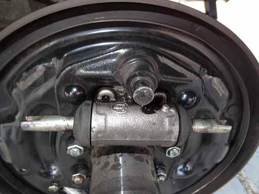

This job shakes my confidence a little because not only do I just have to remove the drum. It is attached to the hub and the bearing needs to be tightened and then the axle shaft has to be put in. I am afraid of not getting the bearing tight enough without a $60 tool I don't have. This guy seemed to get it tight enough though, no play in wheel. Thanks for your support.

Here's a pic of the lip the metal bowtie you were telling me about. I was able to do this side myself. It's hot right now but I will put the hub on later this afternoon. I didn't see the guy tighten the outer bearing nut but I think he got it tight by putting two phillips screwdrivers in two opposite holes and wedging another tool to turn the nut. I will try this. Your help gives me confidence, thanks.

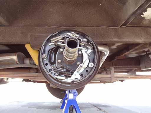

I forgot to ask in last post. Are the main return springs supposed to brush up against other parts? Here's two pics is this normal?

The two return springs appear to be correct. The only thing I can't see is the hook on the left end of the left spring. Judging from the gap between the spring and shoe frame it appears to be installed correctly. They could rub against the end of the parking brake strut.
If there is a pair of tapered wheel bearings in each drum you don't want to make the axle nut overly tight. Typically I crank them down as tight as possible with hand tools to be sure they're seated fully, then I loosen the nut, then tighten it again by hand. Over-tightening them causes the gear lube to squeeze out of the rollers resulting in metal-to-metal contact. You want just enough play to allow some lube to sneak in between the rollers and bearing races.
If the bearings use straight rollers the axle nut can be tightened more because it pushes on the inner race only. Nothing pushes on the rollers that will make the gear lube squeeze out.
