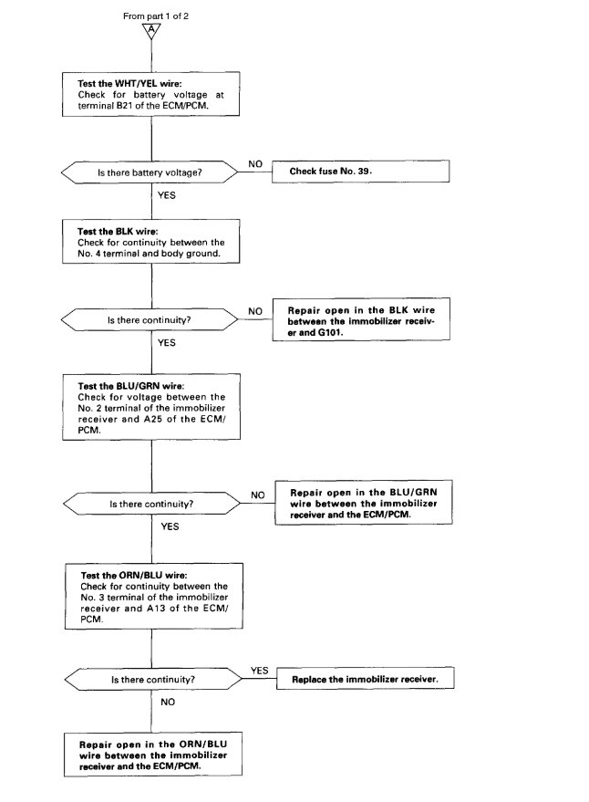

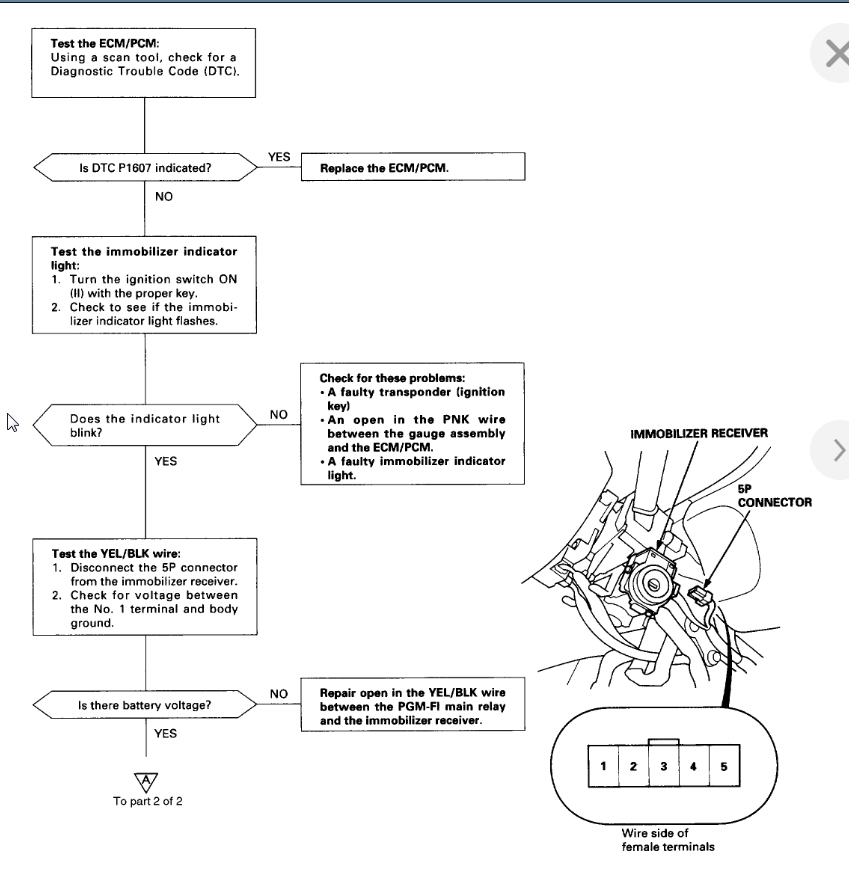

We need to scan for codes to start however, it is telling you with the flashing key that there is an issue there. Normally this means the key is the issue but if you have multiple keys doing the same thing then it could be the immobilizer or another module. I attached the testing that we need to follow to determine what the issue is.
Let me know what you find but I suspect it will be the immobilizer.
