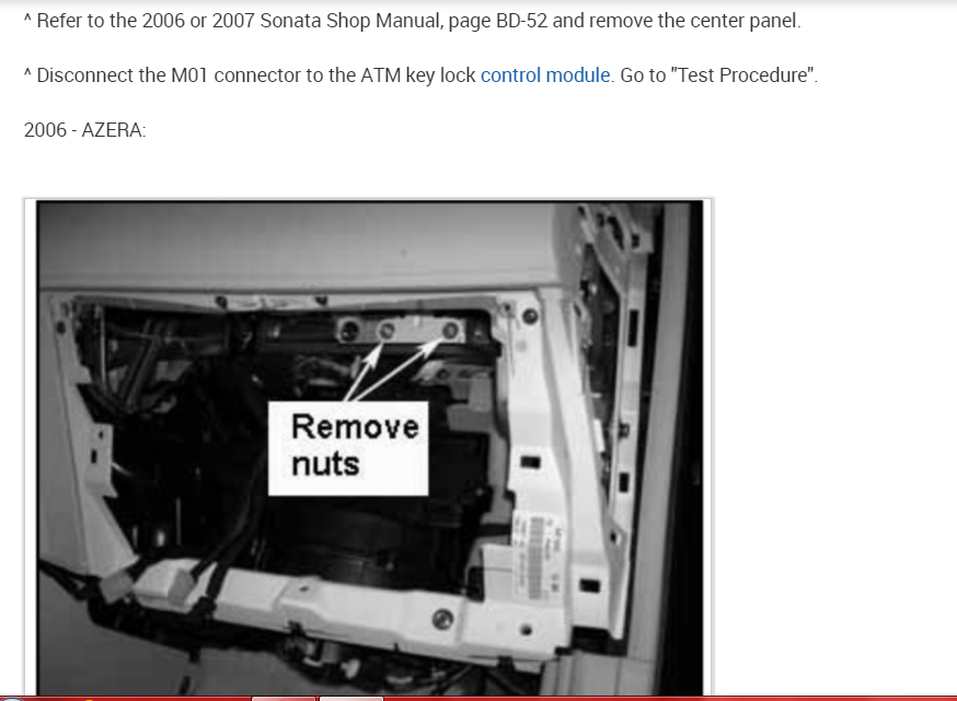

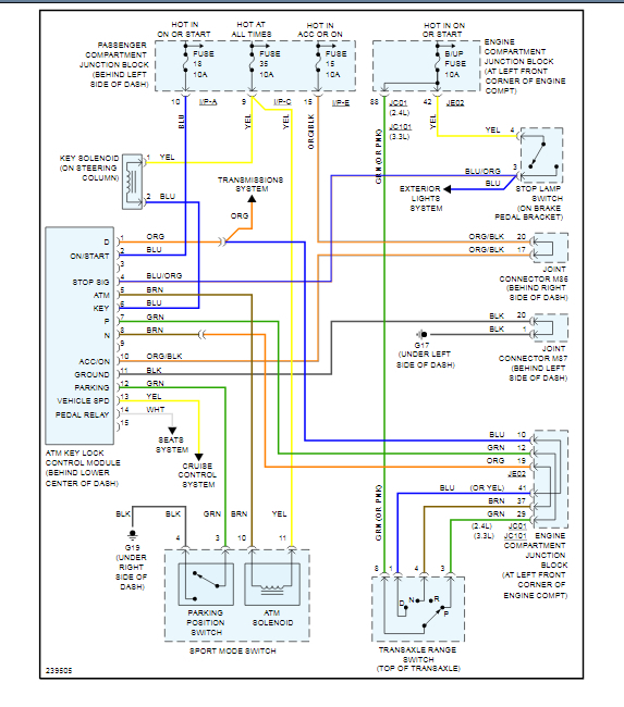

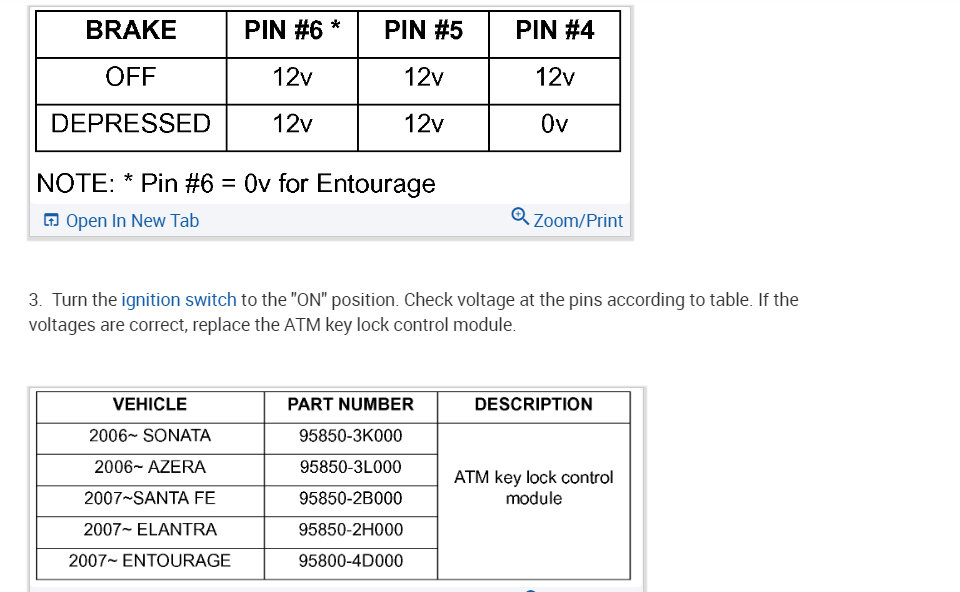

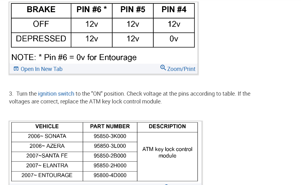

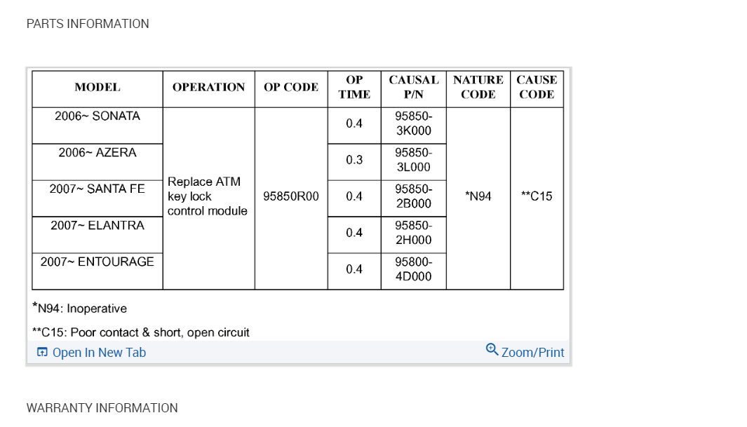

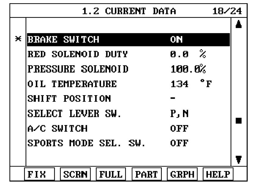

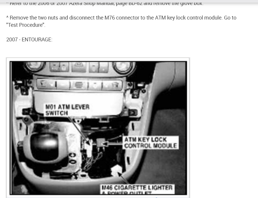

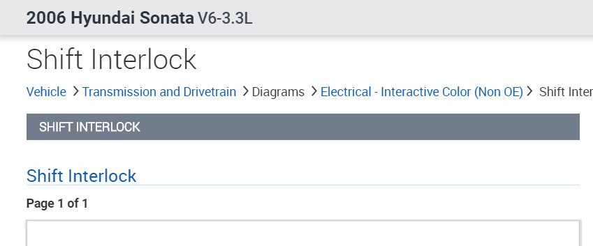

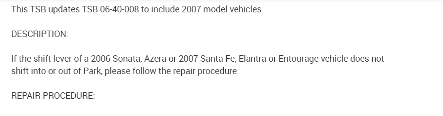

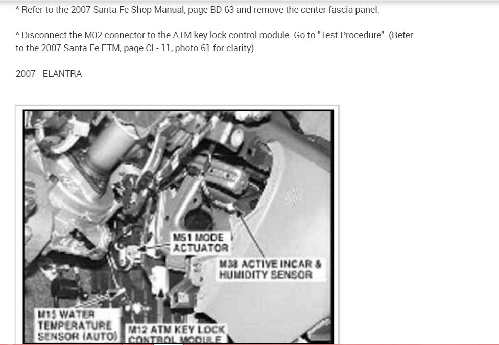

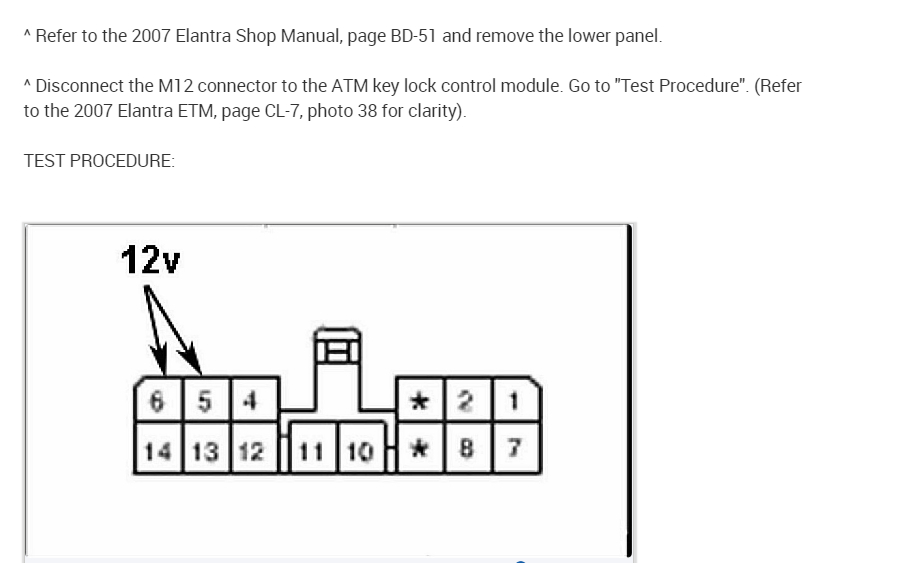

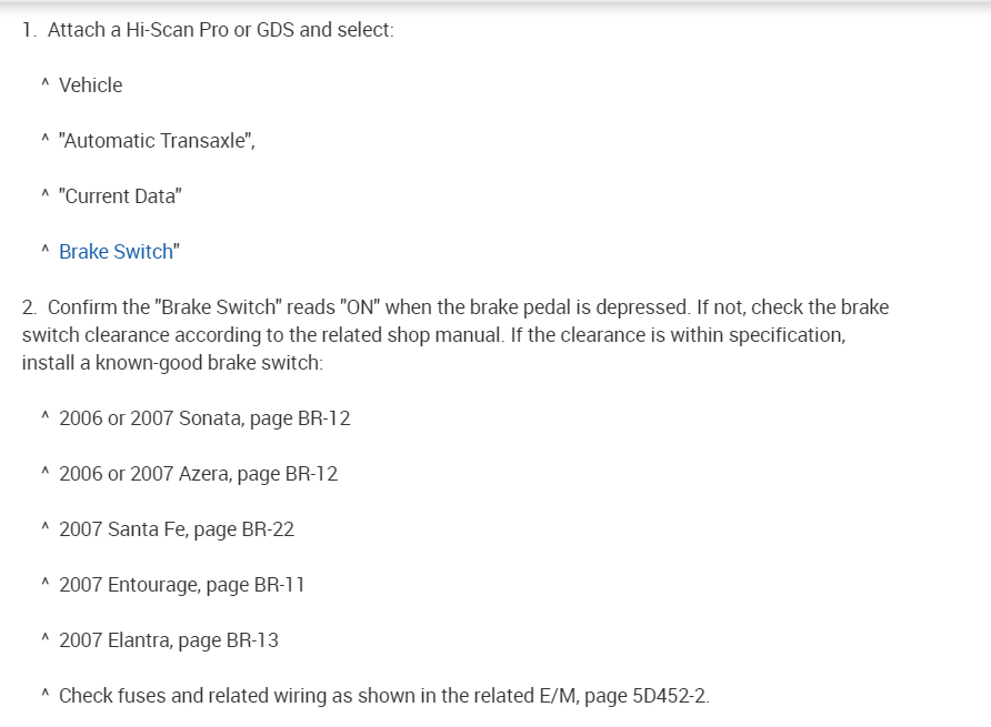

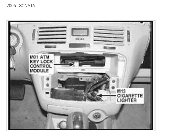

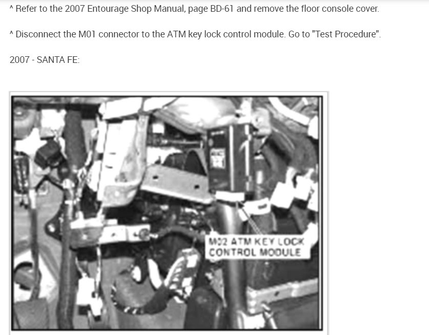

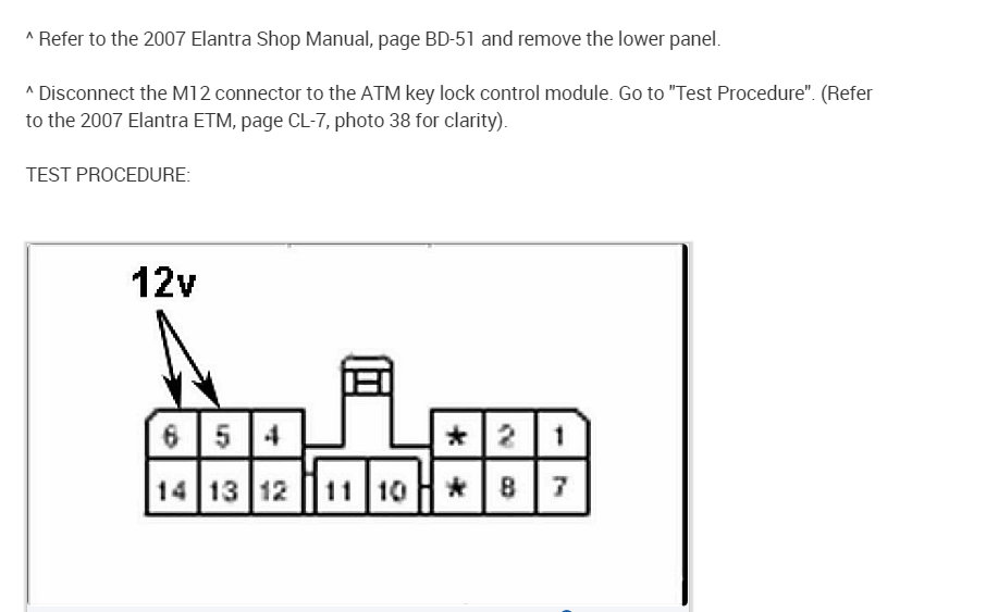

In the diagrams down below I have included a wiring diagram of your vehicle's shift interlock circuit and a Technical Service Bulletin (TSB) from the vehicle manufacturer with instructions on how to fix this very problem. Please go through these guides and get back to us with how everything turns out.
Thanks,
Alex
