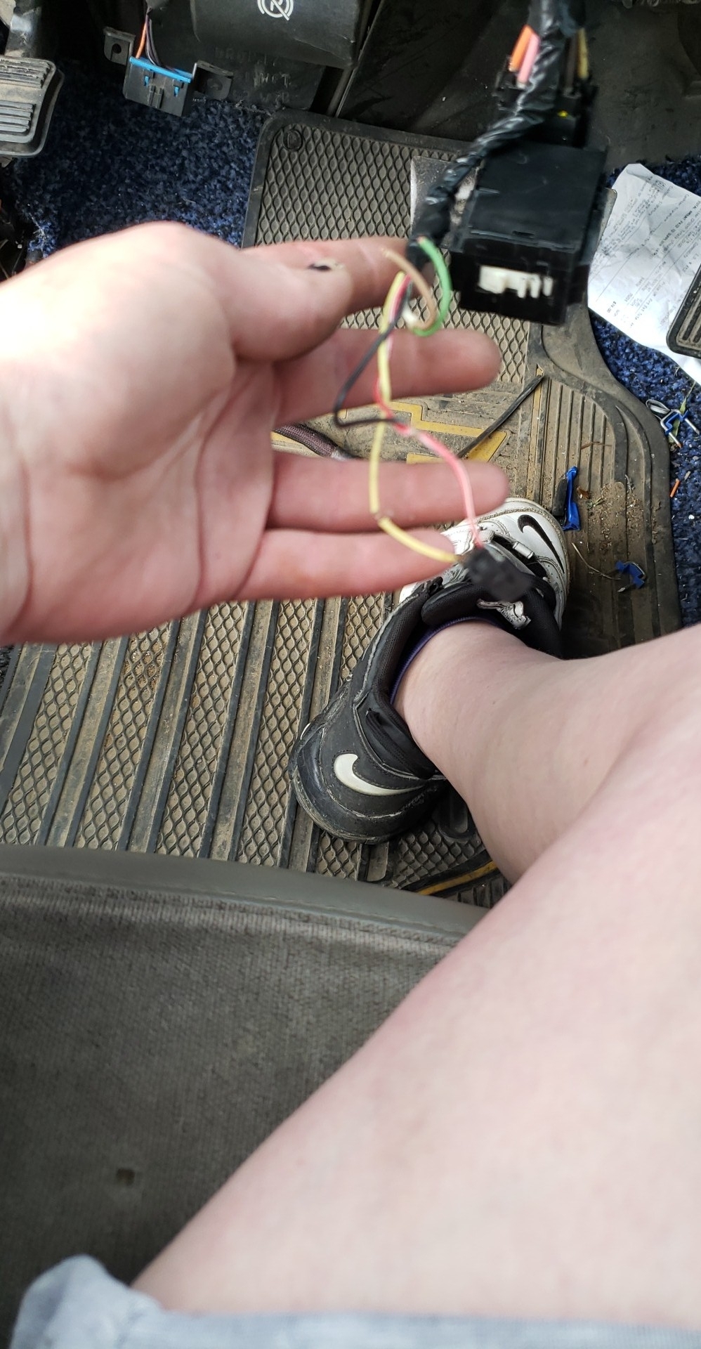

Okay, that makes sense. However, I have all the parts that were dismantled. the component that was attached to the lock cylinder just the wires were severed. Is it not possible to puzzle the pieces back together and maybe try a relearn?? I mean the tbar looking magnet is still in my lock cylinder they took a drill to it but still there. as long as I can get the wires back in place and located in the correct spot as if I've gotten my ignition back together, shouldn't it work??

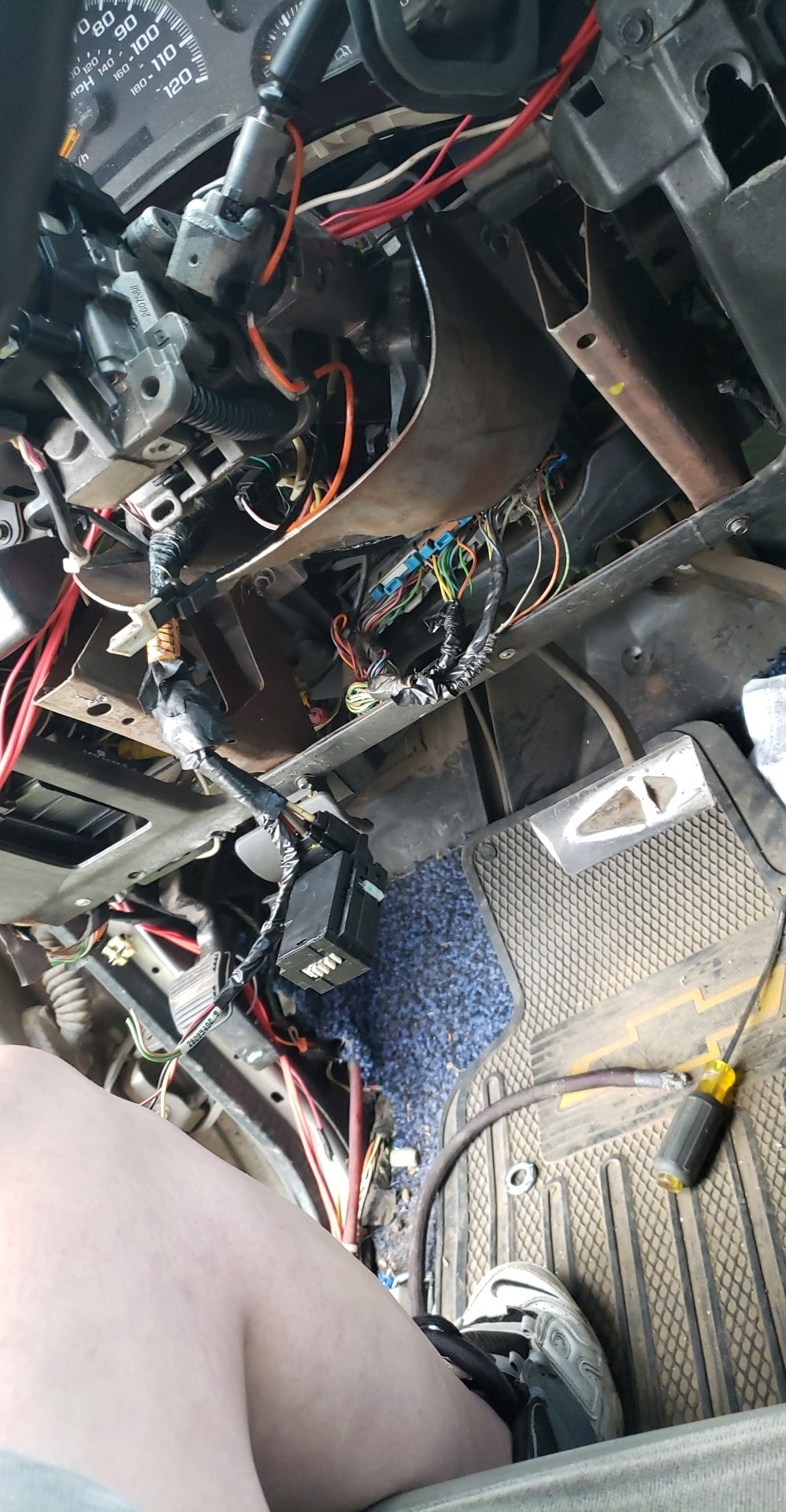

THE TAHOE CHICK
You can see the rod wire I'm talking about in the picture about six inches above the ignition switch. actually, gets the ignition switches gear to rotate. does that have to be pulled out so far or in so far in order for my truck to start??

The pass lock sensor is a part of the ignition lock cylinder housing where the key is inserted. The magnet is part of the ignition cylinder itself and is the piece that rotates inside the housing. They need to be a very precise distance apart to work. Another part of this is the anti-tamper section of the sensor. If the lock cylinder is removed the correct way, using the key to rotate it into position and then pushing the release there is no problem. You reverse that and it works. However, if it is removed by force like a hammer or slide hammer the anti-tamper part sends a signal to the PCM that someone is trying to steal the vehicle and it basically shuts it down, until it sees the new signal from the repaired system and then you can do the relearn. The mechanical ignition switch only selects the current path; it doesn't do anything for the security system side.
