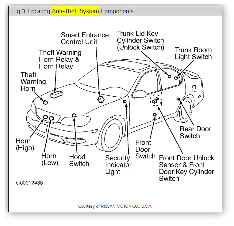

Here is how you reprogram the security system once the module has been replaced also the location of the sebrity system components in the diagrams below.

Check out the diagrams (below). Please let us know if you need anything else to get the problem fixed.
