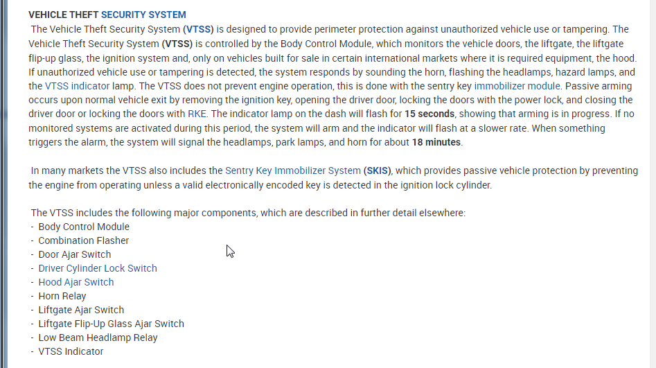

l lost my only transponder key.
Went to a salvage and inserted a different lock cylinder w/key. It will start and run 2 or 3 seconds and shuts off. I was told the body control module locked the system down.
If l go get PCM, BCM, lock cylinder and key from the same vehicle and install it all in mine. Will it start and run with no further programming?
