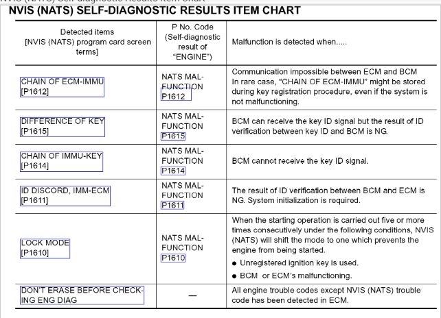

I have a solid security light while cranking. Won’t start. No power to fuel pump. I disconnected the battery negative cable. Waited 30 minutes. Reconnect and push fob lock fob unlock. Still has security light. Car has a smashed right rear door handle. Could this be the problem? Should I disconnect the door wires?
