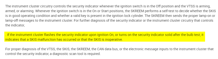

This all indicates that the key is most likely the issue. Please see the attachment. The SKIS or Sentry Key Immobilizer System requires the key and security system to acknowledge they are ok to start the car. Then they send a signal to the PCM to allow the car to start.
When the light flashes or stays on it means this system has failed.
If you can scan the computer with a scan tool that will help identify what the issue is. Let me know what you find and we can go from there. Thanks

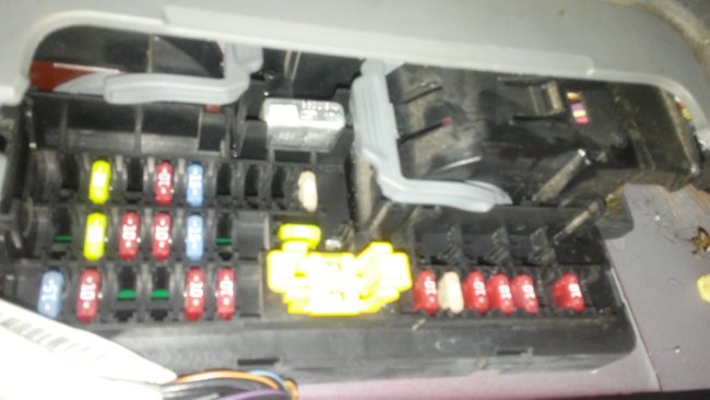

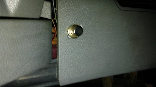

Yes that's what I'm saying ' I put the Aluminum foul in the fob for better contact and it worked. No i do not have another key and I've been looking for this Mysterious Valet/override button and can not find one ' I had a mechanic take a look at it today ' and he got under the truck and did something to the starter and the engine did make an attempt to turn over. He said the battery was may have a dead cell 'but i don't think that's the issue. I checked and My battery was at 12.7 when the truck is not running but when i did a scan it said low voltage system besides the jerk stole a screw driver and my Micro Mechanic scanner i had plugged in the truck so i don't truck him a thing he said, He did say that he think the key needed reprogramming though. the other thing is ' i checked all the fuses and the fuses in the little yellow clip did not light up but they are not blown that's weird seeing that these are the two fuses they say to take out to do a soft reboot of the security system.. I've sent a picture of that ' and some Mysterious button down by the kick panel someone had installed inside the truck before i bought it.

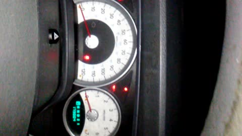

Other picture and video of security light light.

I prayed a lot and my prayers was answered. Wicked demonic security system. The security light was flashing and absolutely will not go away while trying to start the vehicle.The engine Seems dead, No sound at all 'except for a click from a relay down by the kick panel will not start.
the key will open and lock the doors just wont start the truck. I tried all those tricks locking and unlocking the doors 'pulling out the two fuses that's paired together ' none of that worked..
