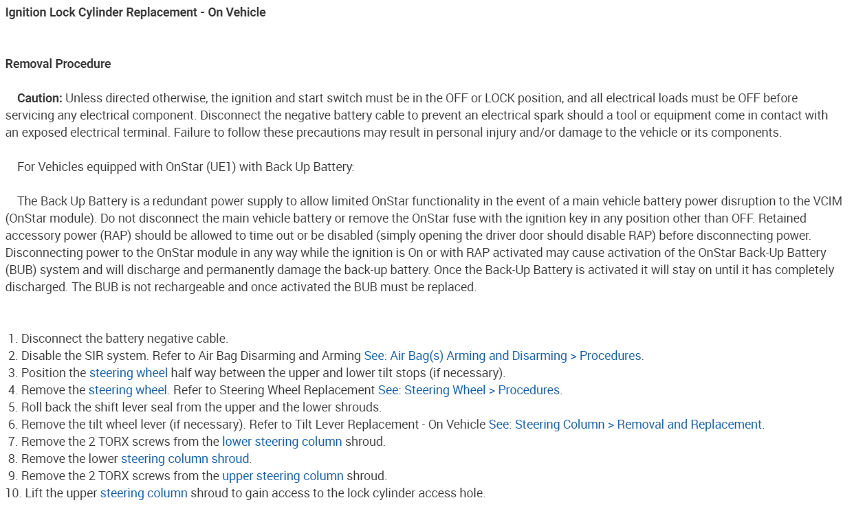

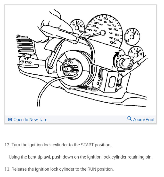

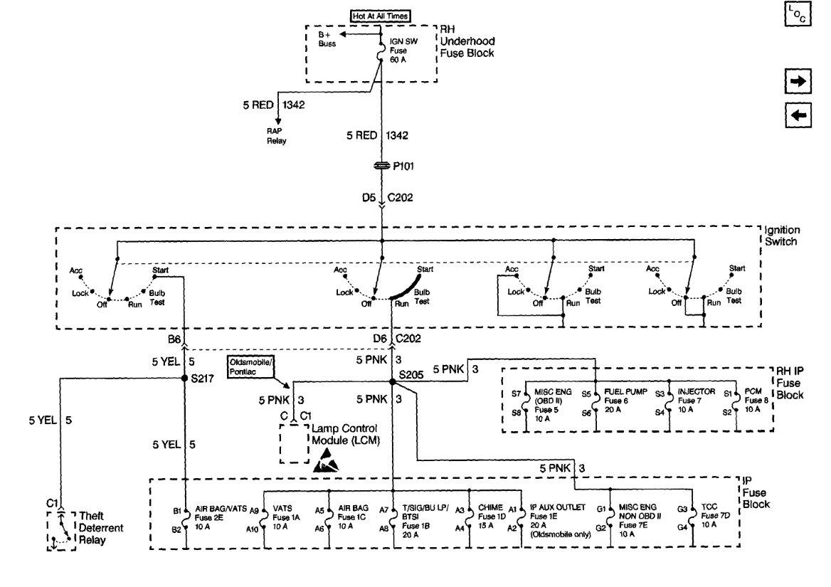

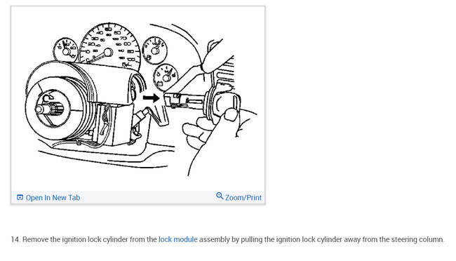

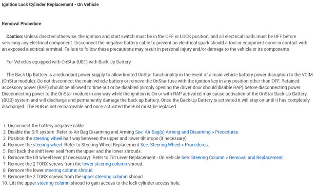

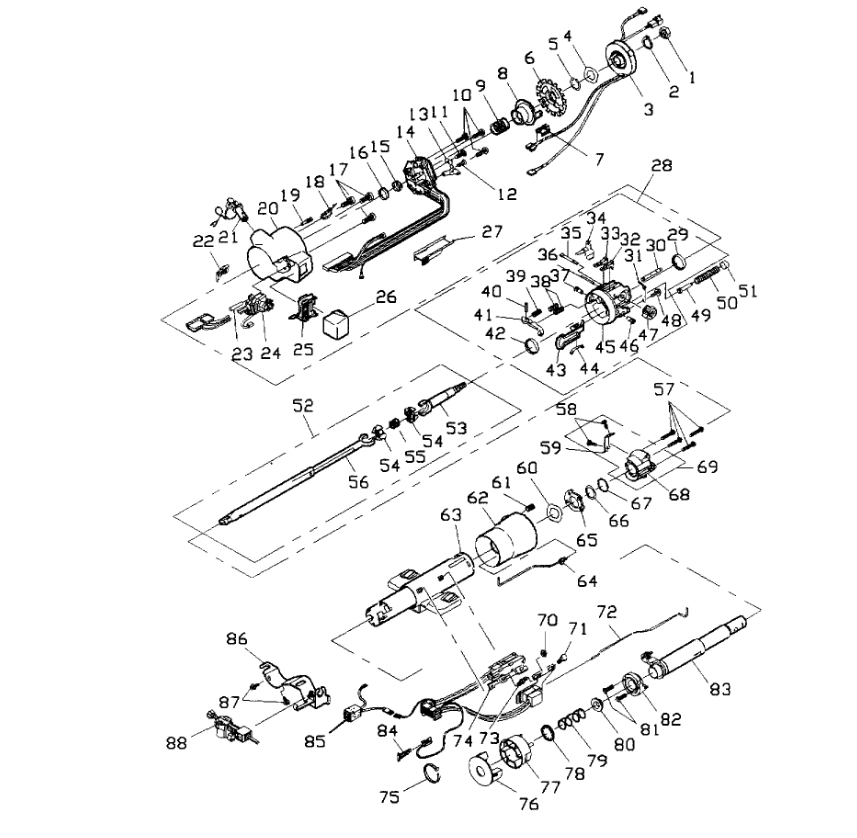

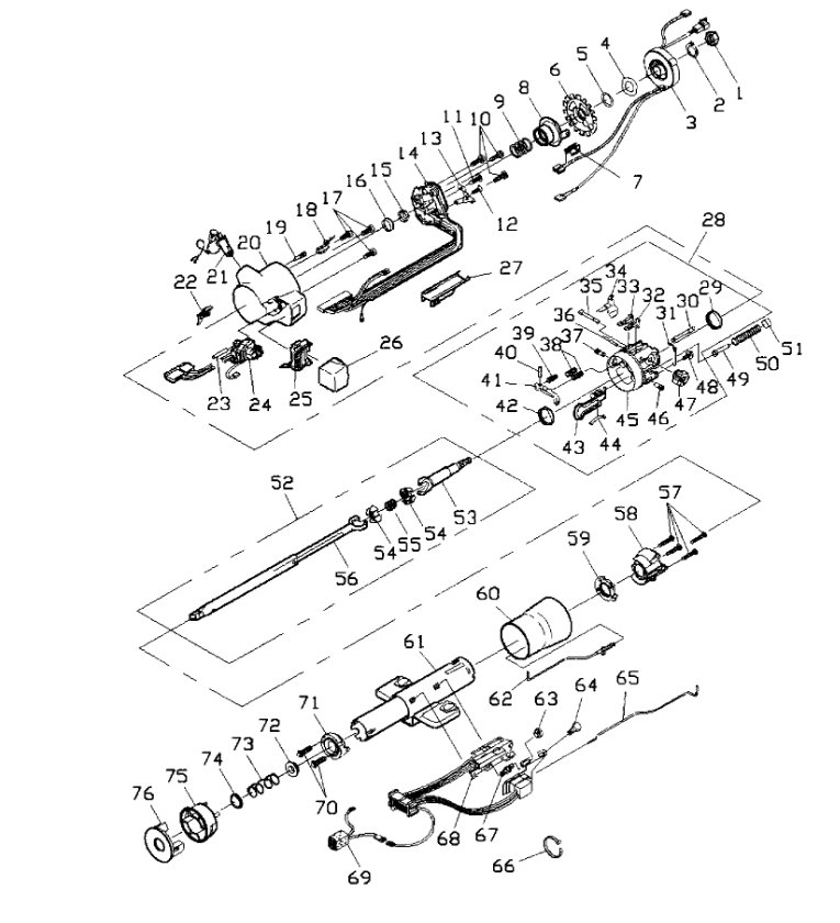

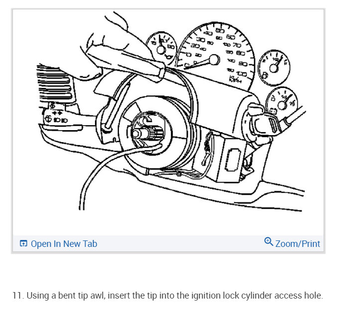

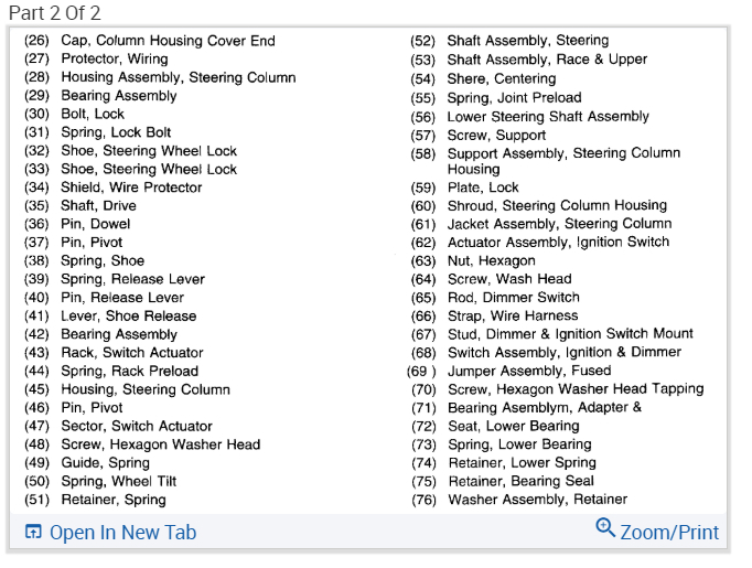

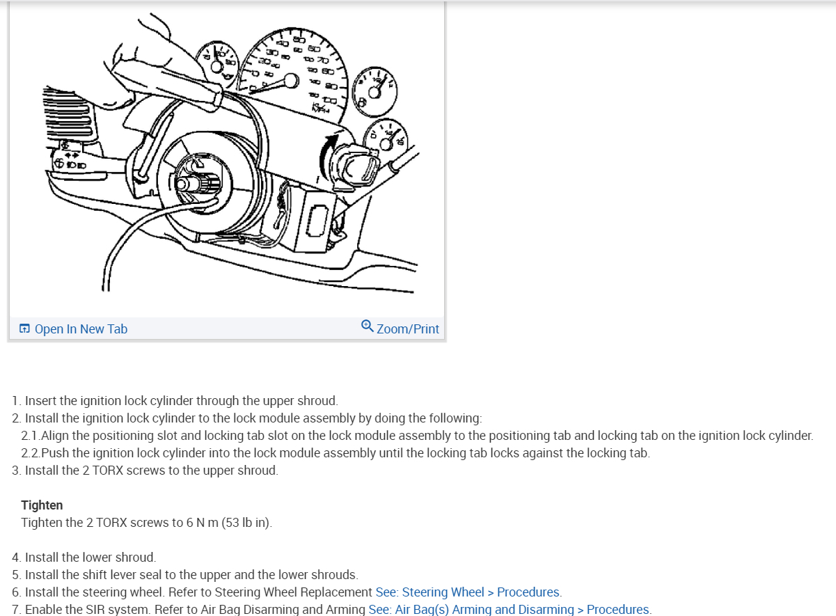

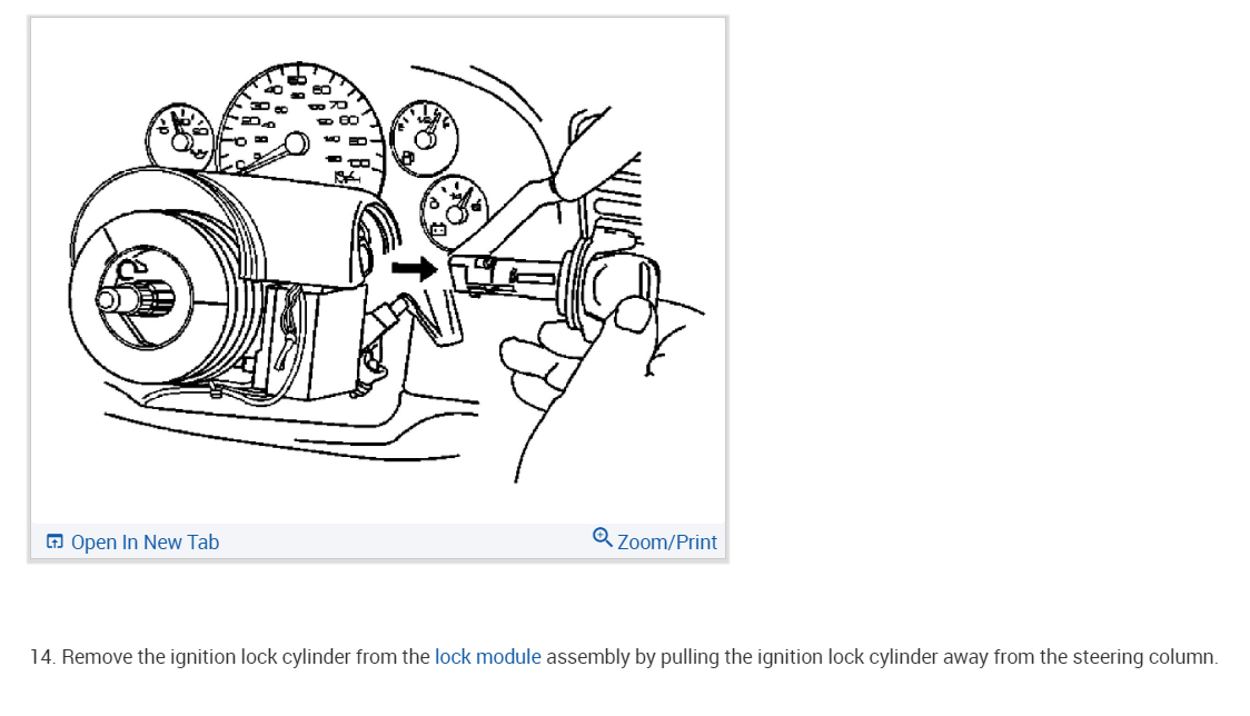

When you reset the system does the security light still flash? If so, the chip has gone bad in the new key which happens. Do you have a spare key you can try? if, not, here is how to change the ignition switch out so you can get another programmed unit. Check out the diagrams (below). Please let us know what you find. We are interested to see what it is.
