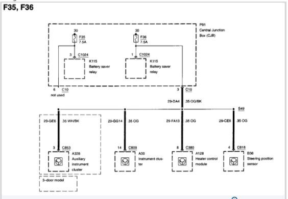

It's fuse 36 central timer/electrical components. That's drawing with the car parked and keys out of ignition. It's brand new and holds charge overnight.
Aug 23, 2020 at 8:04 AM
4DRTOM
  • 467 POSTS
Okay, it's going to be one of the parts of that circuit that draining it. Can you tell whats not working now that fuse is removed? I'll try to see what is in the wiring diagram for that fuse.
Tom
Aug 23, 2020 at 12:05 PM
4DRTOM
  • 467 POSTS
Okay, I uploaded the circuit listed for fuse 36. Looks like a battery saver relay could be your issue oddly enough seeing it's draining the battery. Check it out and check everything on this diagram.
