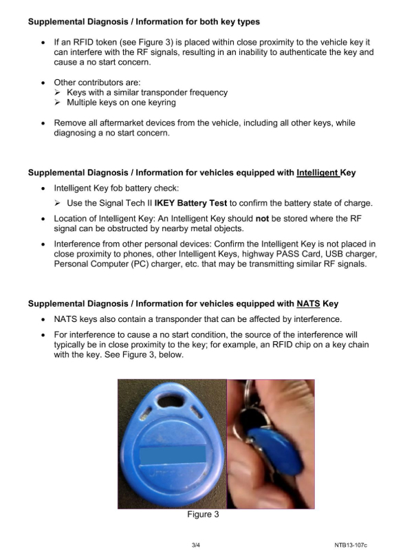

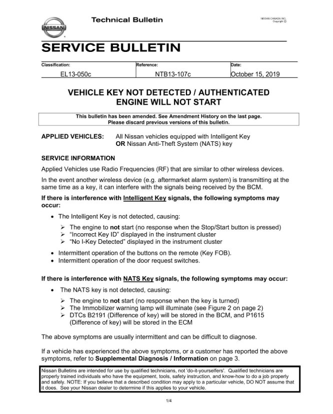

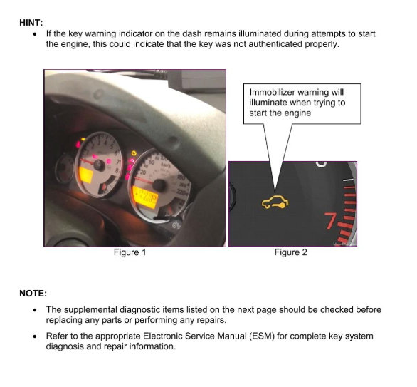

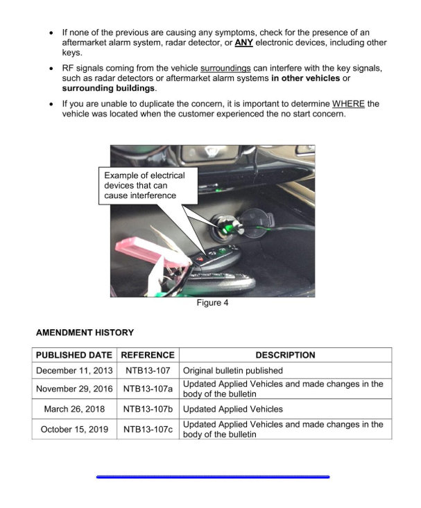

They have a bulletin on this issue. here is the information the dealer gives to fix the problem. Check out the diagrams (below). Please let us know what happens.
