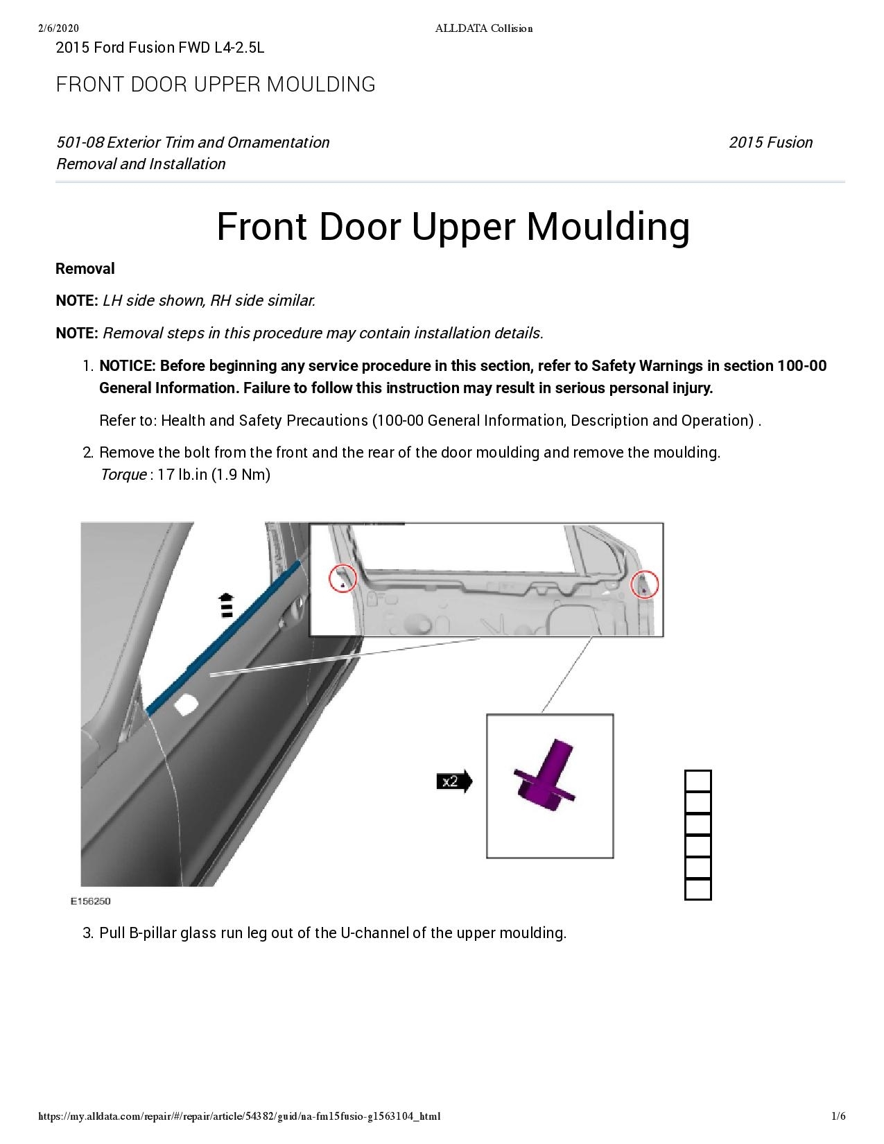

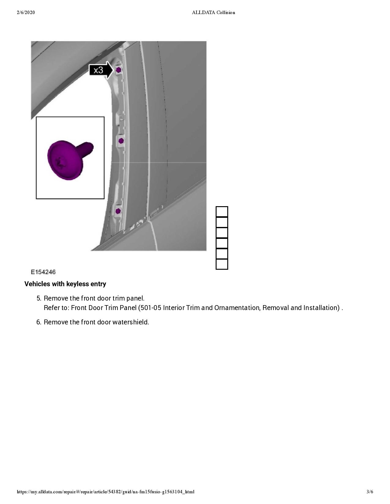

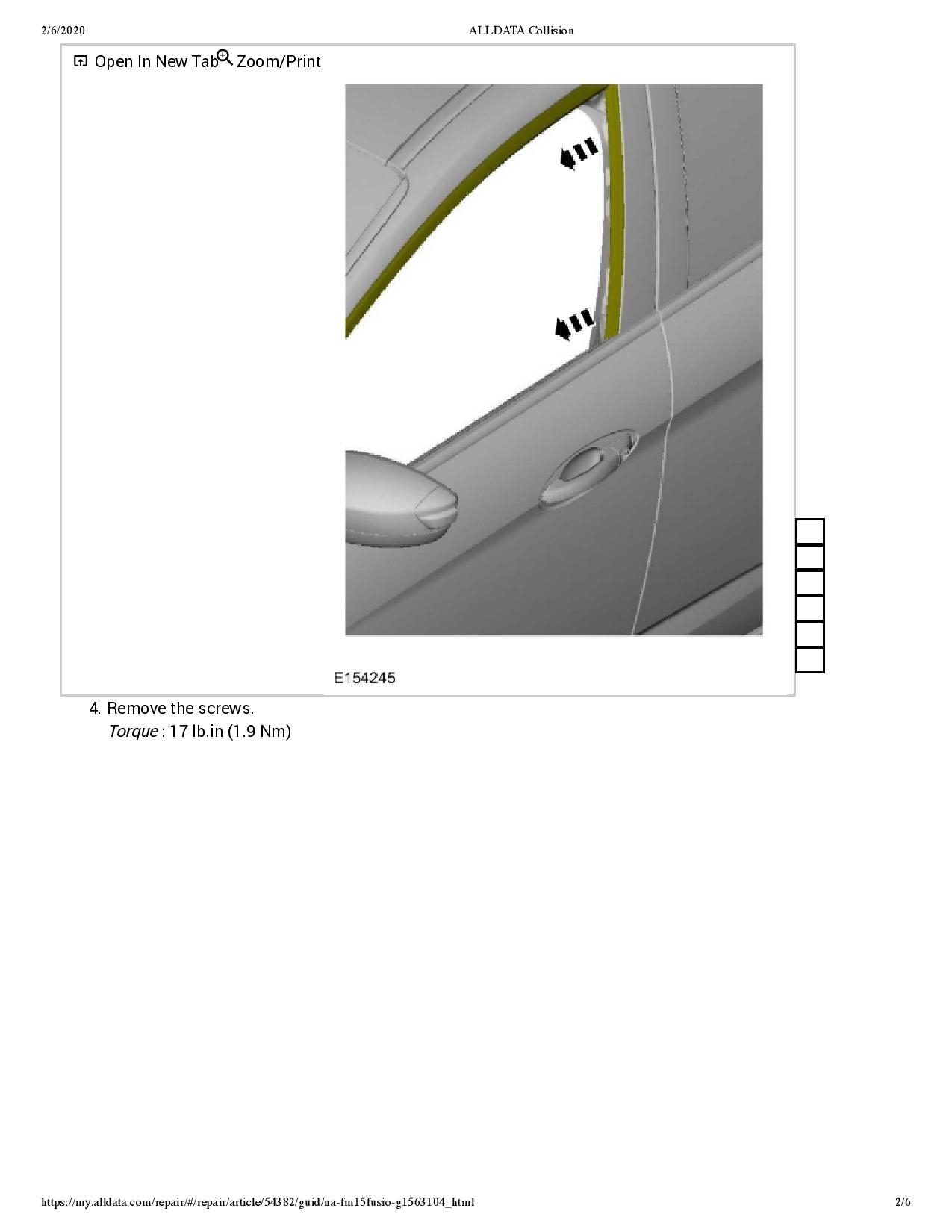

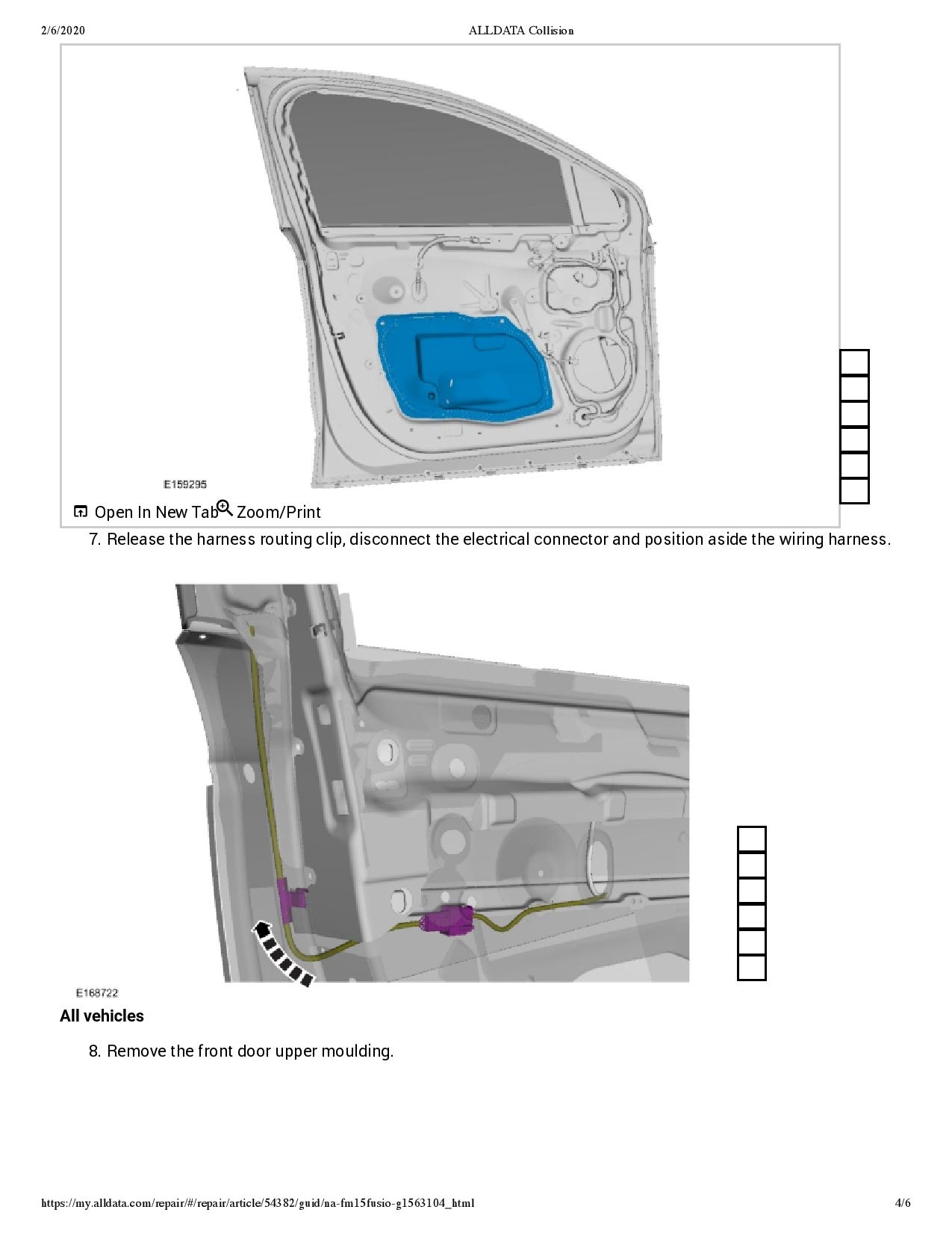

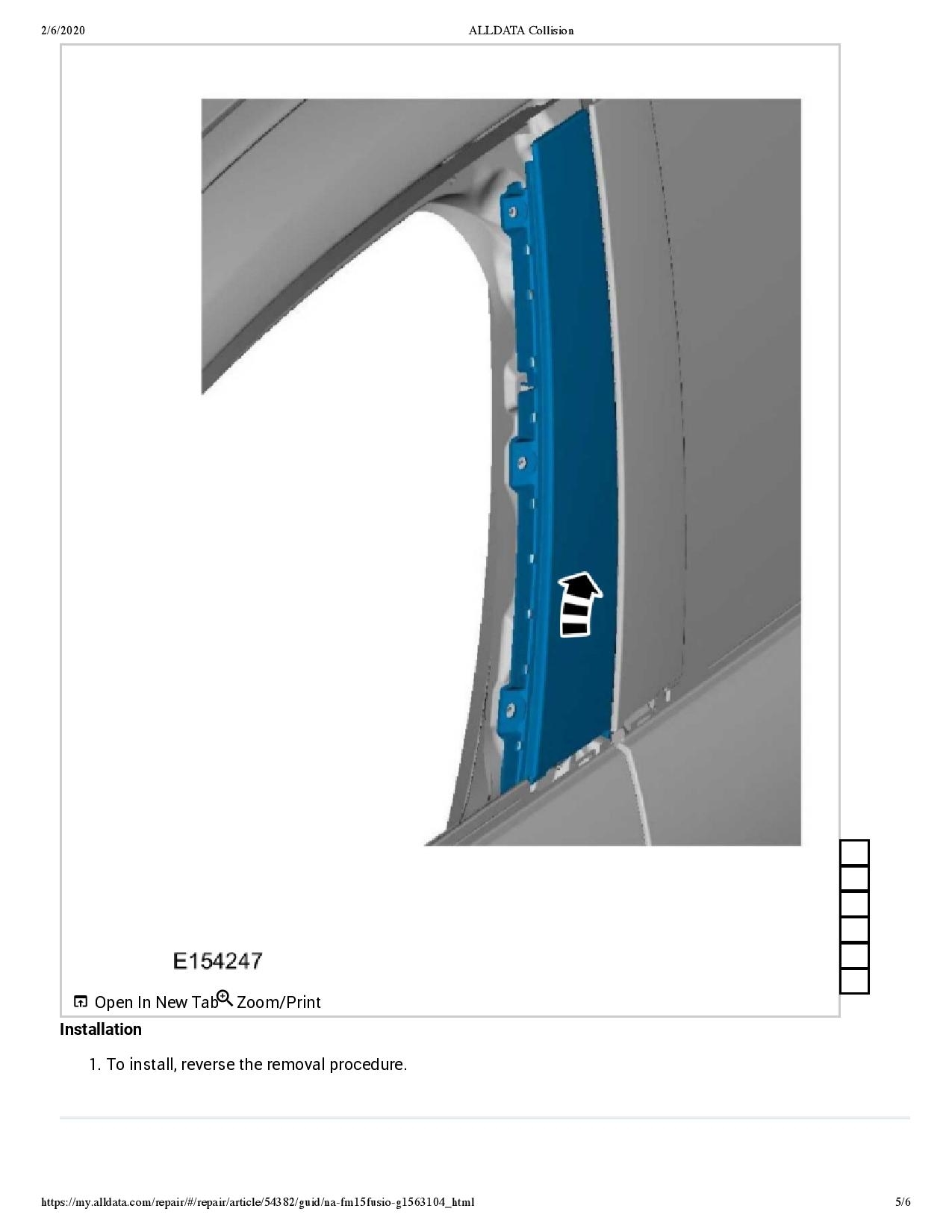

The instructions for replacing the keypad on these vehicles are covered in replacing the upper door molding as the keypad is part of this trim.
I have attached the instructions to this post.
This fault may cause the vehicle battery to go flat if the flashing is constant. If you are happy to lose the function and want to avoid a flat battery one option is to simply unplug the keypad unit.
Hope this helps, let me know if you have any further questions.

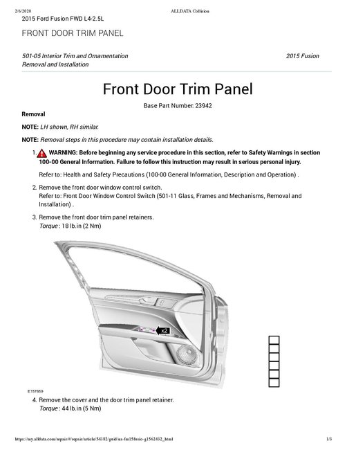

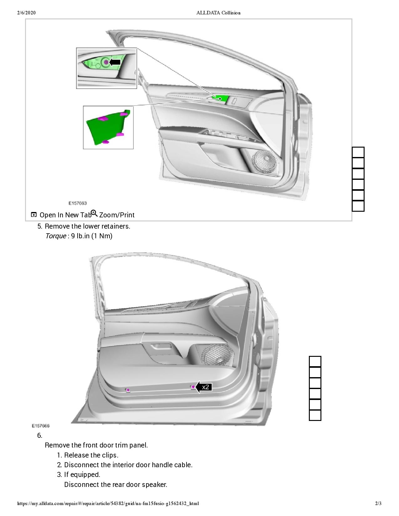

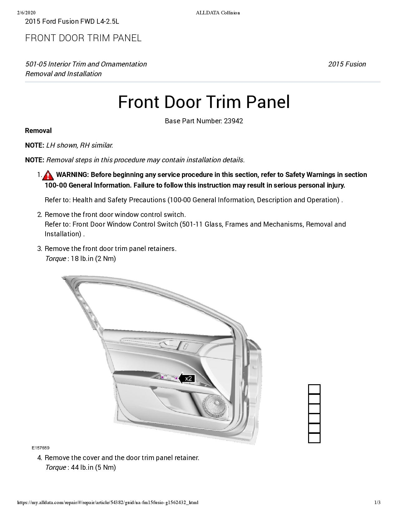

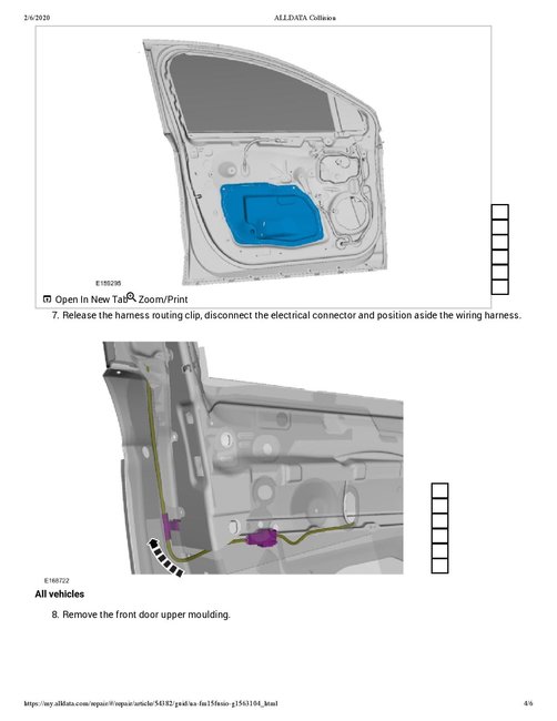

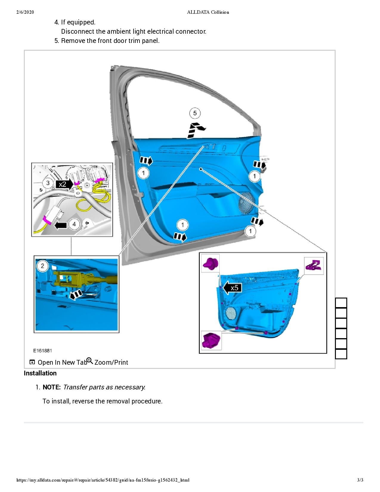

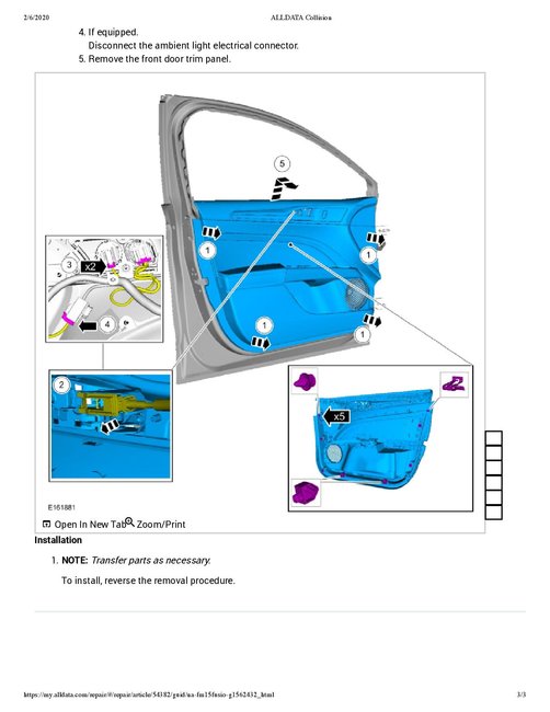

You will need to remove the door panel to disconnect the electrical connection for the key pad, the instructions for removing the door panel are attached below.
Regards, Joe
