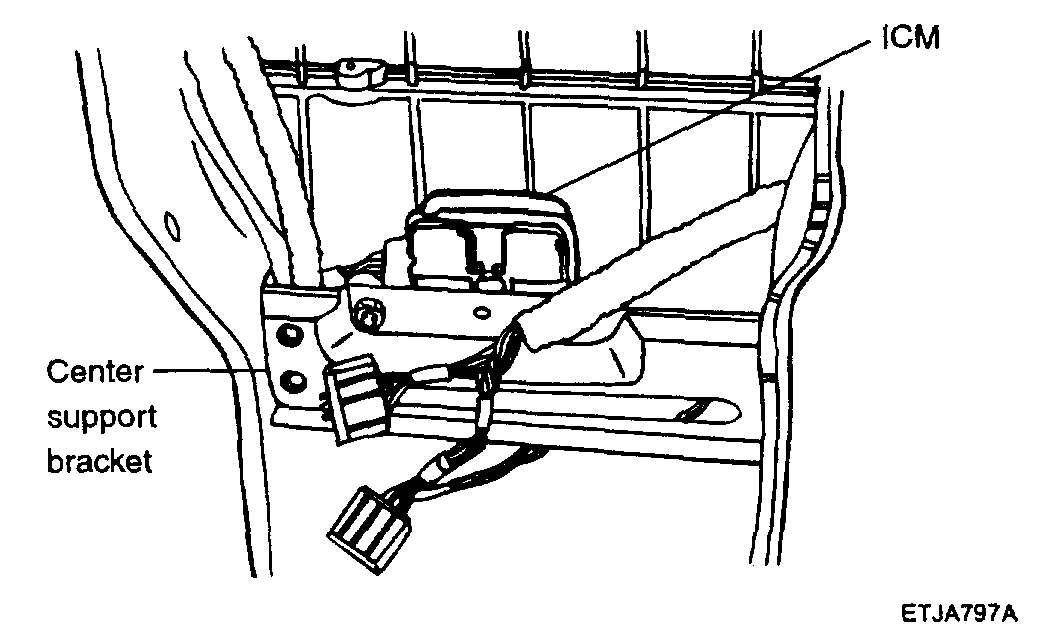

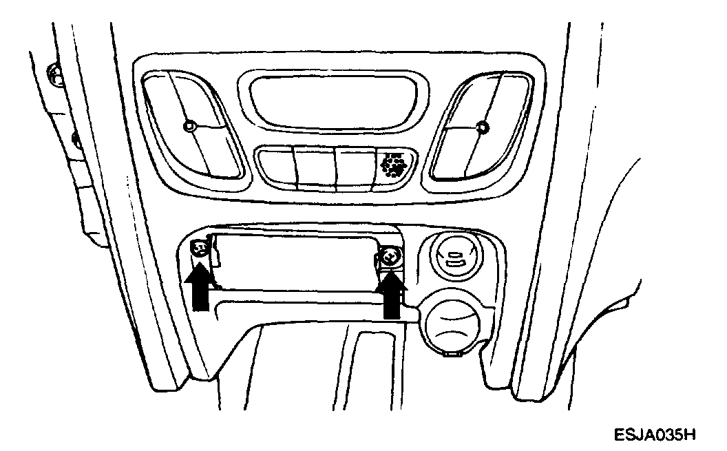

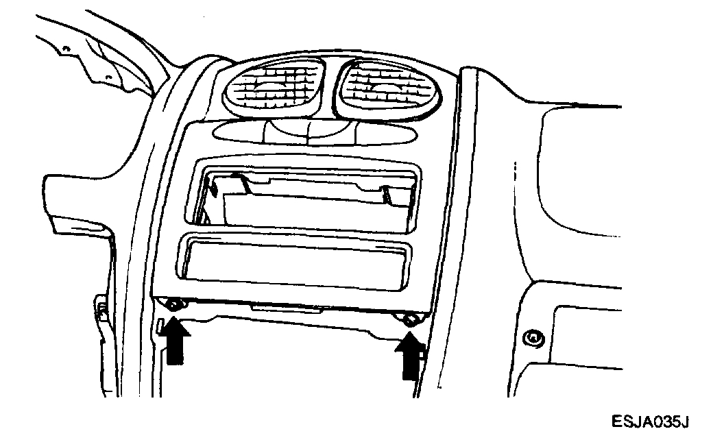

There is no reset on the BCM. Are you referring to the immobilizer control module (ICM)? Here are the directions for removal. However, the reprogramming is done via a scan tool.
The attached pics correlate with the directions.
2004 Hyundai Truck Santa Fe L4-2.4L
ICM (Immobilizer Control Module) Removal
Vehicle Accessories and Optional Equipment Antitheft and Alarm Systems Alarm Module Service and Repair Procedures ICM (Immobilizer Control Module) Removal
ICM (IMMOBILIZER CONTROL MODULE) REMOVAL
REMOVAL
pic 1
pic 2
1. Remove the ash tray and then remove the 4 screws holding the center fascia panel.
2. Remove the center fascia panel and disconnect the connectors.
pic 3
3. Remove the immobilizer control module from the center support bracket.
Let me know if that is what you needed.
