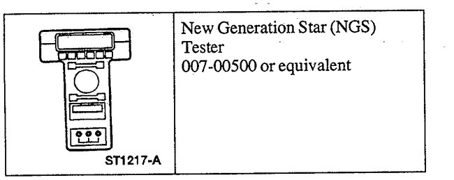

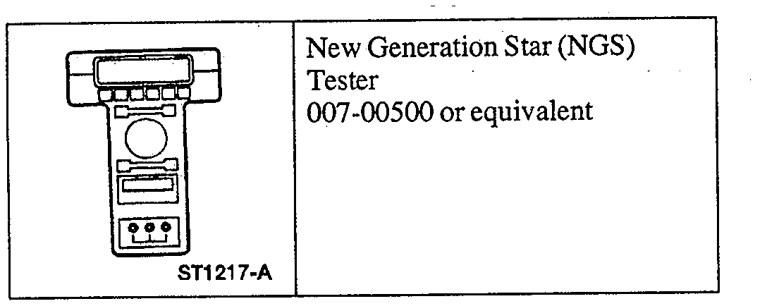

KEY PROGRAMMING - ERASE ALL KEY CODES AND PROGRAM TWO KEYS
Special Tool: New Generation Star (NGS) Tester
Picture 1
SPECIAL SERVICE TOOLS
