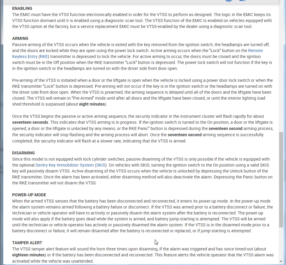

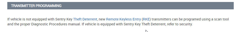

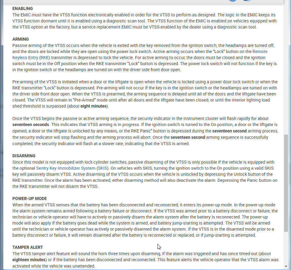

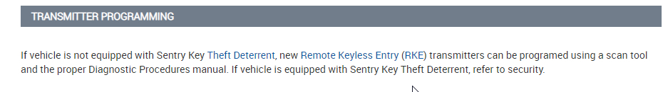

I attached the info about this system below so you can read about it. If you are not sure, just send me the last 8 of your VIN and I can look it up and tell you how it is equipped.
If the lock smith deprogramed it then I would be calling them back and ask they fix that as the remote would shut this off.
Another option is to purchase a PCM that has this system deleted. However, this may be about the same price as having the dealer program a new transmitter to the vehicle but it may be worth calling around to check prices. Also, this is no longer a dealer only process. Most repair shops that are normally cheaper then the dealer can access the security module with their tools to program a new transmitter. Just another option for you.
