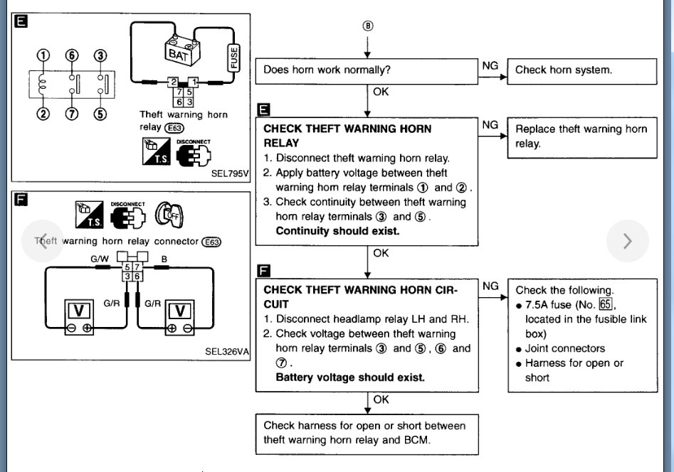

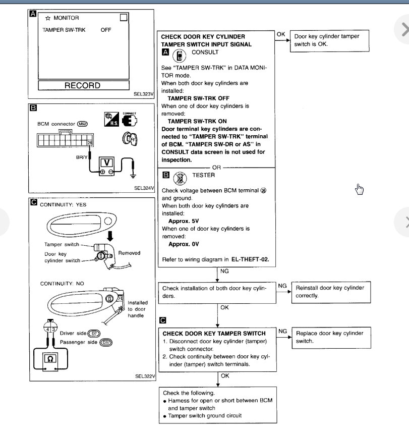

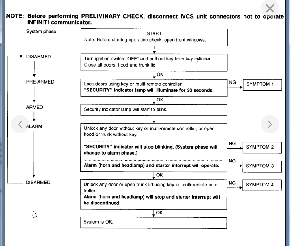

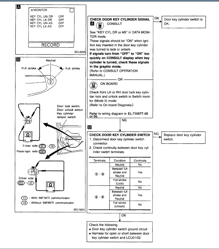

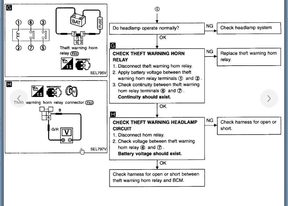

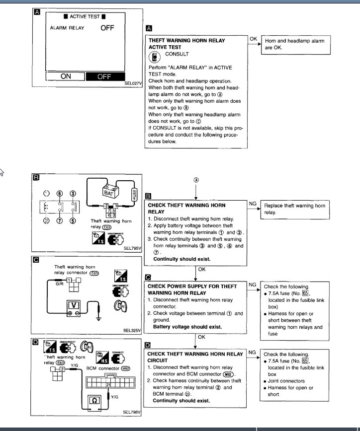

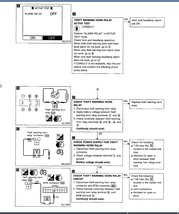

Out if the blue security light stays on in the run position. No injector pulse will spin over but no crank.
Jun 17, 2020 at 3:28 AM
CERTIFIED EXPERT
18,907 POSTS

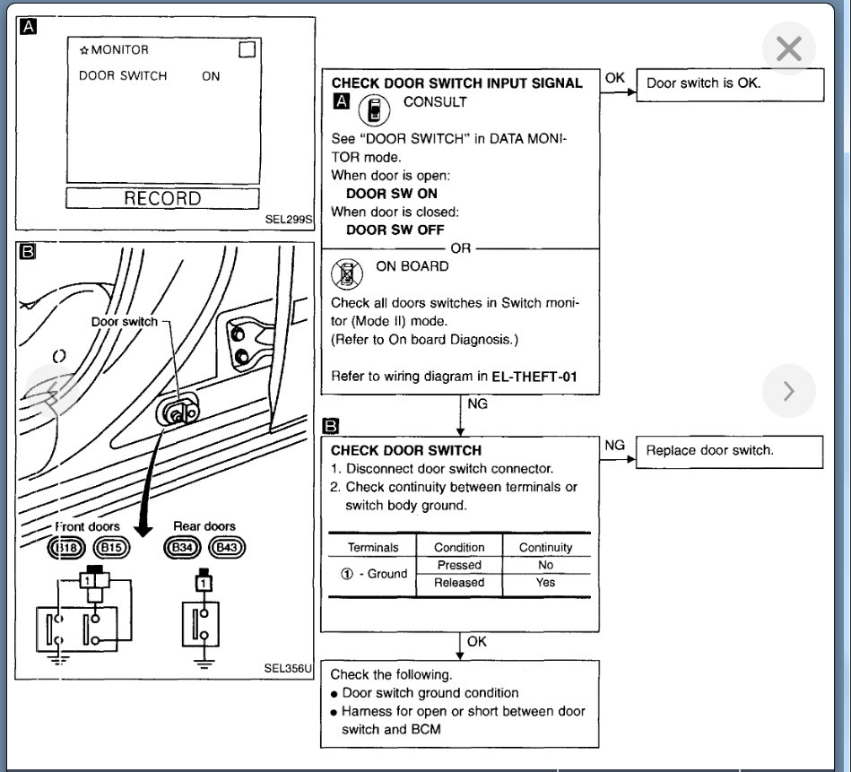

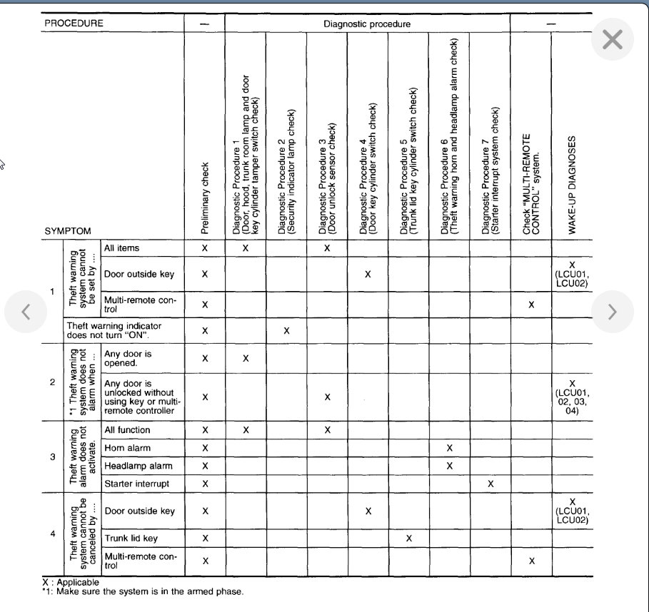

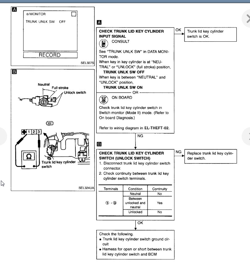

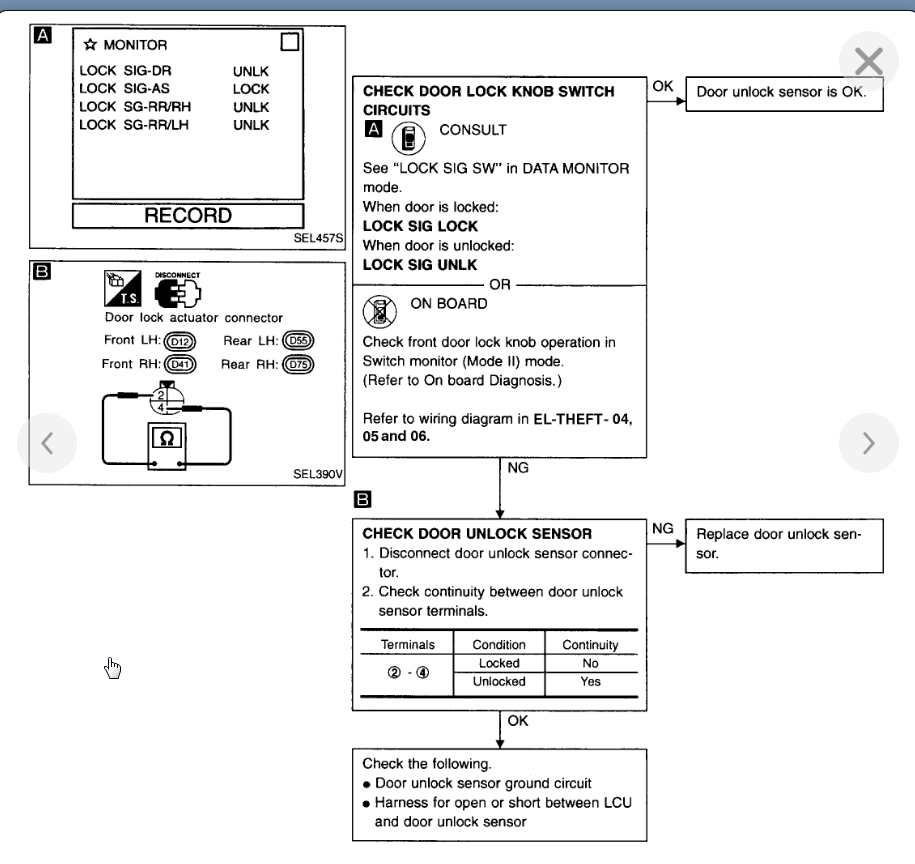

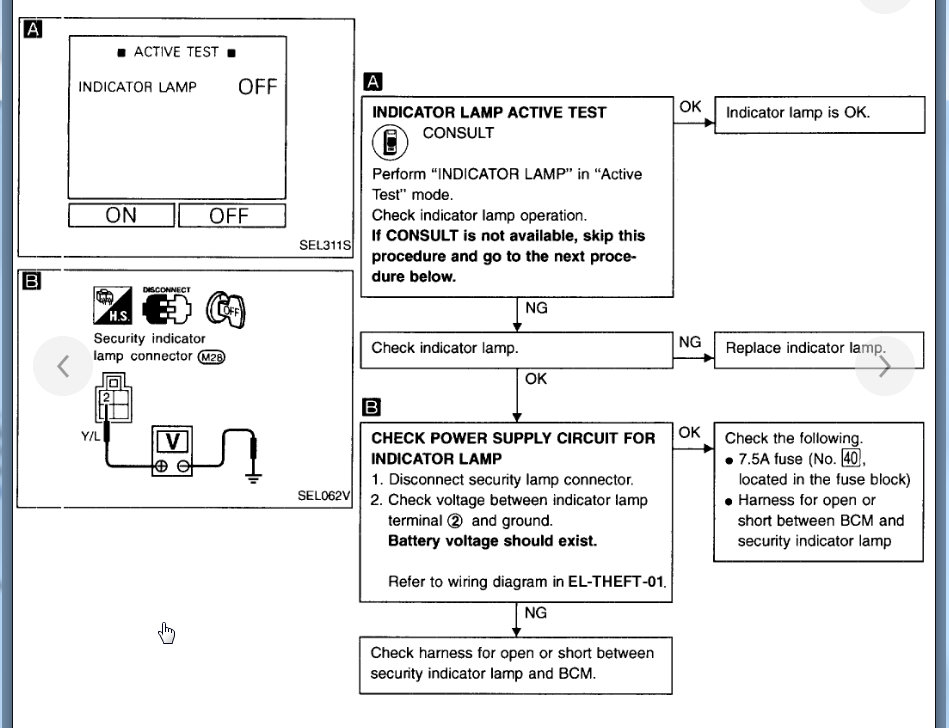

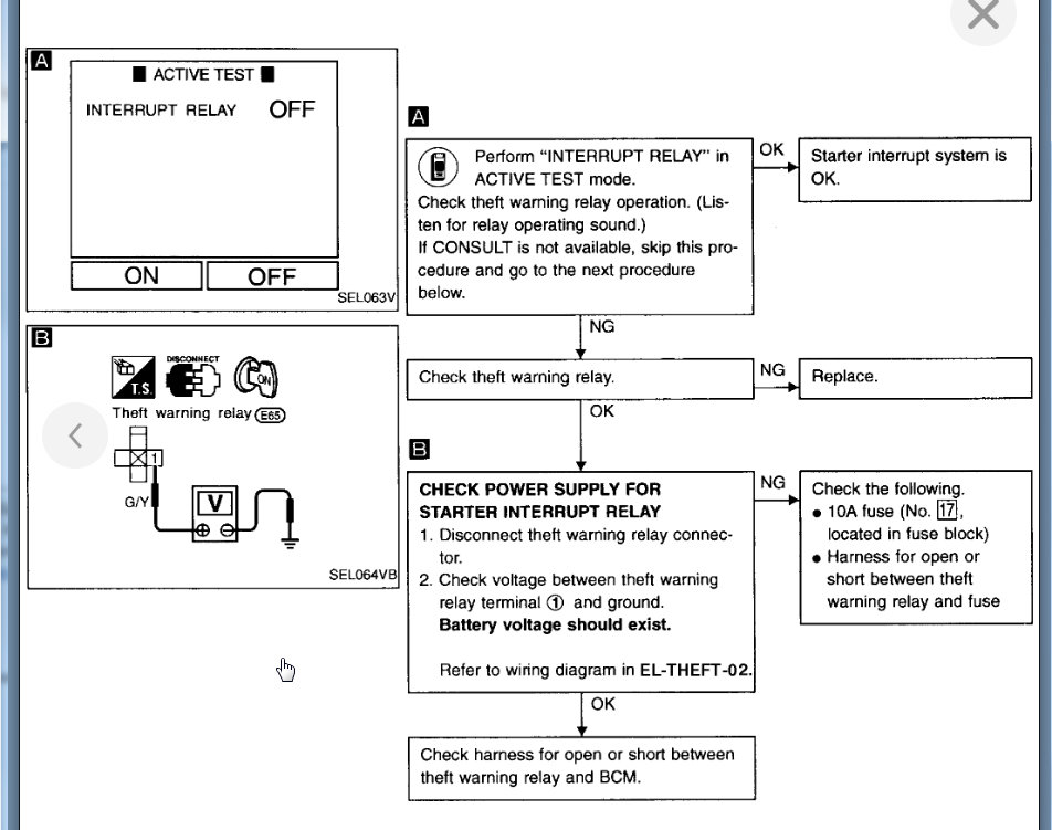

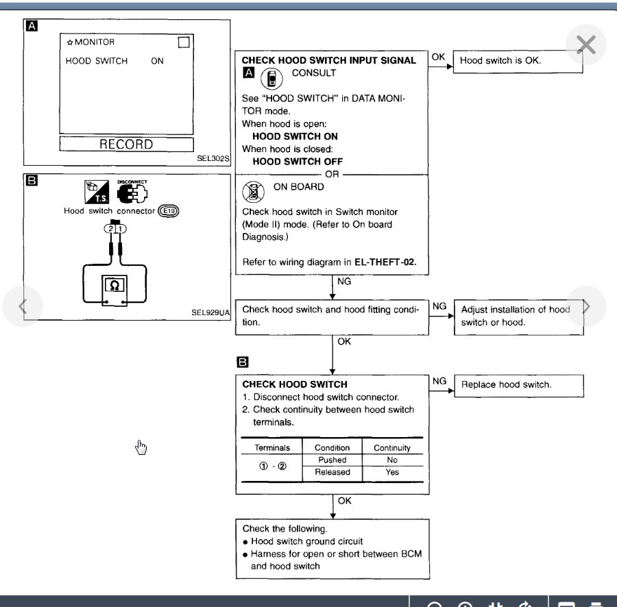

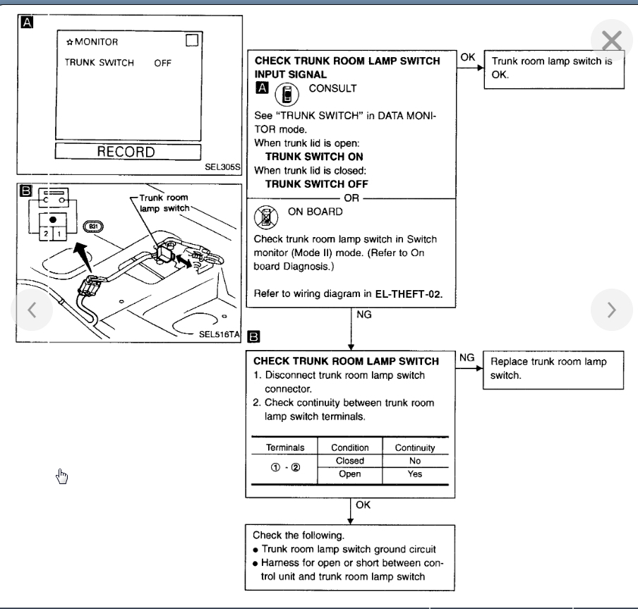

This could be a number of different reasons. The unfortunate thing is we don't know until we run through some testing.
I attached the info from the service manual. Let us know what you find and we can go from there. Thanks
https://www.2carpros.com/articles/how-to-reset-a-security-system
